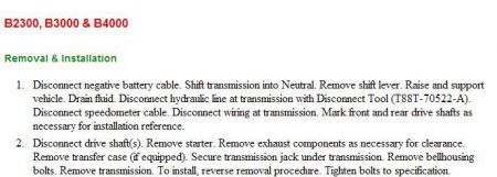

how to remove the upper bolts of the transmission case ,they are unreachable
Jan 8, 2010 at 11:13 PM
BLUELIGHTNIN6
  • 16,542 POSTS
To get at the top 2 bell housing bolts you may need to put a jack under the transmission at the rear, remove the cross member and lower it until you can see them. Easier to use a long extension than to try to get you hands in there
https://images.2carpros.com/forum/automotive_pictures/261618_Noname_1507.jpg
