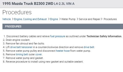

Have removed all of the bolts, but something is still holding it on
Jan 18, 2010 at 11:34 PM
BLUELIGHTNIN6
  • 16,542 POSTS
The manual doesn't show any diagrams, but nothing in the instructions warn of hidden bolts. Have you tried tapping on it lightly with a hammer to see if it breaks free?
See instructions from manual below
