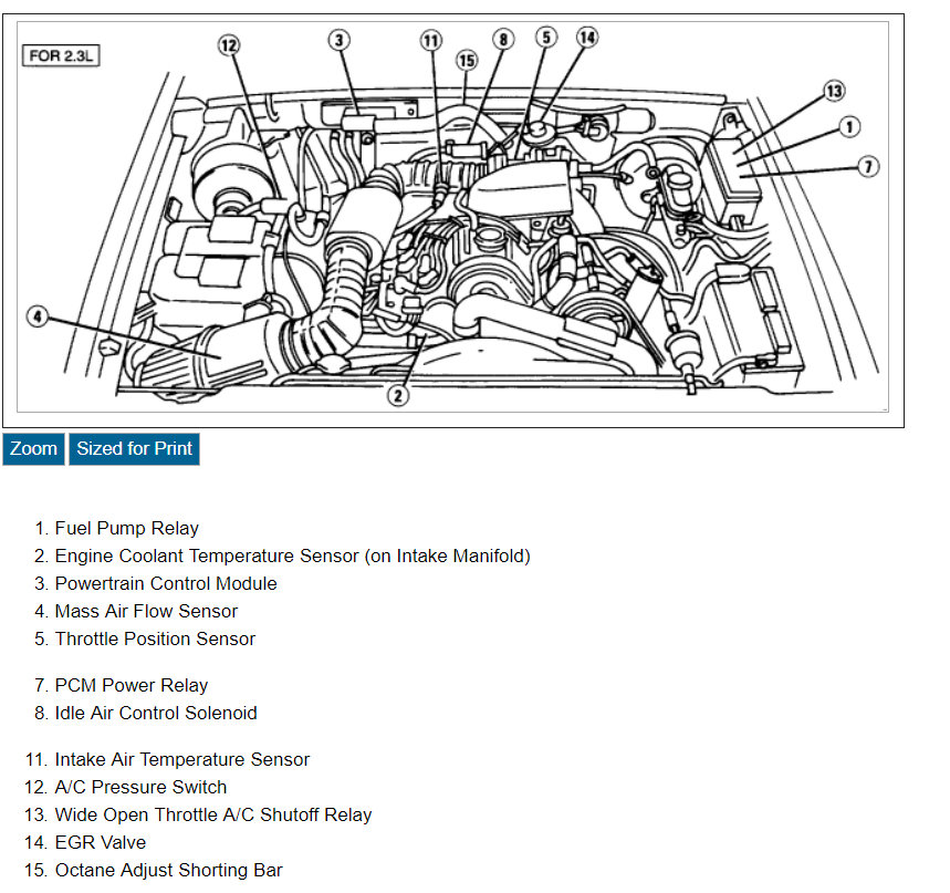

coolant sensor
1997 MAZDA B2300
200,000 MILES
RICK KOEPP
where is it located?
Mar 20, 2017 at 6:41 AM
HMAC300
  • 48,601 POSTS
Here is a coolant sensor replacement guide and a diagram below that will help you see where is it.
https://www.2carpros.com/articles/coolant-temperature-sensor-cts-replacement
Cheers
