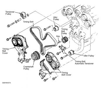

how do I replace the water pump and timing belt?
Apr 30, 2008 at 6:54 PM
BMRFIXIT
  • 19,053 POSTS

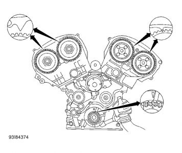

1. Disconnect negative battery cable 2. drain engine coolant 3. remove coolant fan and shroud 4. remove drive belts 5. remove idler pulley for Ac and P/S if equipped 6. remove crankshaft pulley 7. remove coolant hoses and by -pass hose 8. remove distributor 9. remove timing belt cover 10. turn crankshaft to align pulley 11. remove timing belt remove water pump

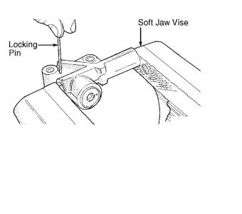

do I need to buy a timing belt tensioner? what other special tools do I need, Please send more info
May 1, 2008 at 1:35 AM
BMRFIXIT
  • 19,053 POSTS
Check automatic tensioner rod projection
rod should project .47 -.55 " (12-14MM) from tensioner body
if not within specification replace tensioner
