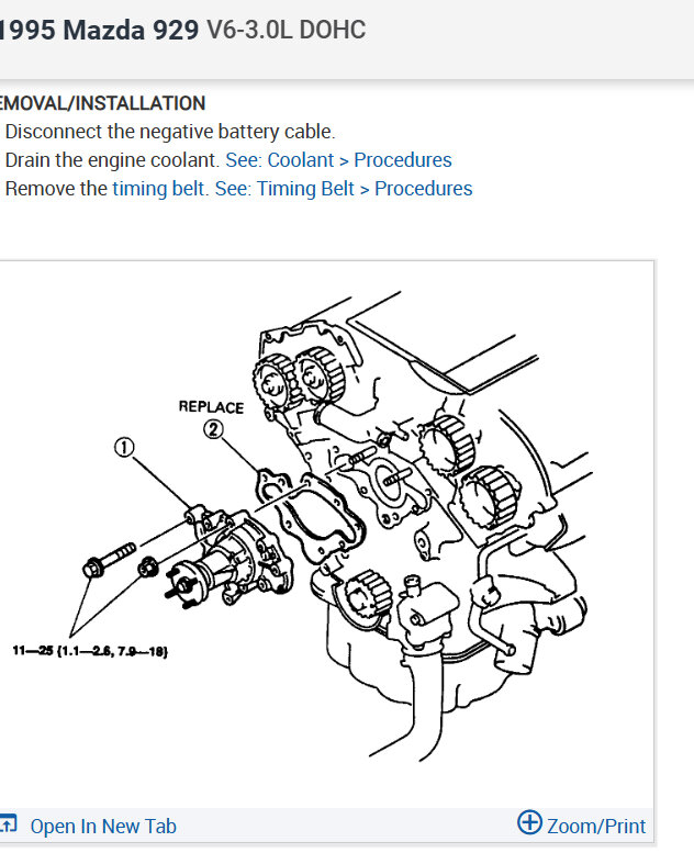

Where is the water pump located and how to I replace it?

pump is located in the serpentine belt assembly, you will see hoses going into it
Dec 15, 2007 at 12:04 PM
  • 55,691 POSTS

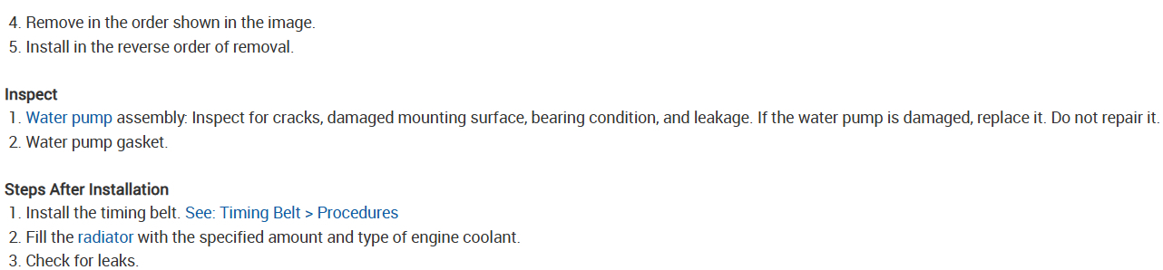

The water pump is behind the timing belt cover and you will need to remove the timing belt as well so you might as well replace it. Check out the images (below). Let us know if you need anything else.
