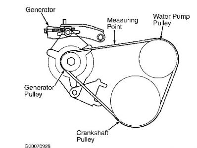

We just bought a 99 mazda 626 and soon found out that when we start it up there is an obnoxiously loud squeak that happens. It will go away after a couple minutes but sometimes will squeak again at every stop. We were told the squeak may be due to our belts and have already tried to use the belt dressing with no luck. Very annoying and I think the neighbors are going to shoot me if i keep waking them up so early ;) Please help.

You need to verify the squeal.
Use a long handled screwdriver or similiar to use as a stethescope. The tip get placed on the item's body that you'll be listening to and the other end is placed on you ear. Listen to each component the the drive belt attached to and you'll probably be able to narrow down the source as the nosie will be loudest at that failing item.
It is also possible that there is weak tension being put on the belt.

https://images.2carpros.com/forum/automotive_pictures/30961_alt_2.jpg

To the previous posts.. it isnt the alternator..
Sounds like your drve belt is loose..
Go to any garage and they will tighten it for you in 20-30 mins.. and then you will stop waking up your neighbour.. lol

Well it was a belt (not sure which one). It was torn up and had to be replaced.
As for the alternator, the friend who took a look at it said it may not have too much longer to live.
So perhaps you both were right. Thanks!!
