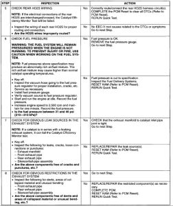

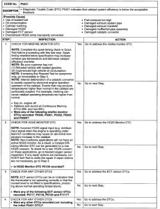

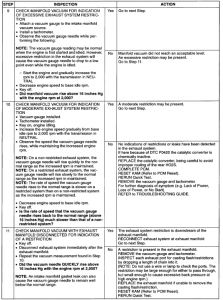

I have a 1997 mazda 626 mileage is 97k,i'ts giving me a code 421.ive taken it to 2 mechanics and they have replaced the catalyts converter but it didnt solve the problem.is there a tempature sensor in the exhaust system that i should look at.

Which cat did they replace?? The one under the car in the center???
