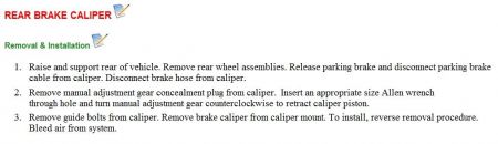

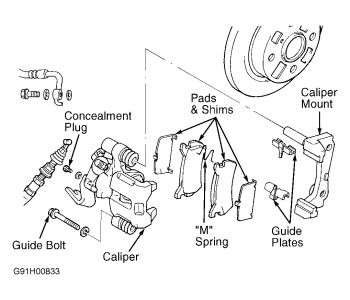

Can you help me out, I done a lot brake jobs but on this vehicle is hard to get the caliper out, there is a bolt and a pin but I can't get the caliper out from that pin!!! I need help please!!!!
