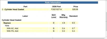

What kind of price range am I looking at if it is a blown head gasket on this mazda 626 to get it fixed?
Tuesday, September 21st, 2010 AT 3:13 PM
  • 75,992 POSTS
Labor rate per hr range from $70-$130.00 and varies with location
https://www.2carpros.com/forum/automotive_pictures/12900_gasket_1.jpg
