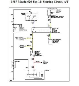

My car starts fine in the morning when the car has been sitting for at least 2 hours off but as soon as I drive the car and it is running for at least 30 minutes I can't start the car. there's no sign that the starter turns when I turn the key nothing happens. I've replaced the starter, the alternator, the thermostat, the battery but nothing seems to be working. What else can I check?

Hi there, Start with the transmission isolator switch and work through the system with the help of this circuit diagram. Mark (mhpautos)
