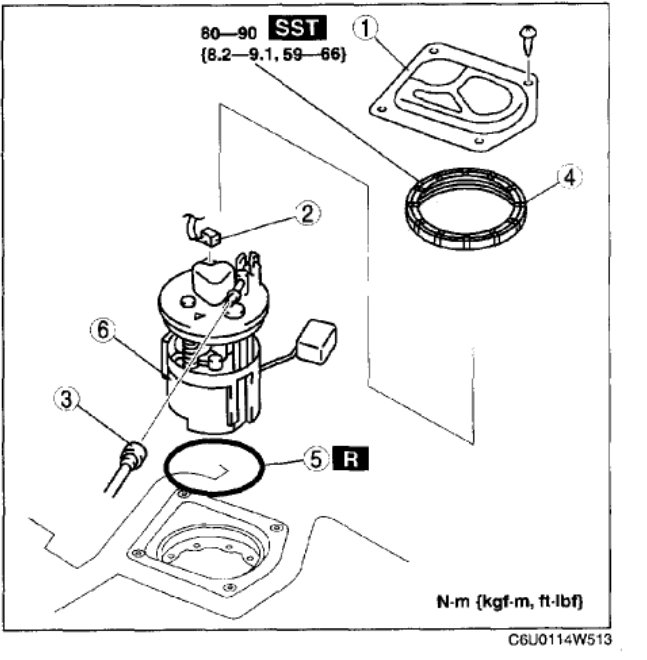

Engine Mechanical problem 4 cyl Two Wheel Drive Automatic 105998 miles
the car is missing and sometimes you can press the gas pedal down and the car will hardley go. put some stp fuel cleaner and injection cleaner in the gas tank and it seems to have helped. leading me to beleive thats its either the fuel filter or the fuel pump. would like to know where the fuel filter and fuel pump are located on the Mazda 6.
Oct 26, 2010 at 7:19 PM
  • 54,834 POSTS

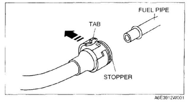

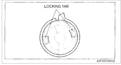

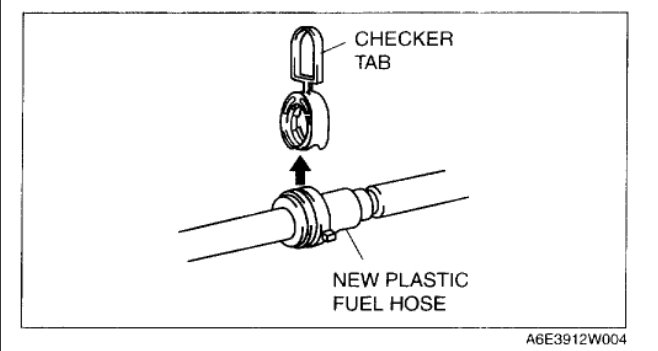

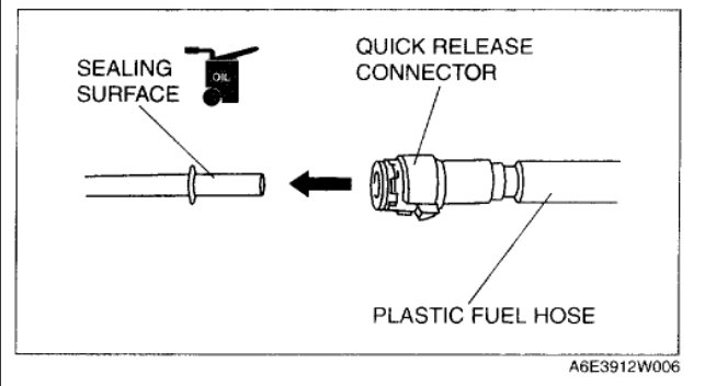

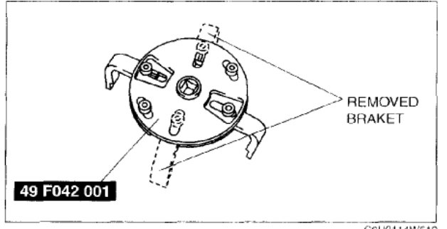

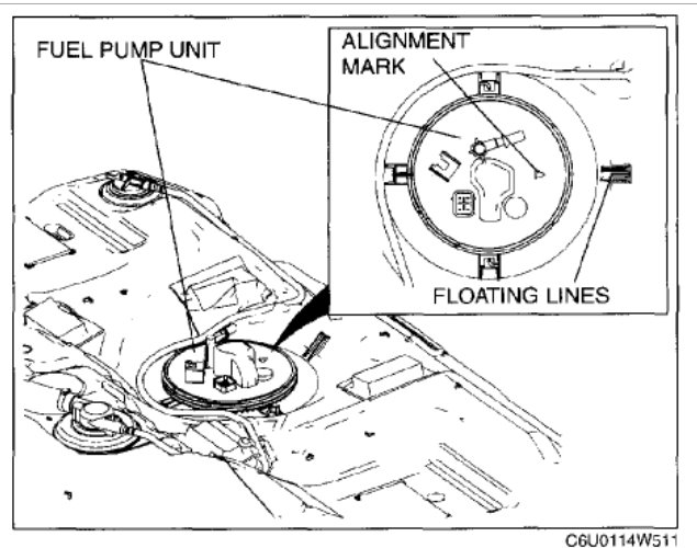

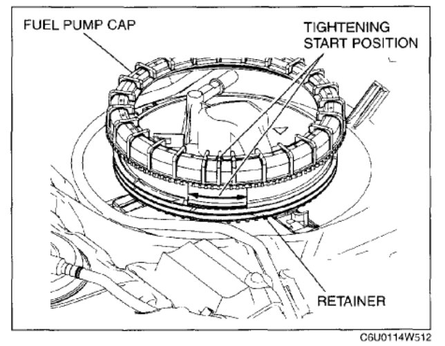

The fuel filter is located inside the fuel tank and the bottom of the tank and is what they call a lifetime filter so you will need to remove the fuel pump to get at it. Some cars have a tap door which you can get to it from which it looks like your car has. Here is a guide to give you an idea of what you are in for when changing the fuel pump out.
https://www.2carpros.com/articles/how-to-replace-an-electric-fuel-pump
This guide can help you as well
The engine could just need plugs
https://www.2carpros.com/articles/how-to-change-spark-plugs
Here and the fuel pump removal diagrams (Below)

Can you tell me where the fuel filter is located on my 2005 Mazda 6?
Nov 11, 2017 at 5:50 PM (Merged)
BLUELIGHTNIN6
  • 16,542 POSTS
The fuel filter is part of the pump assembly. Once the fuel pump is removed, remove the filter retainer and filter.
