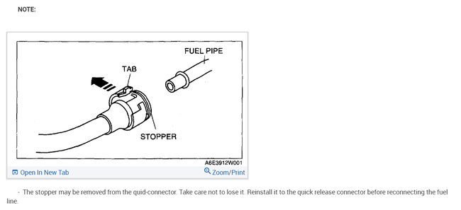

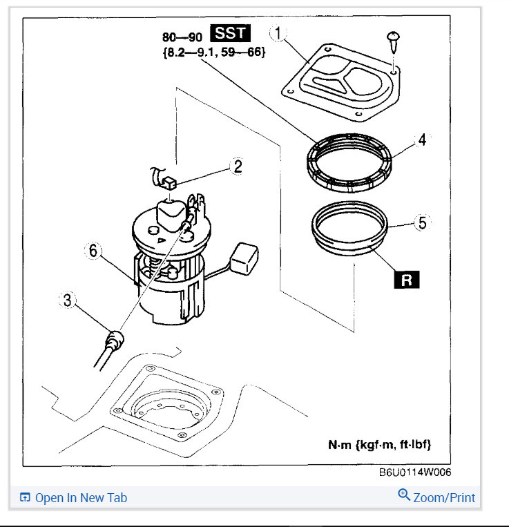

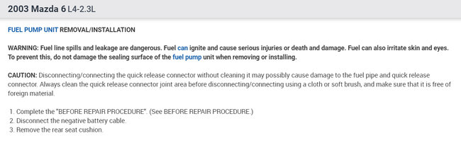

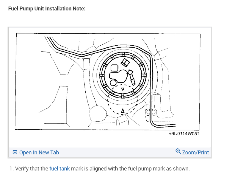

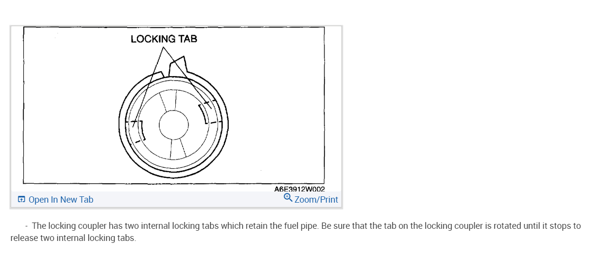

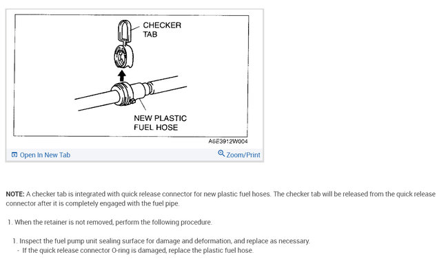

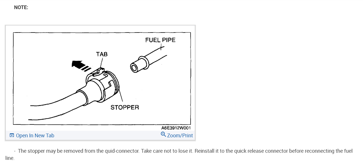

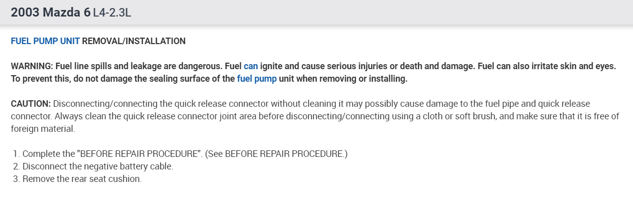

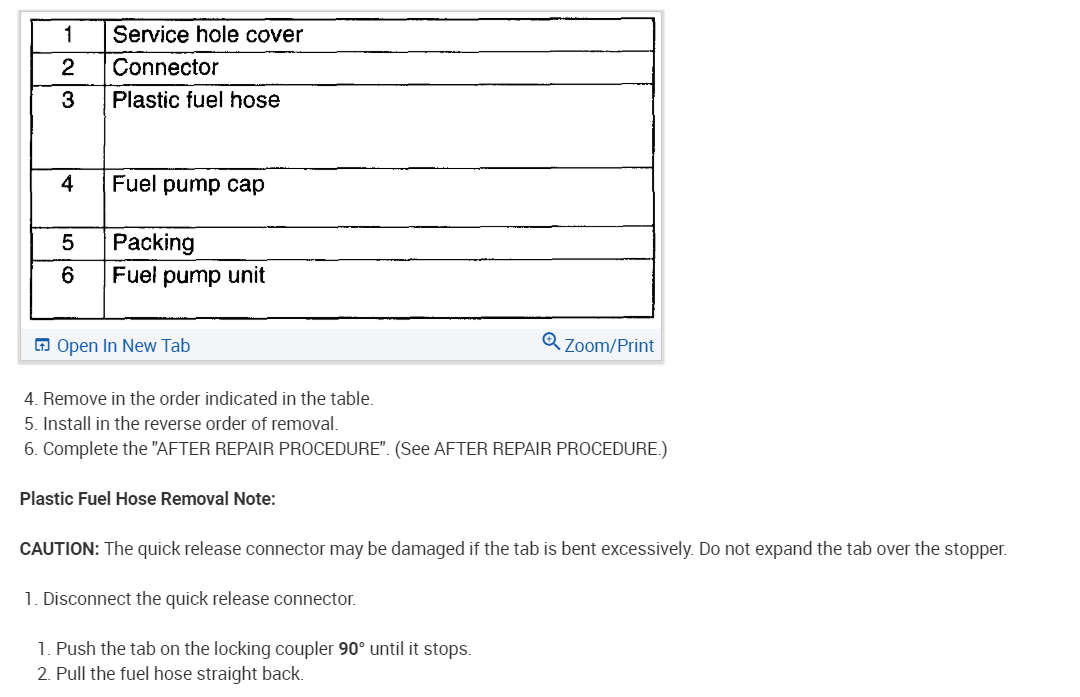

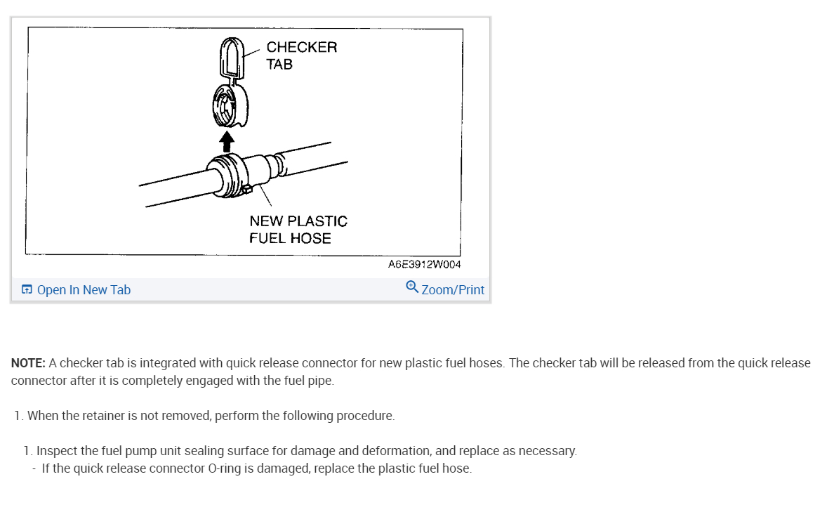

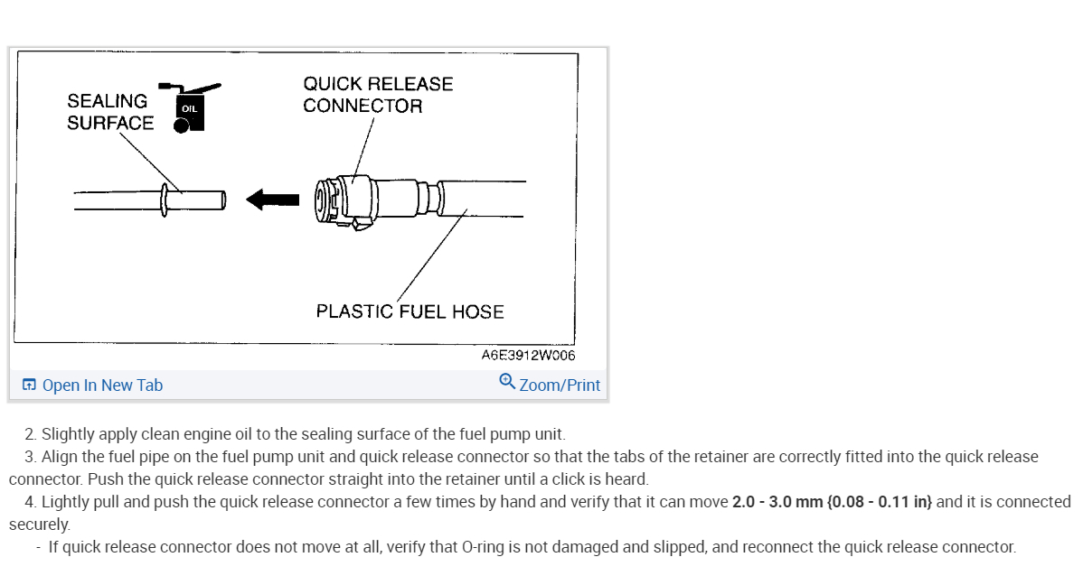

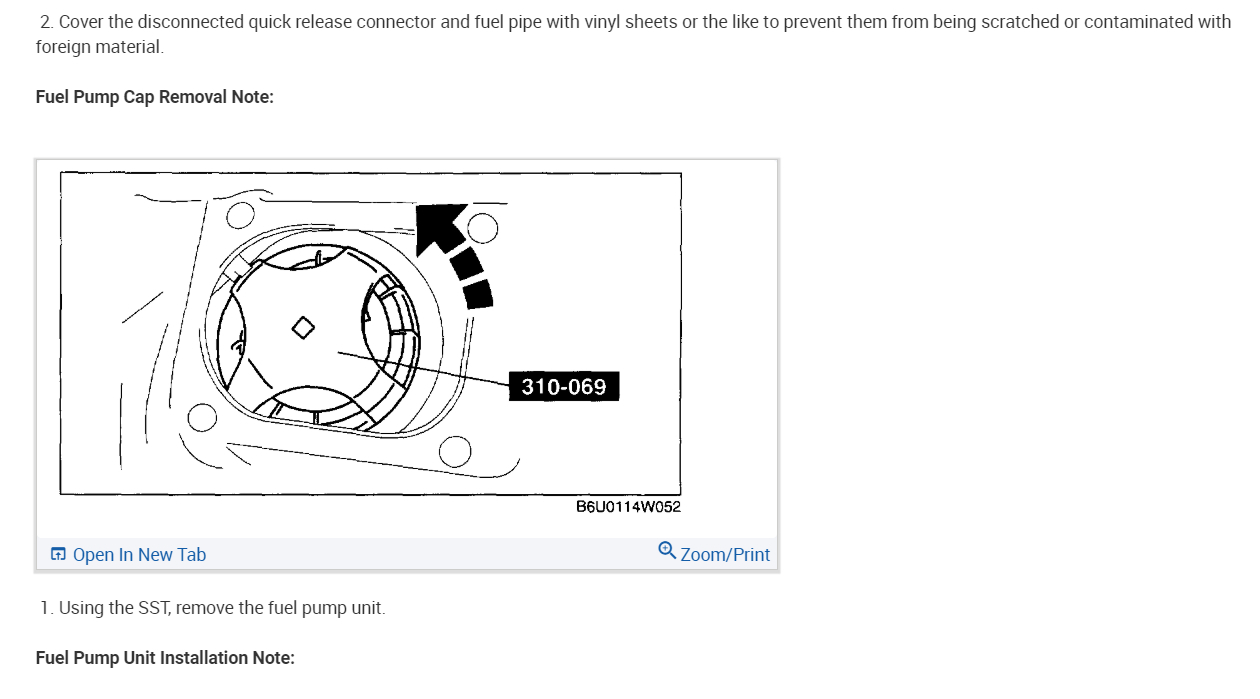

There is no way to replace filter separately but it is easy to replace the pump because you have a trap door. Here is a guide to help walk you through the job with instruction in the diagrams below to show you how on your car.
