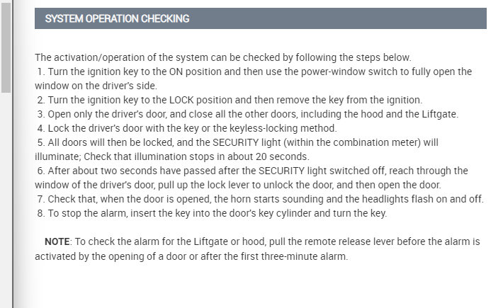

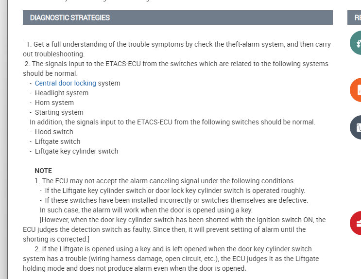

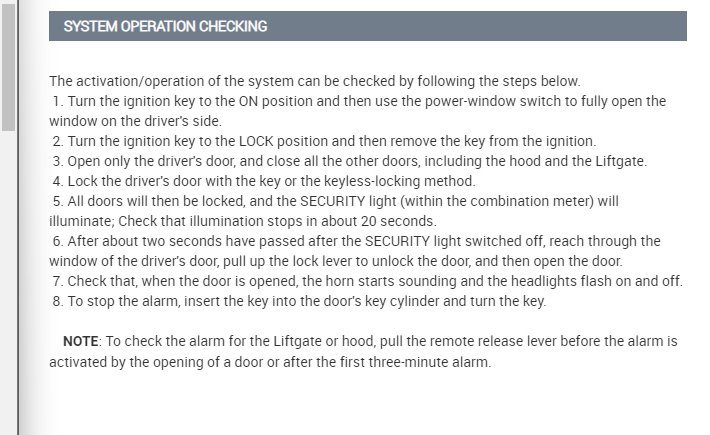

So, if the engine starts and stalls then we need to make sure the theft light is not remaining on.
I would suggest we start with checking the vehicle for codes and find out if there are any that will point us in the right direction.
Also, I am attaching the info below from the manual that will talk about this.
Let's make sure the light is out and we can go from there.

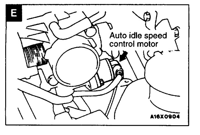

You could have shorted out the IAC. To be sure let's run the codes to see what comes up, here is a guide to help:
In case this is the problem here is how to change out the IAC motor. Check out the diagrams (below). Let us know what happens and please upload pictures or videos of the problem.
