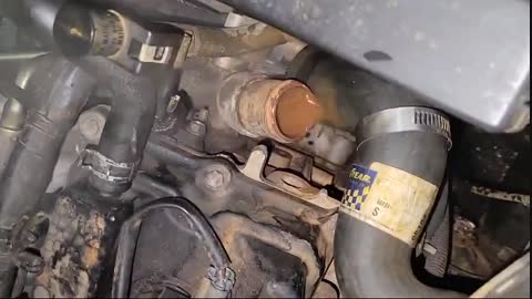

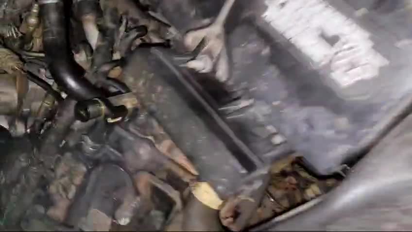

11. Even when the coolant level is full, I don't see a lot of coolant entering the radiator at lower rpms and it does increase at higher RPMs but I suspect the flow is still quite poor. I have attached a video of the coolant flow (after removing the coolant pipe at top of radiator). The engine was initially at 800 rpm and later at 5000 rpm.

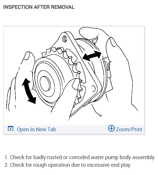

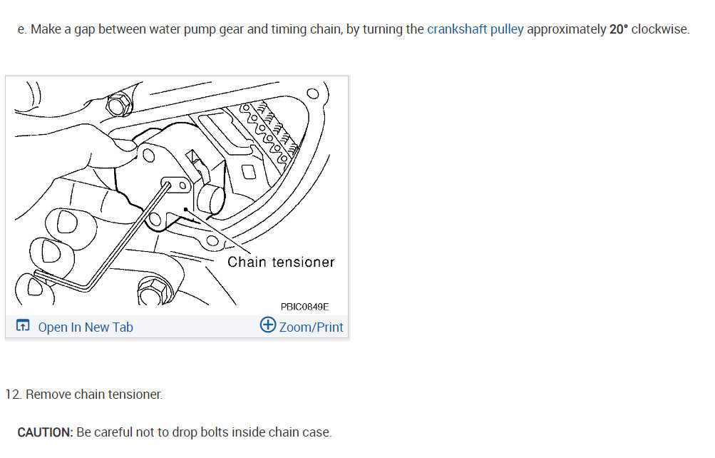

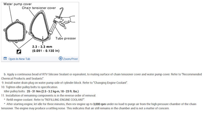

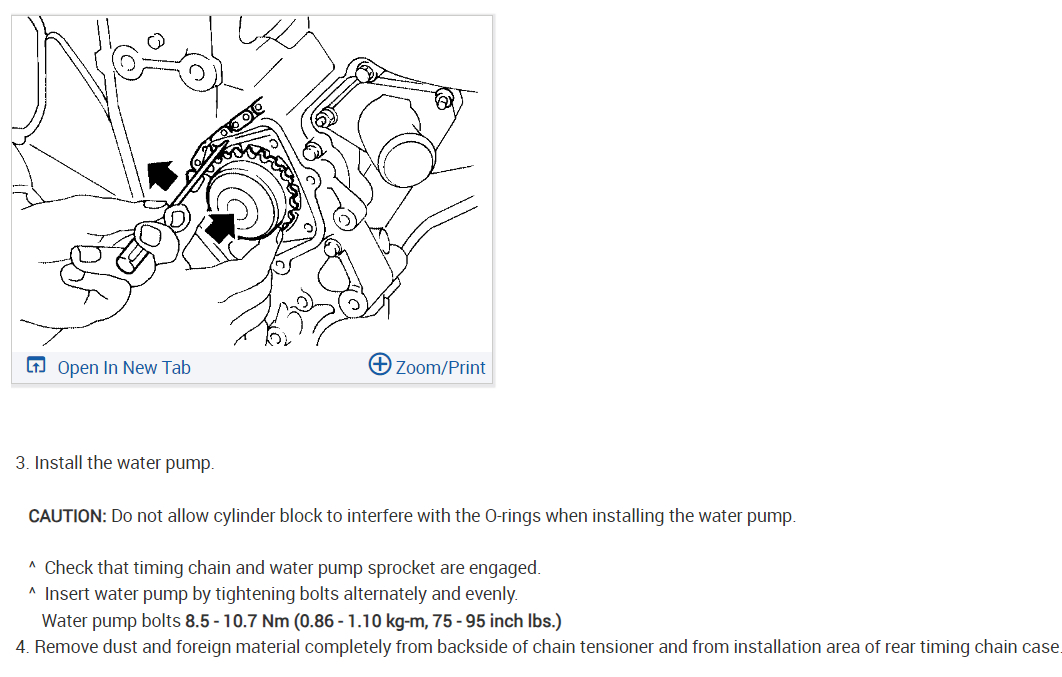

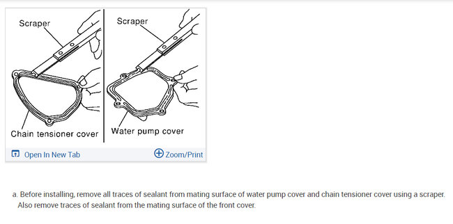

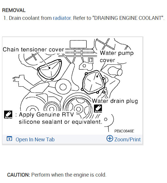

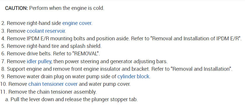

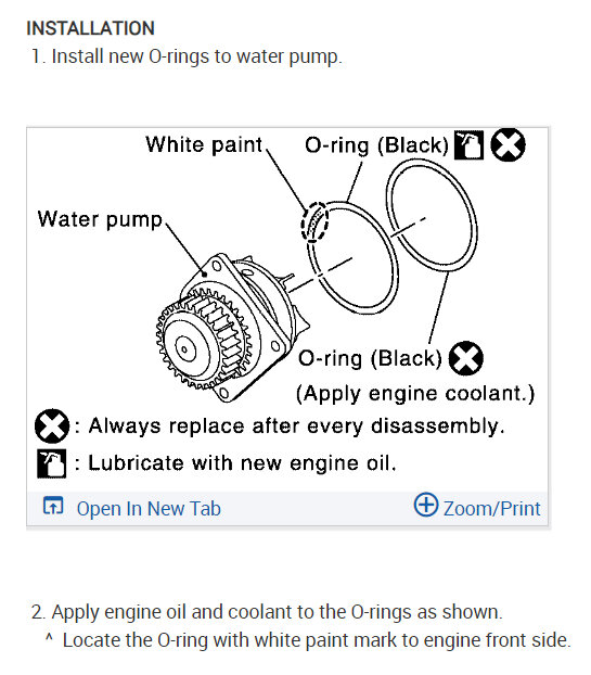

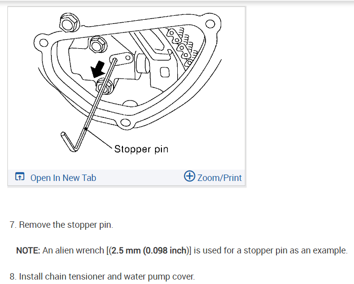

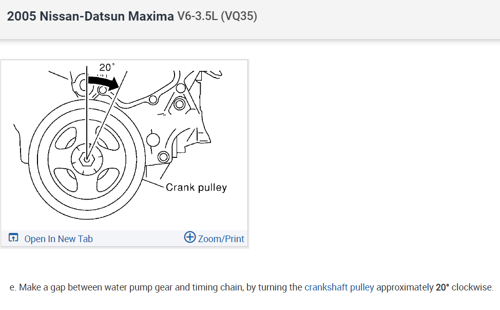

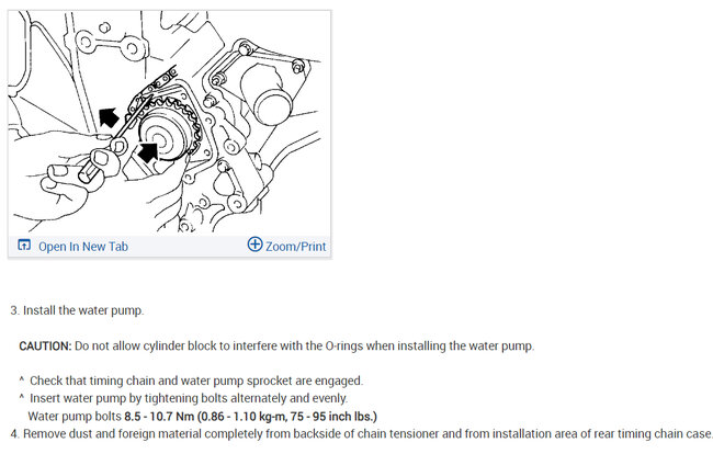

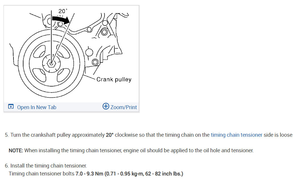

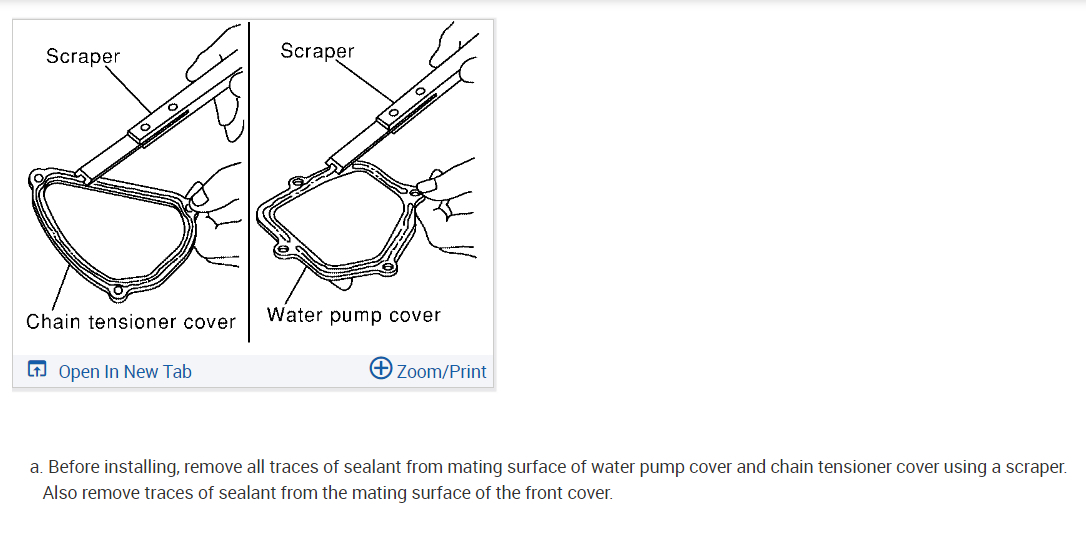

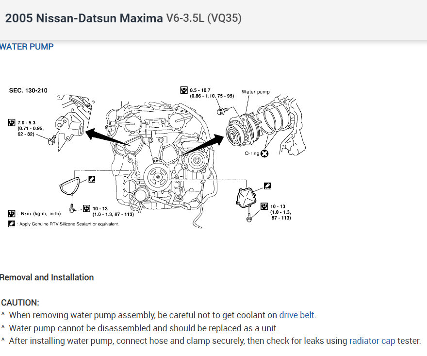

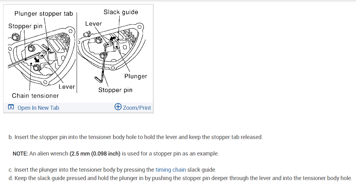

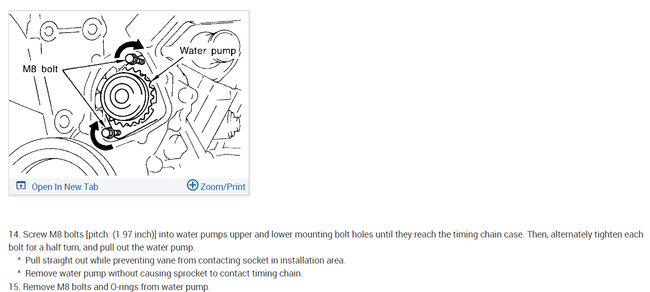

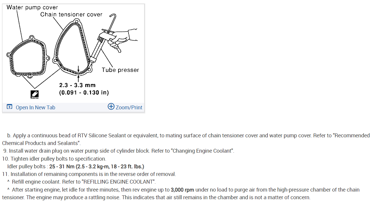

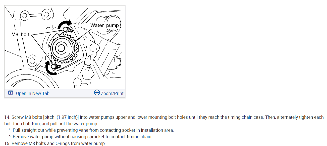

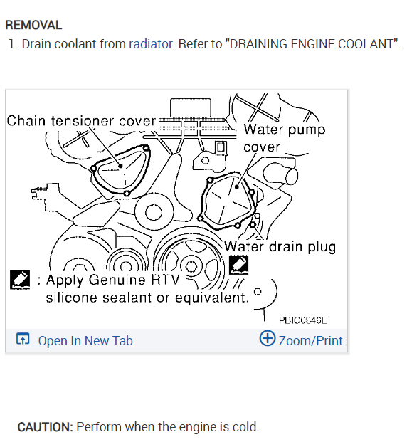

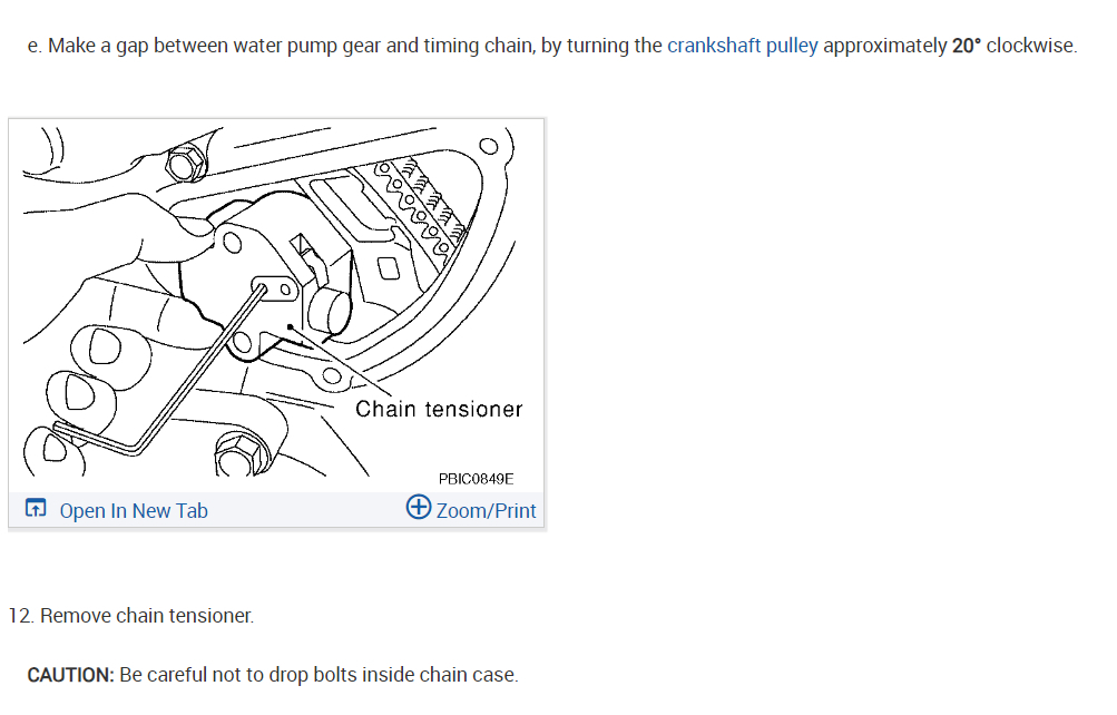

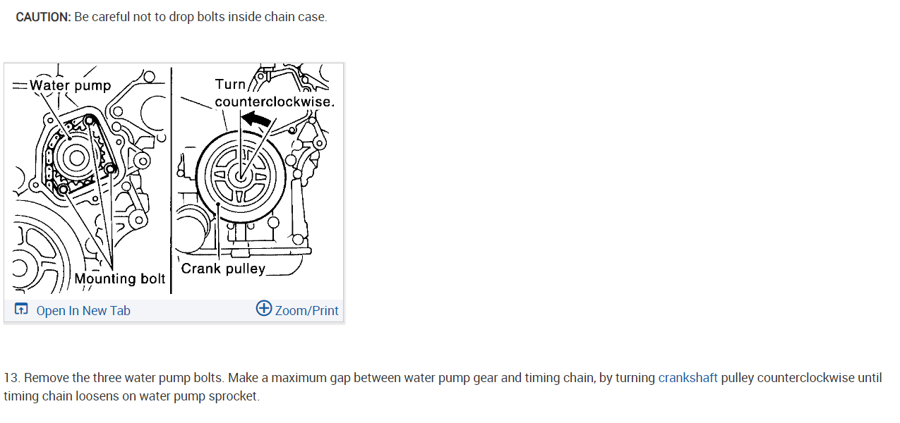

I don't see the video? I have seen the water pump impeller start to go bad/corroded/loose which will cause this kind of problem. The only way to tell for use is it remove it for inspection, here is how. Check out the images (below). Please upload pictures or videos in your response of any problems so we can see what to help you with.

Also, in my earlier post, I seem to have missed the video of the coolant flow at idling (800 RPMs) and then at 5,000 RPMs. Let me add it now.

Also Ken, in your opinion, is the flow of coolant as in the video typical of a good water pump working at 800 RPMs and 5,000 RPMs?
Oct 5, 2024 at 4:56 PM
  • 54,840 POSTS
Oh yes, it should be flowing much more than that. I would remove the water pump for inspection.

Thanks Ken. Appreciate all your help. It was indeed a bad water pump. There was nothing left of the water pump impellers :-)
