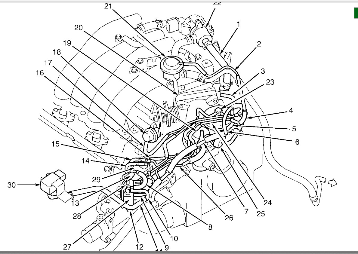

I changed my motor with an 01 infiniti that I owned I used 96 parts far as intake up I can't figure out the vacuum

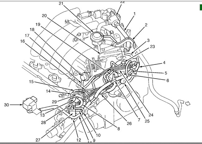

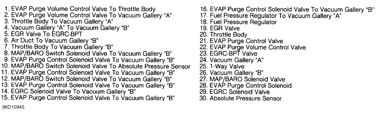

See pics for routing

Thank you that helps a lot
