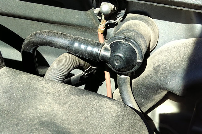

i am trying to figure out whether i need to replace the master cylinder or brake booster or both. when i turn the car on, the brakes need a little time and effort to start working. once i pump the brakes a few times they come to life, and they function normally. in the past, also, the brake fluid in the reservoir gets low and i have to watch to make sure it is at the correct level.
Of course, i don't want to drive this way and i want to fix it myself.
Replacing the master cylinder isn't a problem since it is right where i can get at it and an easy fix. The master cylinder is much more involved. So, would the problem i described be a symptom of a bad master cylinder or brake booster?

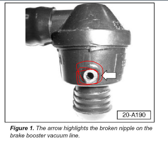

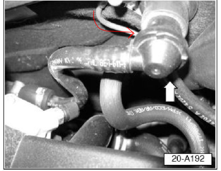

When you first start the vehicle, do you mean the brake pedal is hard to push? Or does it go to the floor and then pump up?
If it is hard to press, that would likely indicate a vacuum leak to the brake booster. It is common for a plastic nipple that is molded into the connector.
Check for a broken nipple on the vacuum line leading to the brake booster. The brake booster vacuum line is located between the engine and the bulkhead on the left side of the engine compartment, connected to the front of the brake booster unit.
I attached two pics below to help locate and identify if this is the problem.
Let me know what you find or if I am incorrect about what is happening.

Thanks for that. when i start the car and push the brake pedal it's a little soft but not completely loose where i can push it easily to the floor. it firms up to "normal" after i give it a few pumps.
i looked at the part you pointed out and took a picture of it. i gently moved the hoses and there's nothing broken on them and there's no leaking around the hoses.
