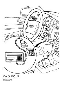

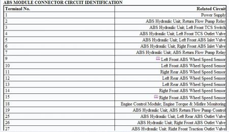

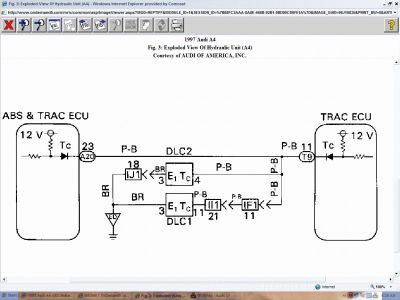

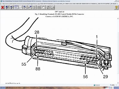

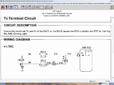

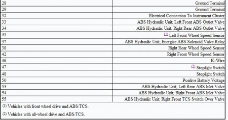

Check to see if either the sensors or reluctors where damaged during part replacement, the reluctors could have been demagnetized if a hammer was used too close to them...unplug the sensors and get an ohm reading, then switch to volts and spin the wheel to see if it is picking up a signal...Ohm should be between 400-2300....You can cross the Tc and E1 terminals on the DLC and count the flashes of the ABS light to get the trouble code.
