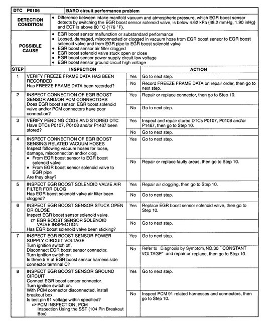

Have a code 106 MAP sensor circuit out of range or maybe MAP sensor replace. that is the only code. I had the code before.
Oct 27, 2020 at 12:27 AM
  • 110,240 POSTS
There are a few different things that can cause the code. I noted that you indicated you had the code before. What was done? Did it fix the issue for any amount of time?

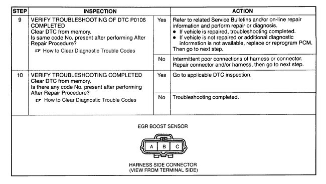

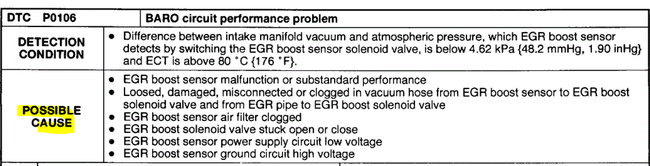

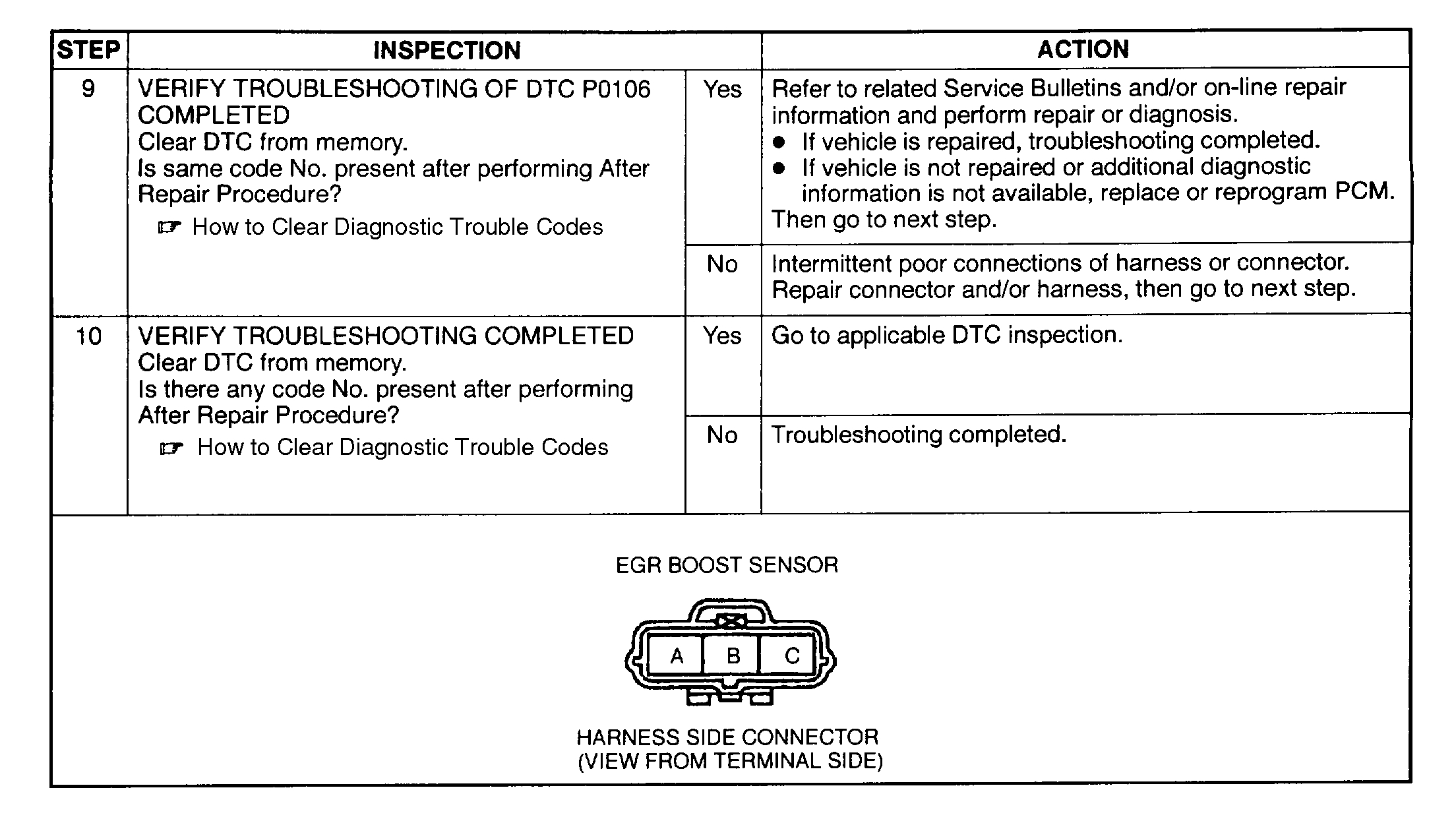

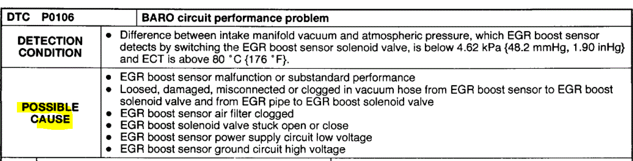

If you look at pic 1 below, I provided the likely causes of the code. Take a look through them and let me know if you have done anything with what's listed.
I also provided the diagnostics for the code (pics 2 and 3). However, I don't know if you have the test equipment needed. Let me know.
