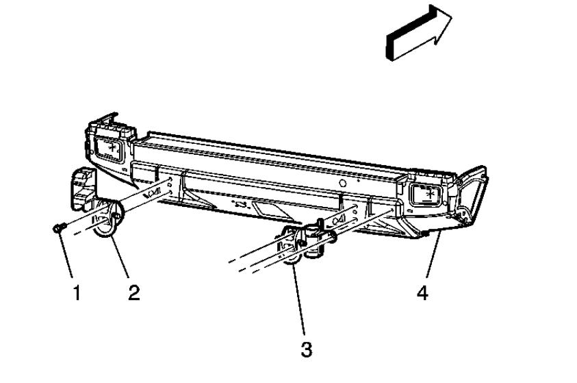

I have several issue with my 05 hummer h2. First is I would like to remove the rear tire carrier. Its a pain to open the rear of the car with the big swing arm on there, I want to remove it and put the license plate on the back of the car. How do you do this? Is there a step by step process?

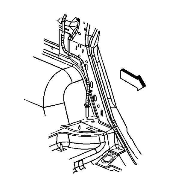

I also need to clean out the drain in my sunroof whioch are really clogged? How do you do that?

there are two drain hoses you will need to run a flexible wire up it but yo have to remove the panle near tailgate.pic enclosed. to get the spare tire carrier off you have to remove items 2 & 3 in pic. for license you will have to rig something up to move it because it's menat to be in center of tire. alsoyou willneed to mount a light on it otherwise you are a target for a ticket. the abs and tc will have to be scanned for codes to find out what is wrong. brakes can be checked then.
