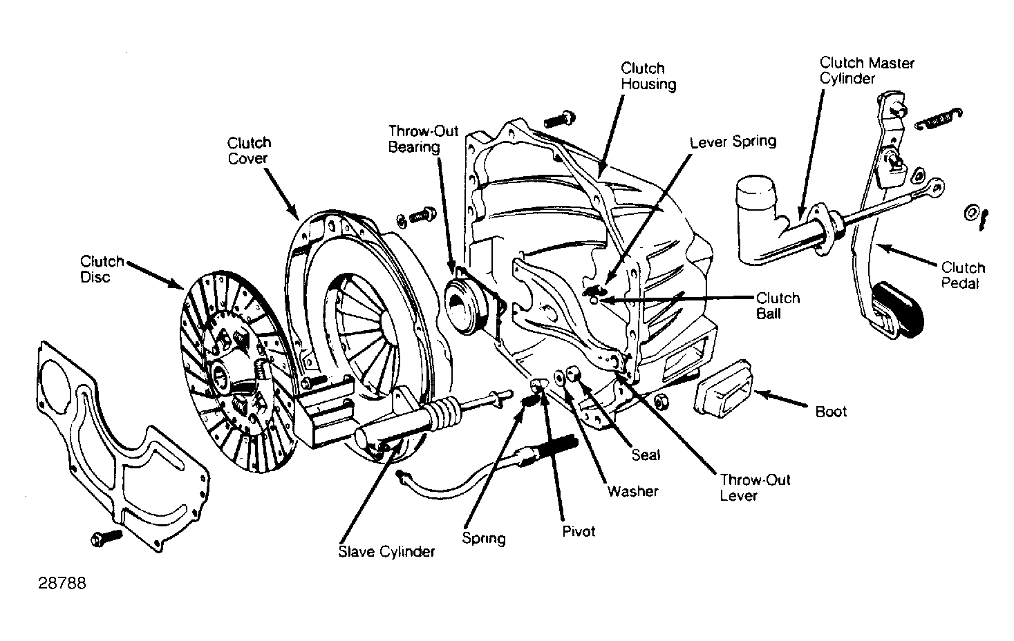

You have a T-176 4 speed transmission?
Has the transfer case been unbolted/removed/partially been removed from the transmission?
Does your slave cylinder fully extend when the clutch pedal is pushed?

I realized it may be something simple when I read your question about the slave cylinder. I opened the cap to see there was no fluid. Filled it up and after trying to get into gear and pushing the clutch a few times, I am able to shift with no problems.
I will let it sit for some time and check again in the evening if the shifter goes into gear with no problems. Thanks. Hopefully this was it, but I will send an update.

Keep the clutch reservoir topped off, do not let it run out of juice.
Pump the clutch pedal 3 or 4 times and hold it to the floor.
(insure there is no dirt daubers or mud obstructing the bleeder hole)

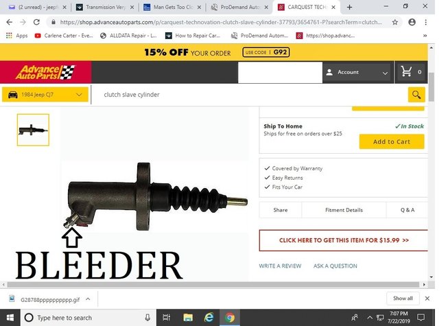

Have your assistant crack open the bleeder screw on the slave cylinder.
Just like I like to bleed brakes, I close the bleeder screw before all of the squirting pressure gets to zero. This insures that no air gets sucked back in.
I might even suck out any old juice from the reservoir before I started (turkey baster works well) then bleed until all of the old discolored juice has been pushed out.
Once you are done, search for and repair any leaks that might be present.
2 pics below,
