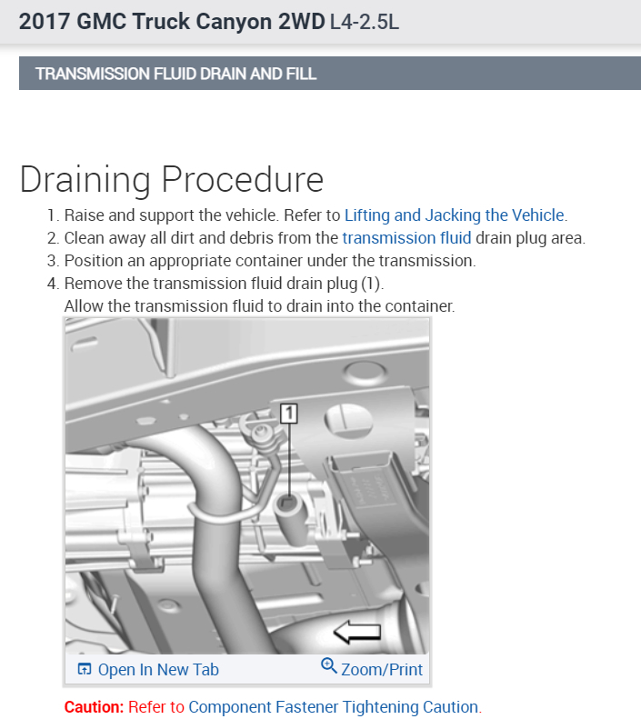

I would like to know what manual transmission fluid to use. I read that Dexron VI is the fluid to use, and do you know how much fluid to use? I am getting conflicting info from a mechanic shop and quoted me an outrageous pricing to do it. I should be able to do it myself. Just need the type of fluid and the amount. Thanks
Oct 27, 2023 at 1:34 AM
  • 55,398 POSTS

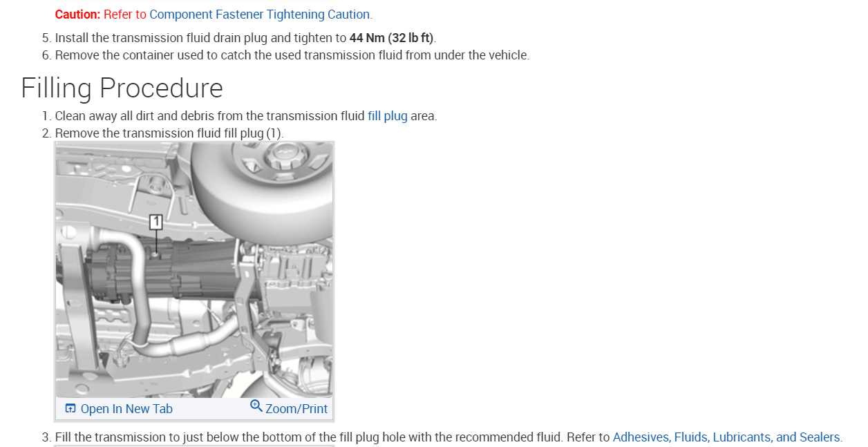

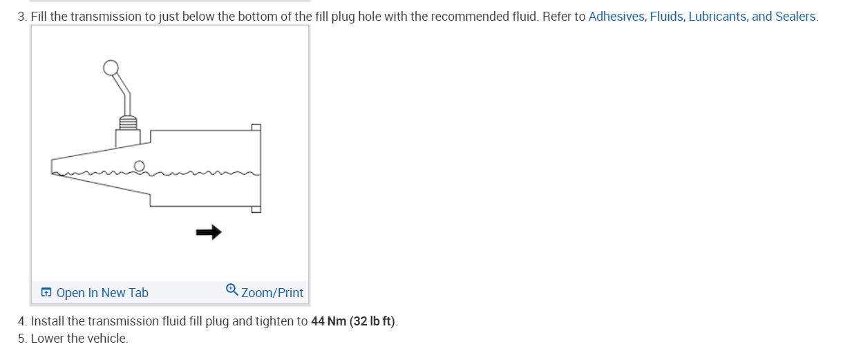

Yep, it uses automatic transmission fluid here are the part numbers to help get the job done.
Automatic Transmission Fluid DEXRON®VI #88861037 US and #19264717 Canada
This guide can help you step by step with instructions for your car in the images below:
https://www.2carpros.com/articles/how-to-service-a-manual-transmission
Check out the images (below). Please let us know if you need anything else to get the problem fixed.
