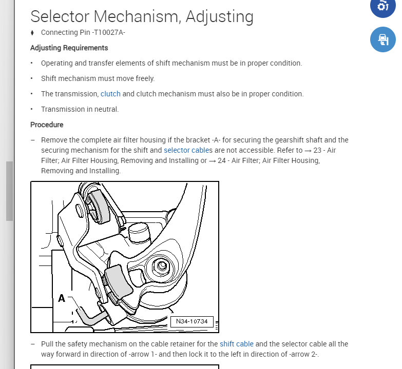

Today as I was driving, I came to I light and shift into first and the shifter felt like it was in gear. When I released the clutch to engage it grid a bit and pop out of gear, so I tried again and nothing. it will not go into gear. I was able to take off in second when I go to third same. So, I pop it in four then when back up to three to see what will happen and gear went in nice no problem. So, in order to go into one first I need to shift to two then one same as three gear fist four then 3. If anyone can guide me on where to look or what to check, thanks.

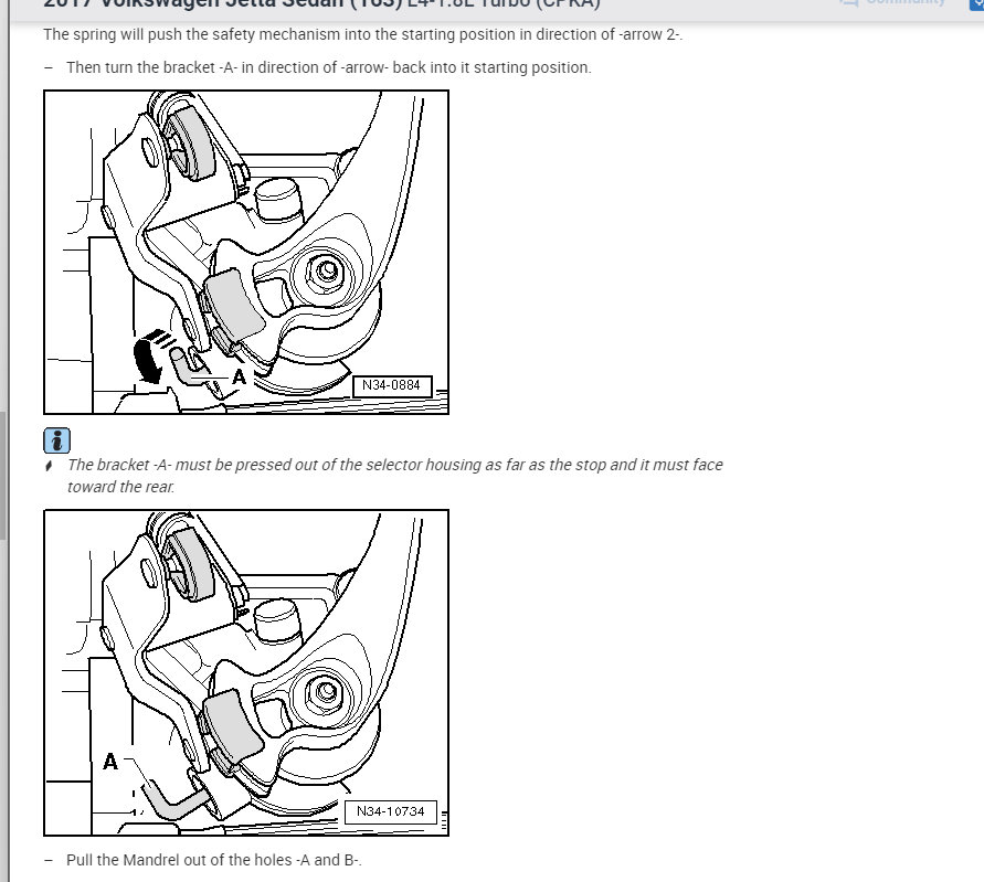

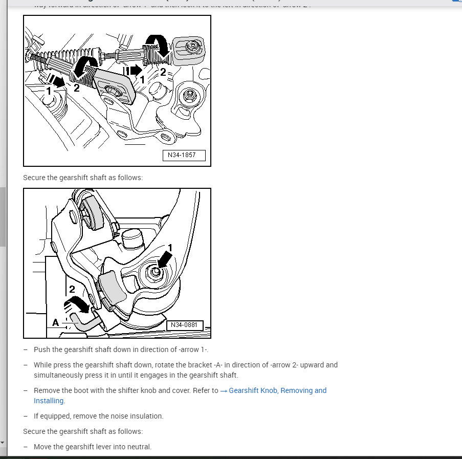

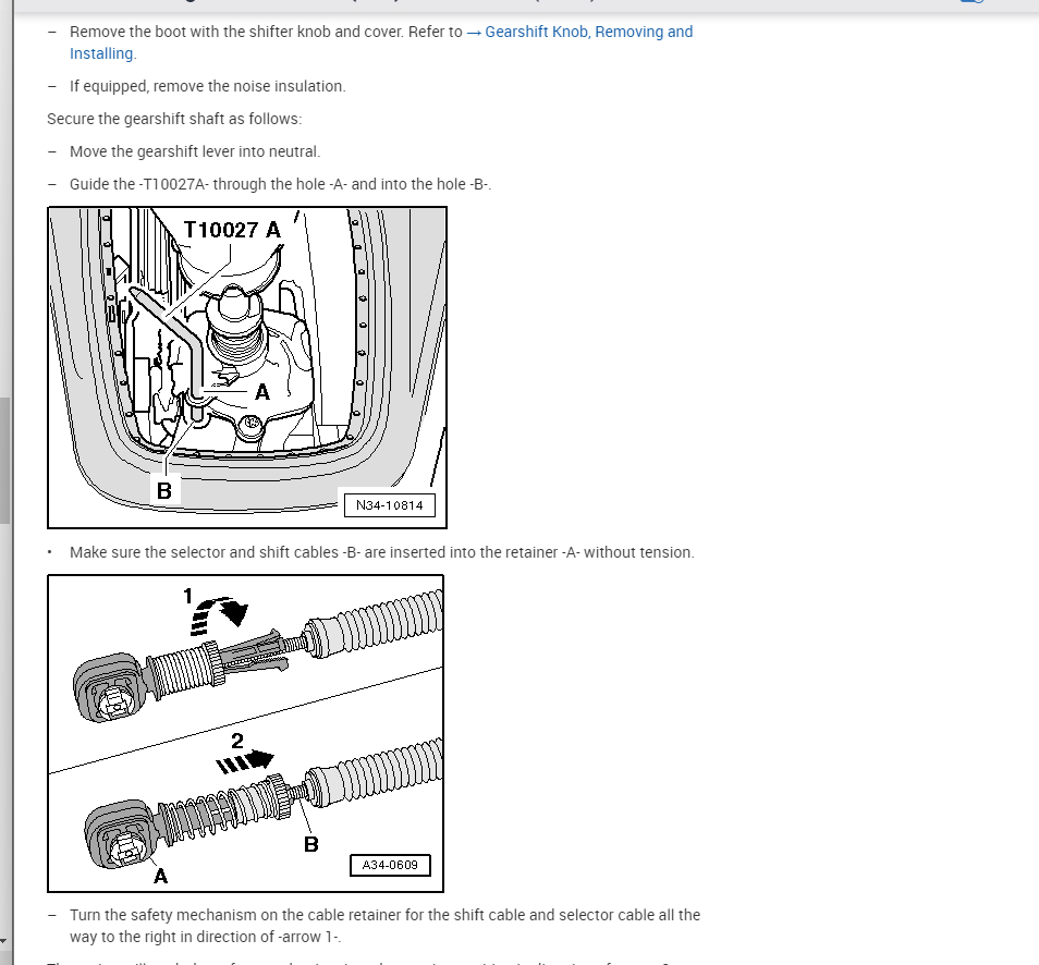

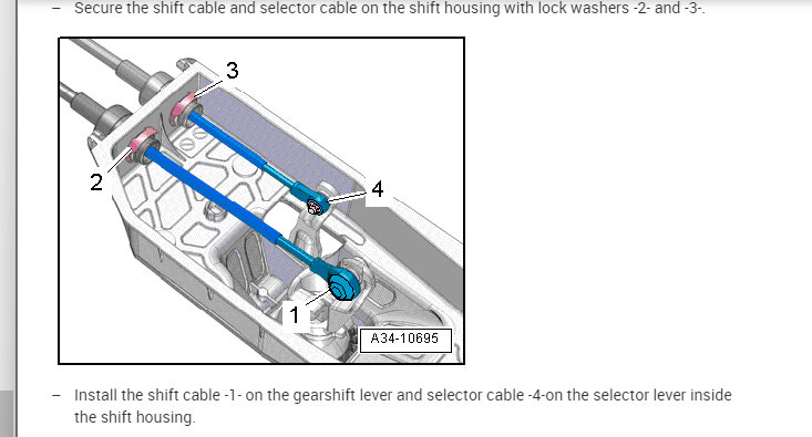

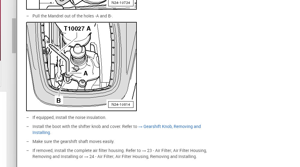

can you provide a diagram for both shifter cable?
Jun 14, 2022 at 10:10 AM
Sure. I am not exactly sure what type of diagram you are looking for on the cables, but I am providing what is there in the manual plus the adjustment process for the cables so let me know if you need something different.
