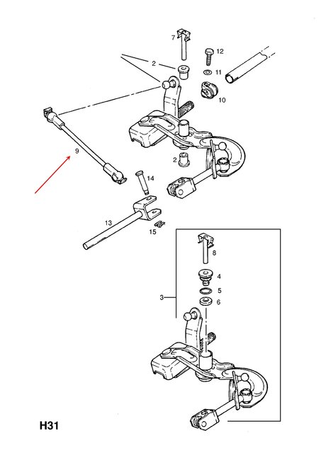

One more thing that I would like to understand.

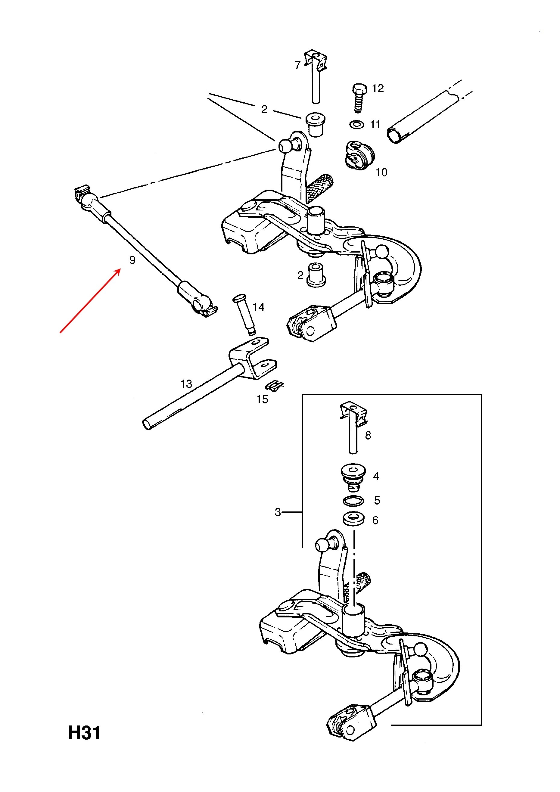

When I was checking the gear shift linkage, the gear shift selector lever rod number 9 in the attached photo)was connected in both sides. But, is it possible that the problem is actually from this rod in spite of the fact that the rod wasn't popped-out either sides?While replace that rod will solve the issue?Or as long as one of the edges of this rod doesn't pop-out from the metal ball, there won't be any issue from this rod?

I haven't heard from you in awhile. Hope all is well. As far as your question regarding number 9 in the pic, where does it attach on the transmission? Not being familiar with the design, I need to know what it goes to.

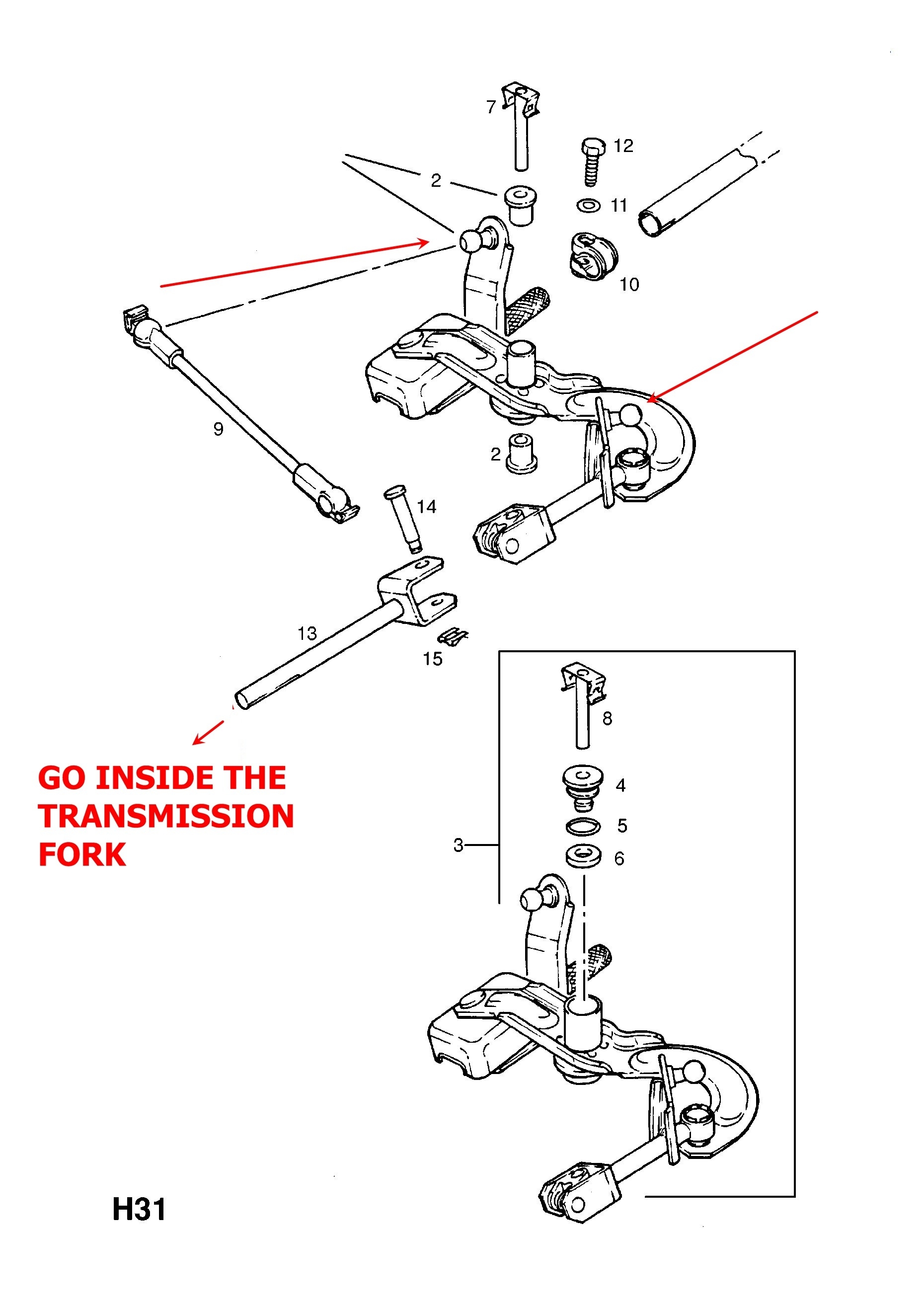

As you may see in the attached photo, number 9 gets into the metal balls which is marked with the red arrows. The last rod (as can be seen in the photo) get inside the transmission fork. As I asked, could part number 9, although all, be the cause of this problem (some wear or something), even that it wasn't pop-out? Or part number 9 can't be the problem as long as it doesn't pop-out from its place?

Absolutely. Anything that has excessive play (even if it isn't disconnected) can cause a problem. Is there excessive play in part number 9 from above?

I don't see any excessive play on part 9 itself.
The cups are just connected to the two metal balls.
The play is beyond this part.
I guess that this part is not the issue.

You are very welcome. I haven't helped very much. LOL When you say the play is beyond that point, do you mean toward the transmission or toward the shifter?

It moves as a whole unit left and right. I can't put a finger toward where the play is moving. Maybe if I will dismantle part 9 I could find it, but I will check it on other time.
