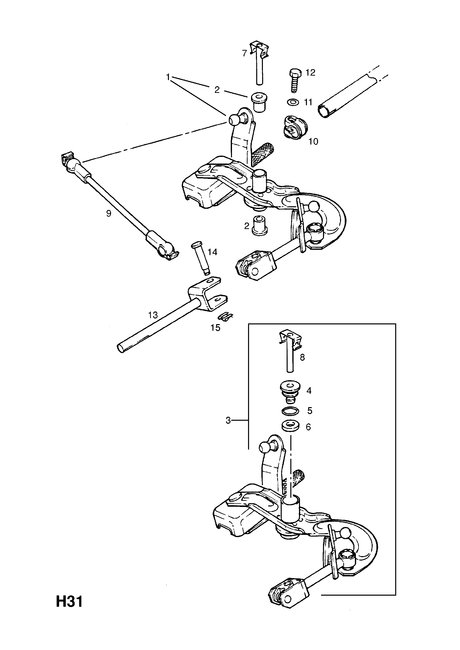

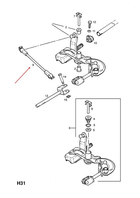

BTW,i attached a photo of the car's selector linkage.Is this what you are talking about?
Jun 21, 2020 at 10:58 PM
  • 110,244 POSTS
Yes, that's exactly it. Check all location where things are joined together. Hopefully, you will simply be able to reattach it.

Today,i started to search the issue.I was hopping to find the shifter rod (number 9 at photo)
comes off/disconnected,but it wasn't. so i didn't know really what to look for.I didn't see anything disconnected.
So i play with the selector while i am under the hood.The selector mechanism seems to be loose,but i don't know how much is considered to be too loose.Under the hood,i grasped and moved the mechanism,i managed to shift the selector to 3,4 and 5 gears (while in driving i can shift only 3 and 4 but not 5).1,2 and reverse i couldn't shift under the car hood,maybe if i give more power and someone was press the clutch pedal i could shift them,so i don't really know if it can be shift or not to those gears by hand).besides that the 3 and 4 gears were always shift smoothly compare to the 1 and 2,so maybe there is a connection between my results.Anyway,while in driving,i can use 1 gear and 2 gear,but in the special conditions that i mentioned before and while i don't have a reverse.
What should i do next?

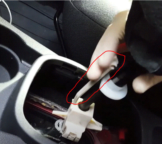

I have to be honest, it sounds like the linkage is worn out. Can you video what you are seeing as far as play? Also, if you see nothing moving when shifting to reverse, then something is likely disconnected or broken.
I tried to find info on the vehicle, and on YouTube I found several videos related to shift linkage on this vehicle. I attached a pic I got for you to see. There is a plastic clip that connects for going to reverse. Have you taken the boot off the shifter to inspect things?

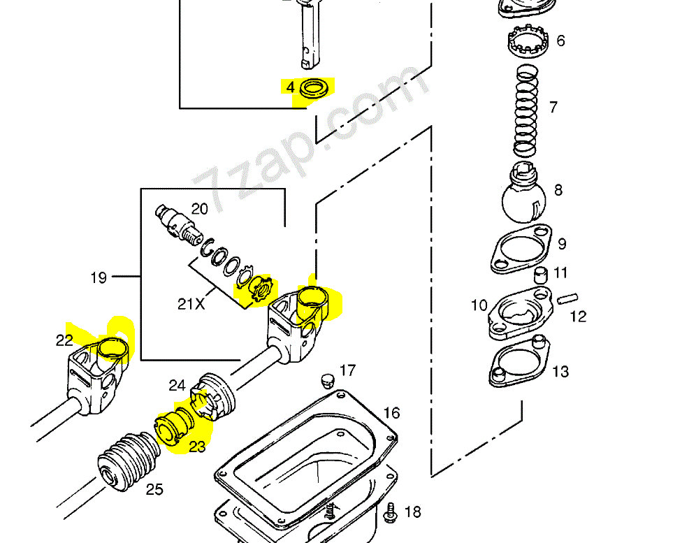

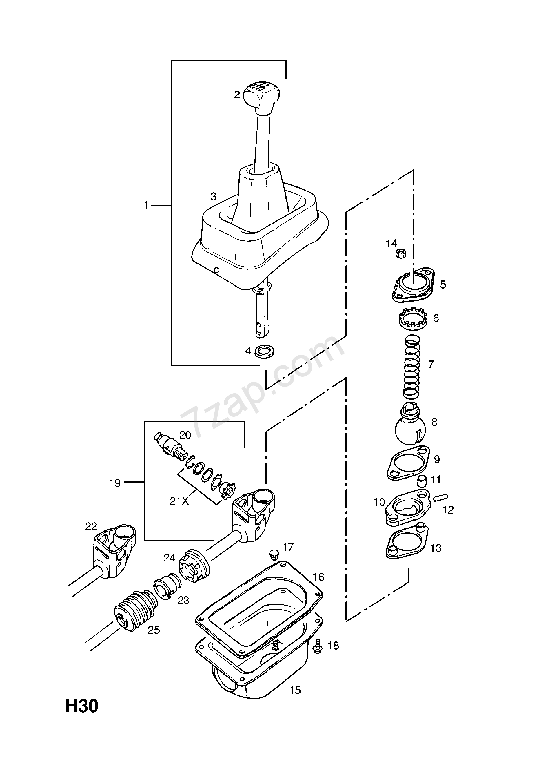

As you see my gearshift lever looks like my attached photo,
In your attached photo is different.

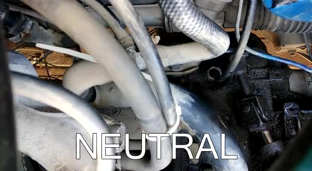

I attached a video that shows the behavior of the linkage when i use the gearshift lever.The subtitles that i added refers to the position of the gearshift lever in the car,while you can see what happens in the linkage.I know that you can't actually see all the linkage,but only the end of it,but that what i could to record,i hope it may tell something.BTW,i tries to do an adjustment to the gear followed by Haynes book,but nothing get better.
Refer to my attached photo of the gearshift lever,what is the purpose of the bush and the ring(number 23+24)?Can they cause the same symptoms
if one of them fails?
Jul 8, 2020 at 3:34 AM
  • 110,244 POSTS
I watched the video several times. I noted that when you shift from 2 to 4 the shifter rod stays in the same position even though the linkage from the in the vehicle is moving. That is also happening in 1 and 4.
There is some play in the universal joint in the video. However, I honestly suspect that it's a combination of that joint and something up further towards the passenger compartment.

The video was recorded after my adjustment,but before i took the car for a test.so today i found out that the 5 gear is working.
That is why you may see in
the video that it shifted into the 5 gear.But the reverse is still missing.
Yes,the video shows what you said and if you say that this play in the universal joint is not normal,i guess that the other connection are not in better condition refer to their free play.i probably need a new gearshift
linkage indeed.The problem is that after hours of searching for the one that fit my car in eBay and in other websites i haven't find it yet.I see only the gearshift control rod for sell(number 9)for my car,but not as a complete unit.
When you said:"...something up further towards the passenger compartment..."what other parts may cause or contribute to this?

I attached your picture below and highlighted places where I would suspect there to be some form of bushing. Likely, it would be a nylon bushing.
Let me know if this helps.

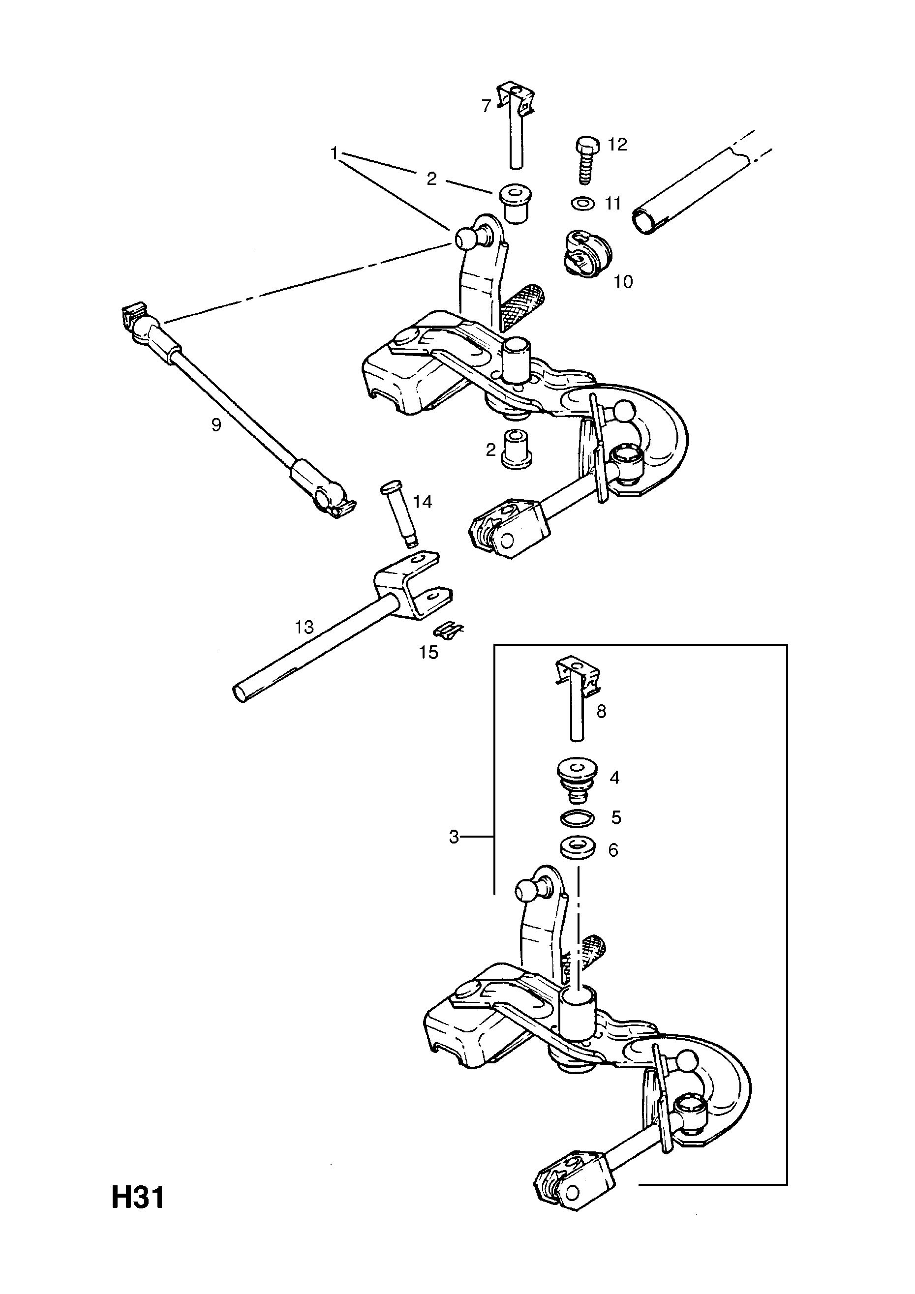

When i was checking the gear shift linkage,the gear shift selector lever rod number 9 in the attached photo)was connected in both sides.But,is it possible that the problem is actually from this rod in spite of the fact that the rod wasn't popped-out either sides?while replace that rod will solve the issue?or as long as one of the edges of this rod doesn't pop-out from the metal ball,there won't be any issue from this rod?
Thanks.
Jul 28, 2020 at 7:23 PM
  • 110,244 POSTS
I haven't heard from you in awhile. Hope all is well. As far as your question regarding number 9 in the pic, where does it attach on the transmission? Not being familiar with the design, I need to know what it goes to.

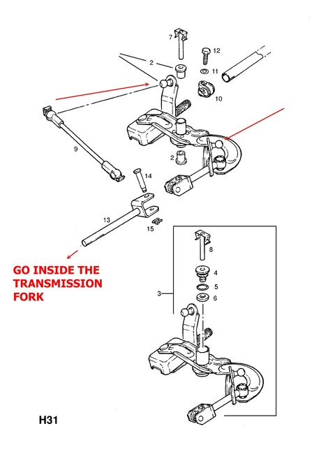

As you may see in the attached photo,number 9 gets into the metal balls which is marked with the red arrows.The last rod (as can be seen in the photo) get inside the transmission fork. As i asked,could part number 9, although all, be the cause of this problem (some wear or something), even that it wasn't pop-out? or part number 9 can't be the problem as long as it doesn't pop-out from its place?
Thanks.
Jul 29, 2020 at 10:19 PM
  • 110,244 POSTS
Absolutely. Anything that has excessive play (even if it isn't disconnected) can cause a problem. Is there excessive play in part number 9 from above?
