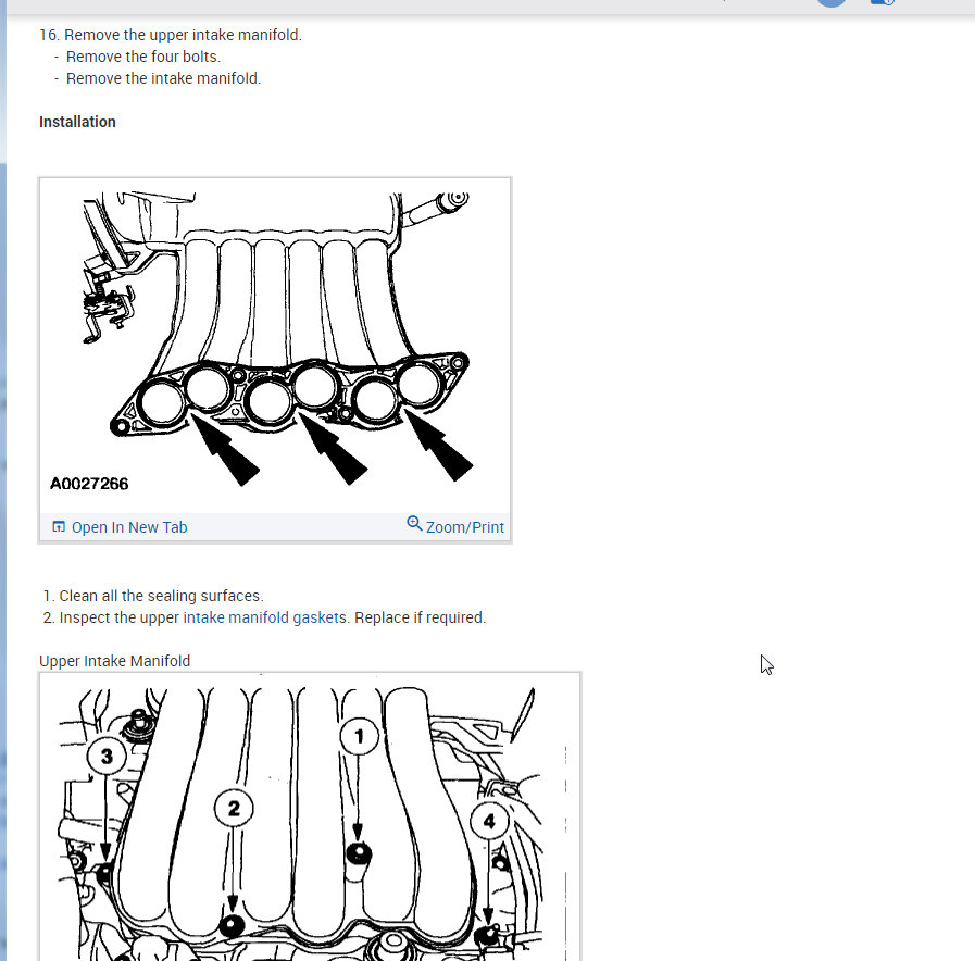

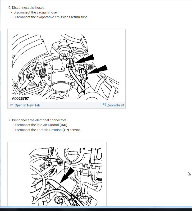

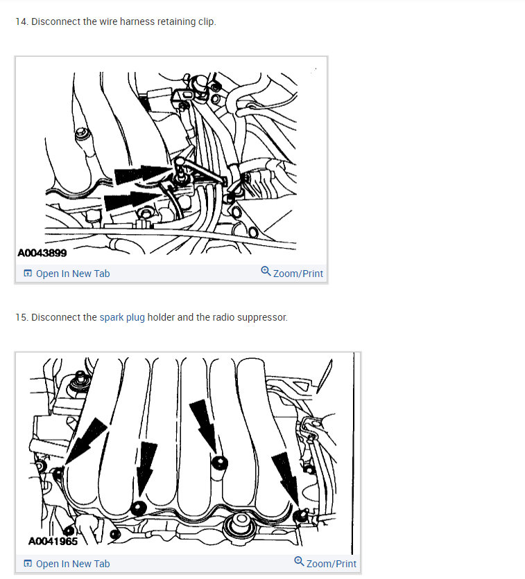

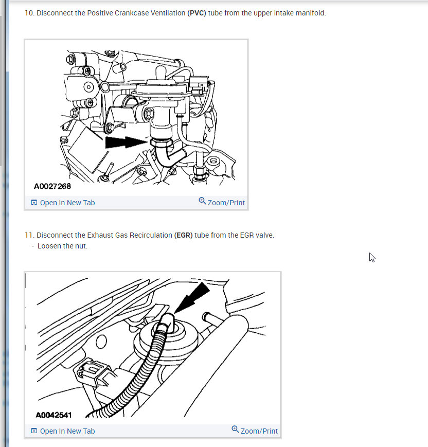

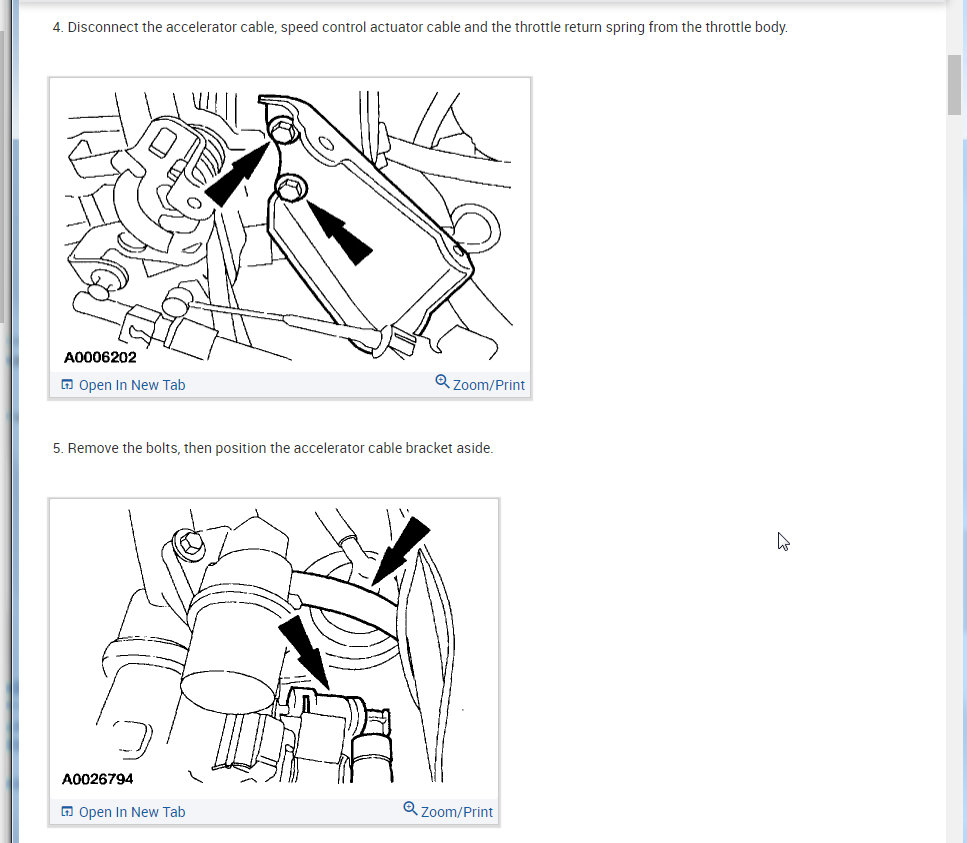

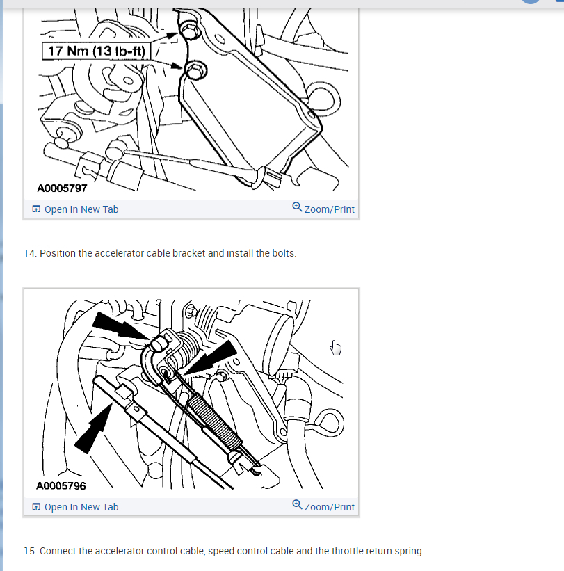

Unfortunately, we don't have a manual on this engine as it was not offered here in the USA but I am attaching a guide that will help get this started.
https://www.2carpros.com/articles/replace-intake-manifold-gasket

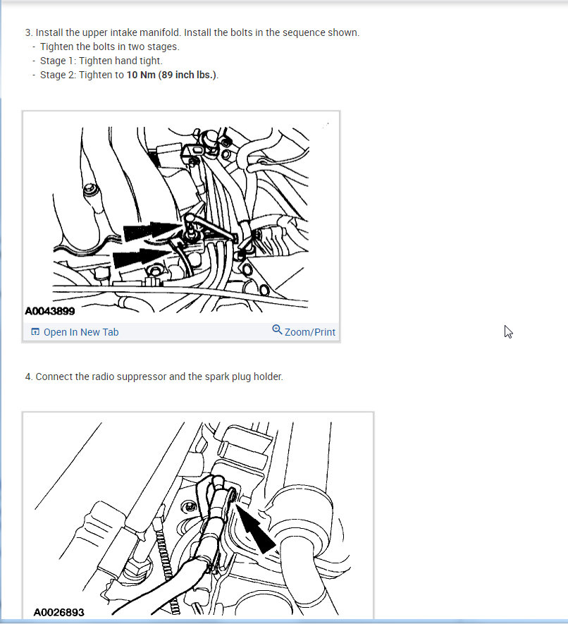

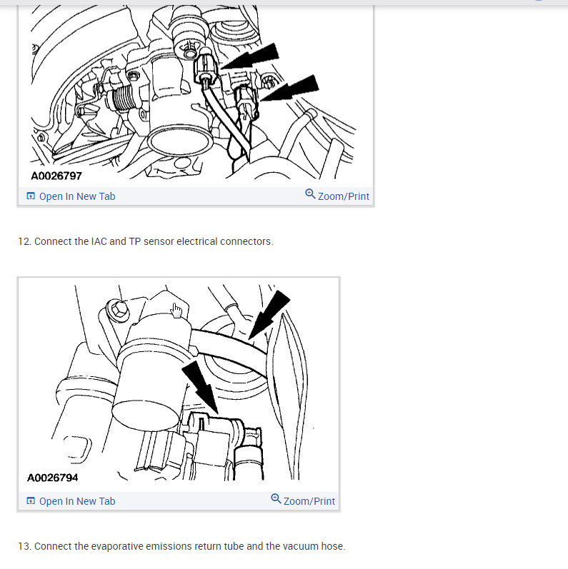

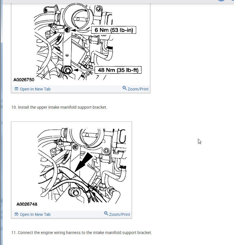

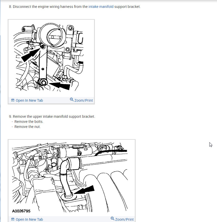

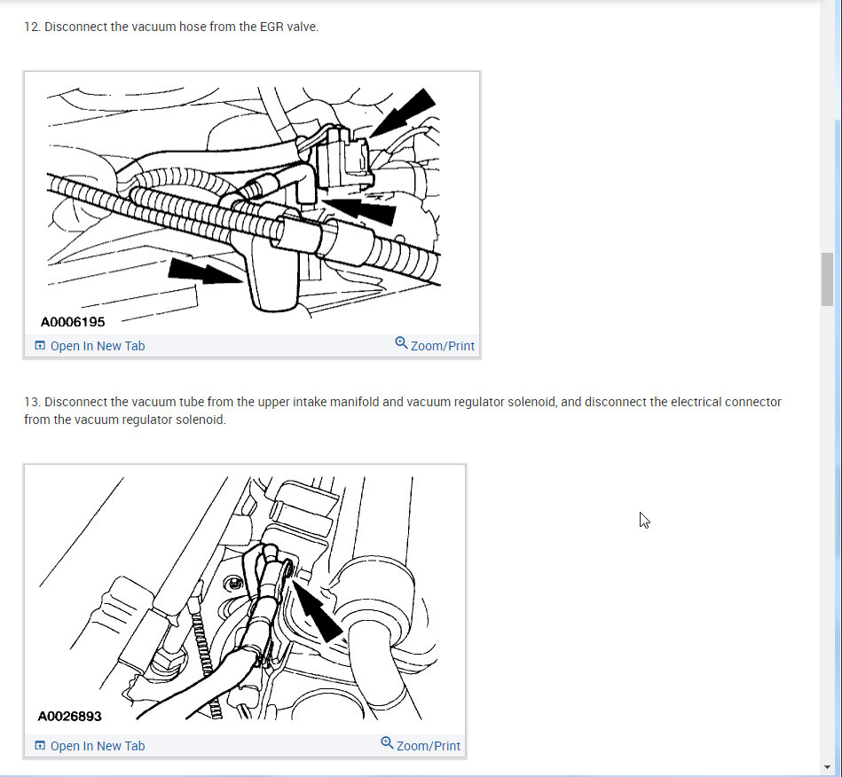

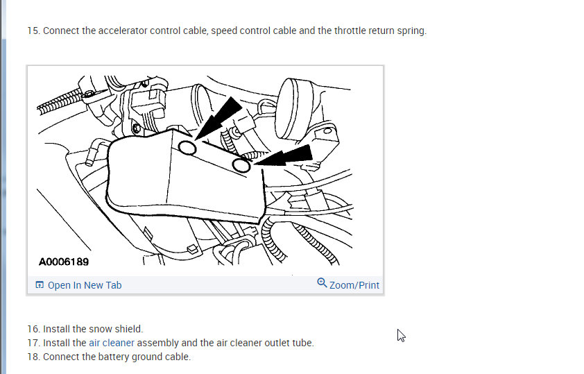

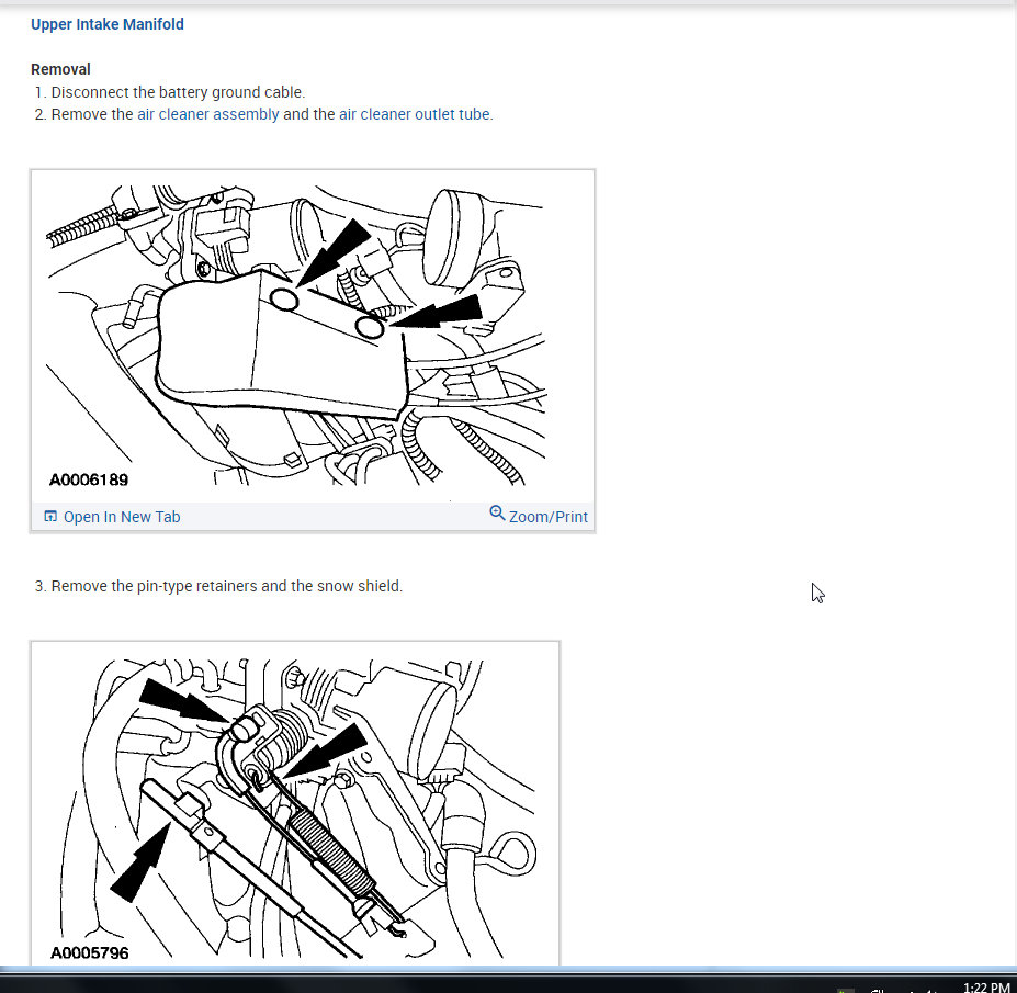

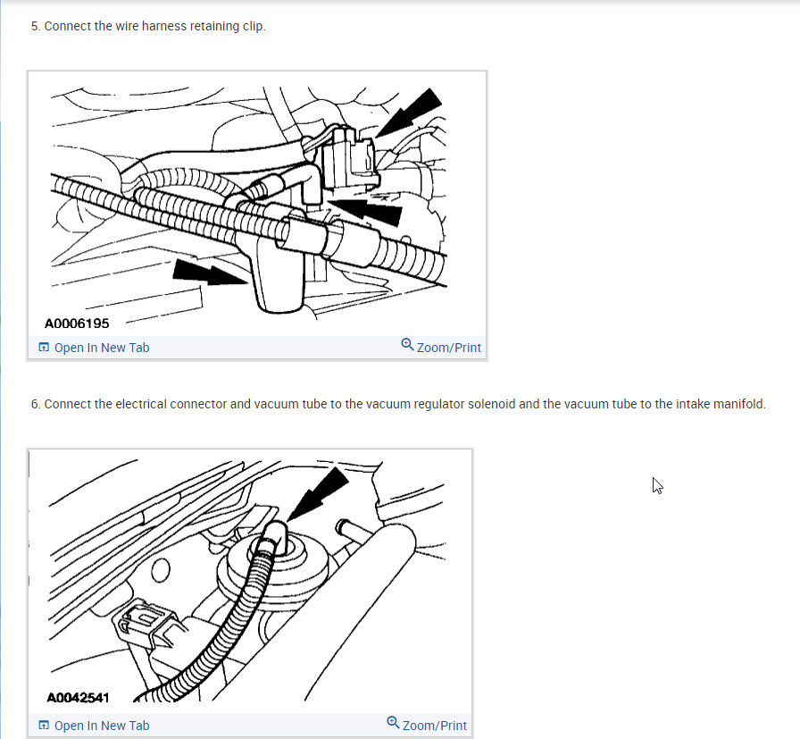

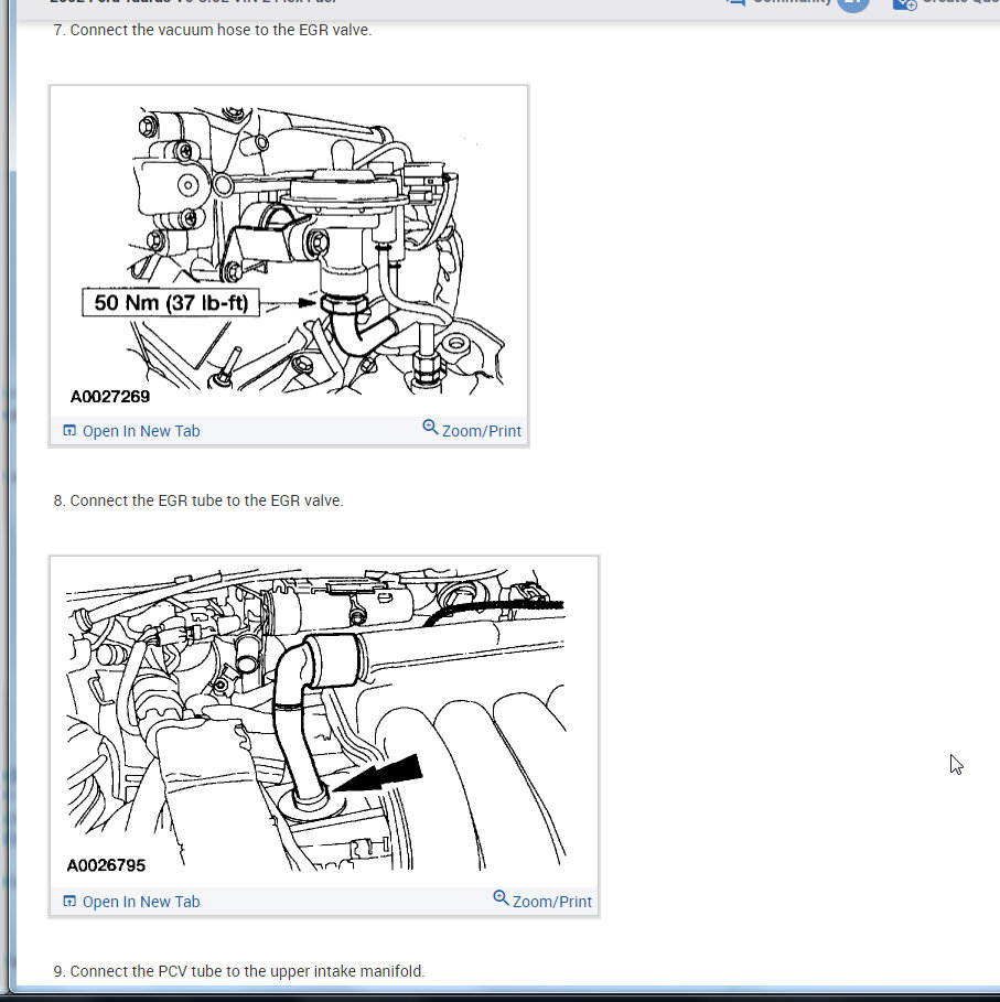

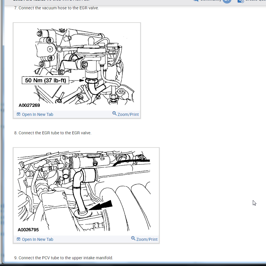

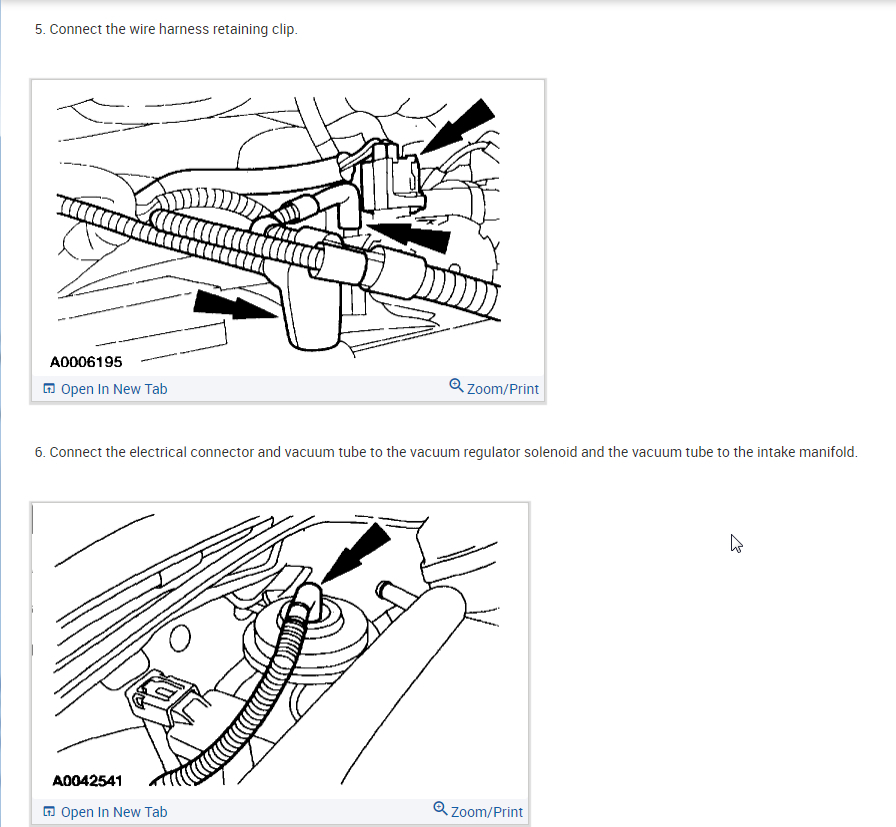

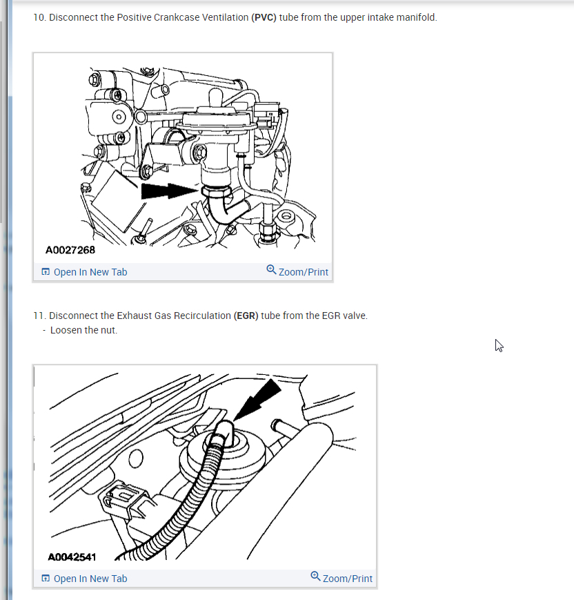

Also, here is the instructions for a 3.0L which is close to your engine and will be similar. Clearly this is not exactly what your steps will be.
Let's run through this info and let us know if you need more info. Thanks
