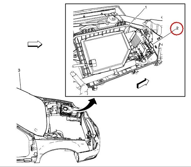

I need to change it but the dealer will not say where it is.

Your Engine Computer is listed as being "front left side of the engine compartment, inside the air filter housing. I found this drawing that shows its location. In case it is hard to read, I put a nifty red circle around Item number 2.

Did you find the location of the PCM? There is a diagram in the first reply post did you see it?
