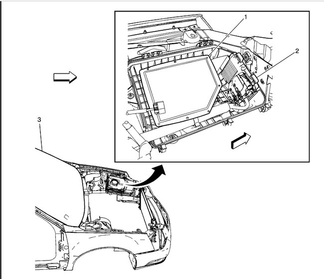

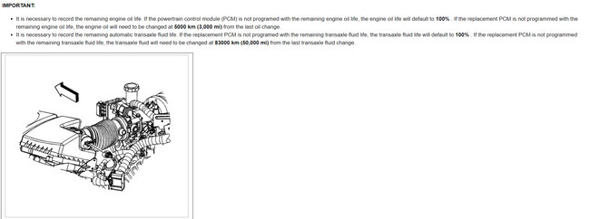

Where is the engine computer located so I can add a JetChip Module. I found the transmission but don't see the engine computer. Please help.

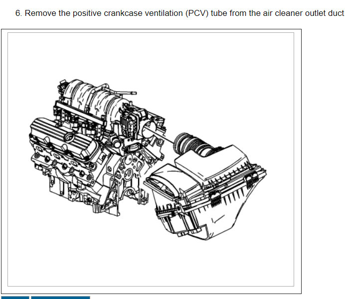

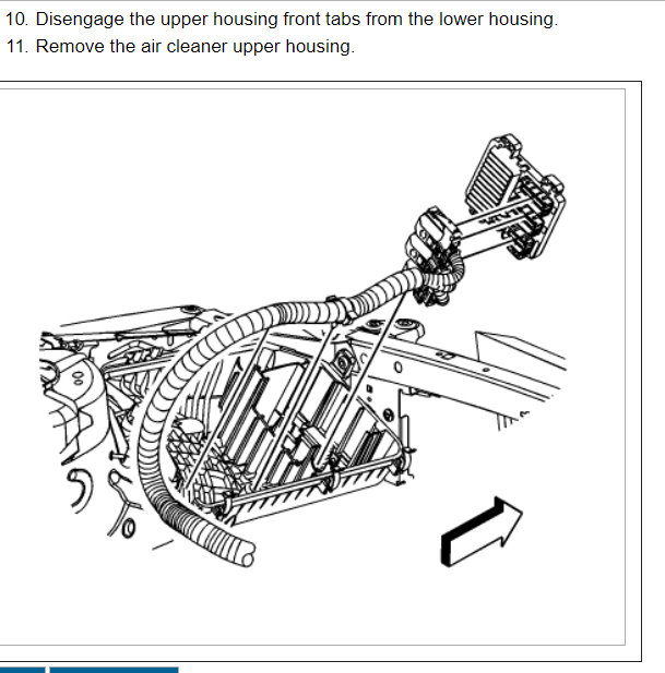

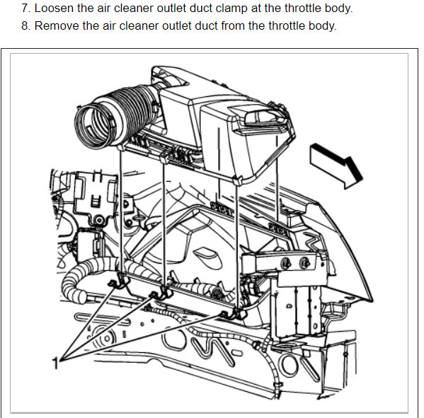

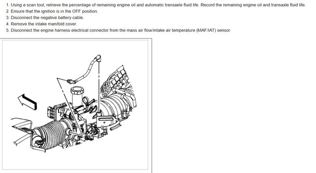

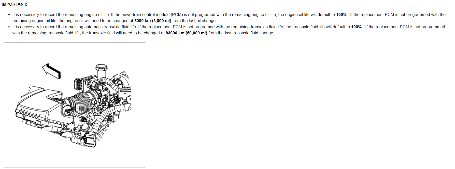

It is located on the left side of the engine compartment. here are diagrams and instructions below
Cheers
