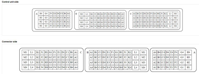

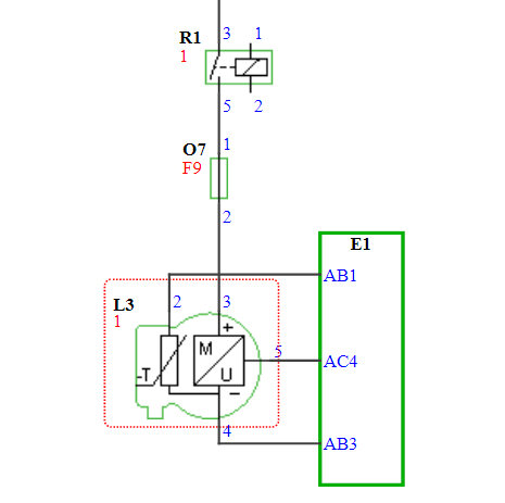

Pin out at MAF sensor(4 wire)
Pin 1, not occupied
Pin 2, grey/orange wire IAT signal to ECM pin AB1
Pin 3, violet/grey wire 12V MAF supply from fuse F9
Pin 4, blue wire ground to ECM pin AB3
Pin 5, yellow/violet wire MAF signal to ECM pin AC4
The MAF sensor incorporates the IAT(Intake Air temperature sensor)
With MAF disconnected and ignition on you should see between 4.8-5.2V on pin 2
If voltage is not ok next measure the voltage at pin AB1 at the ECM(Engine Control Module)
If voltage at ECM is in order next check the grey/orange pin to pin.
Expect to see less than 2 ohm resistance
This can be done using a voltmeter
How to use a voltmeter
How to check wire

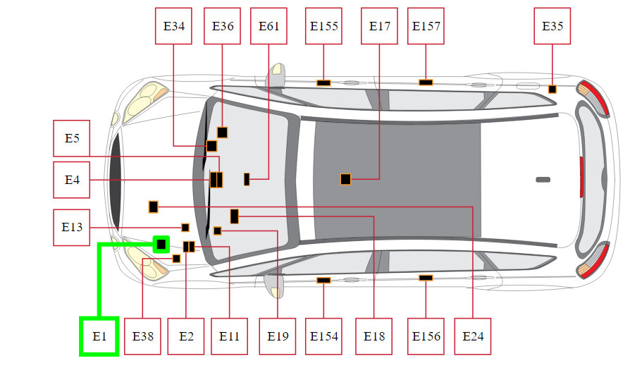

There are 3 connectors on ECM, A-B-C
The pins are on connector A, small
The ECM is located in the engine compartment, left front
See image 3
Cheers, Boris

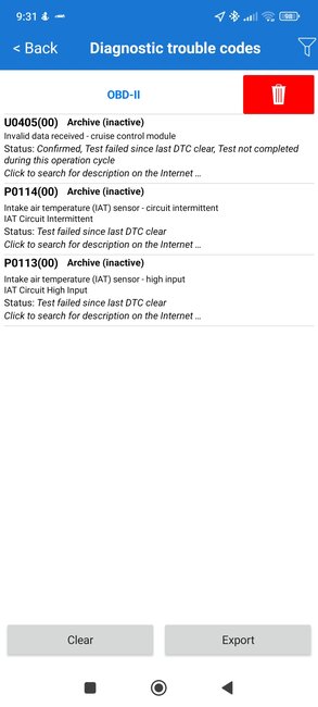

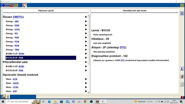

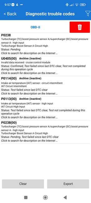

two error codes are written by the diagnostics (with VCX nano,ids software).

None of these fault codes are engine related.
BCM - Body Control Module
PDM - Passenger Door Module
What makes you think that there is a problem with the engine management system?
Do you have running issues?
Cheers, Boris
Sep 1, 2023 at 12:59 AM

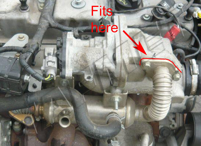

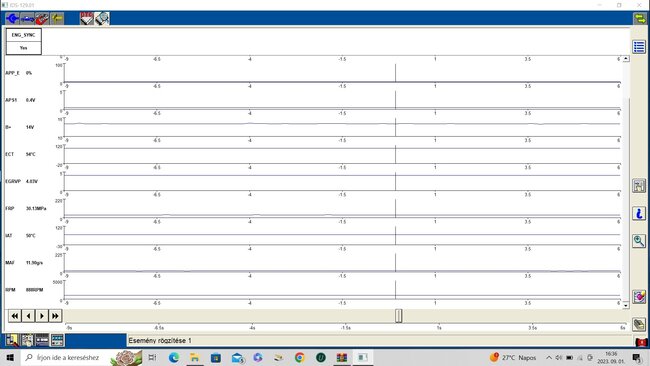

Looking at the video you are back probing pin 5 which is the signal wire for the MAF.
A virtually static voltage of around 2.11V.
On live data, the previous post the air mass was at 11g/sec, which seems a bit low.

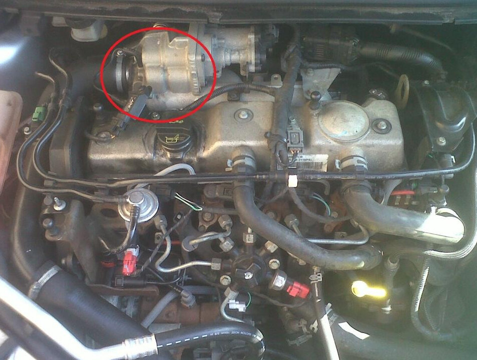

Have you checked the operation of the EGR valve? Not blocked and moving freely.
Another option would be to blank the EGR valve for testing purposes.
See image 1+2 below.
An eBay link:
https://www.ebay.co.uk/itm/121106889703
Cranking and non-starting on a diesel can be caused by a stuck open EGR valve.
Another aspect to check when vehicle is non start is the fuel rail pressure, ensure that while cranking the rail pressure is more than 200bar in live data. The ECM will not trigger the injectors if the rail pressure is below this value.
Cheers, Boris

yes, the EGR is blanked. The rail pressure is more than 200 bar. "Air mass 11g/s at idle". Still not enough?

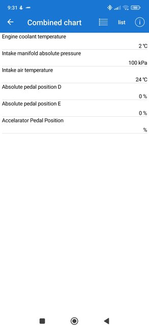

can't a faulty MAP sensor produce such a symptom? Or IAT sensor?
Sep 3, 2023 at 6:19 AM

A faulty MAP/Boost pressure sensor can cause all sorts of issues.
Check the sensor in live data.
Ignition on/engine off you should see ambient pressure, about 1000 mbar.
Engine idling the reading is usually slightly lower, around 920-950 mbar as there is no turbo boost at idle.
A faulty temperature sensor can cause starting and running issues.
The easiest way to check these sensors, IAT and ECT, is to check live data when the engine is cold.
Ideally stood over night. The live data values should equal ambient temperature.
Cheers, Boris

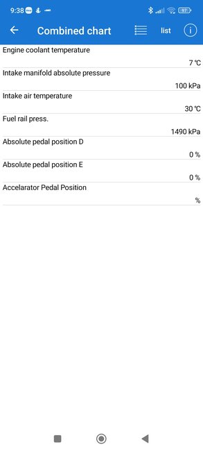

I watched it live data. I'm attaching pictures and video.The ECT is new. At idle pressure is 100kPa. (Is the IAT measured by the MAF or the IAT? because I disconnected the IAT and it didn't change intake air temp., but when I disconnected the MAF it showed 0°C on the intake air temperature)
Sep 4, 2023 at 6:17 PM

The IAT sensor is part of the MAF, pins 2+4
Watching the video, the starting behavior is as if the glow plugs are not being activated.
As soon as there is a bit of combustion temperature the engine starts well.
