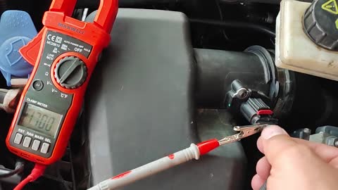

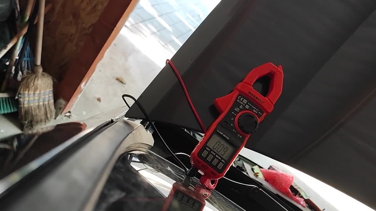

Hi. If I unplug the MAF sensor connector, 5v can be measured on the signal line. According to Autodata, there should be 0 Volts in this case. If I reconnect it, 1.77 volts are displayed on the signal wire when the ignition is turned on. the 5-volt sensor supply drops from 5 volts to 2.57 volts with the engine running, the voltage of the signal line rises to 2.1 volts at full throttle. The MAF sensor has 4 wires. Signal - 12 Volt supply - ground - 5 Volt sensor supply
Wire break? ECU problem? Connection error?
Thank you

I forgot to write that the sensor is new. and there is voltage on the signal line even when the connector is disconnected. (5 Volts)

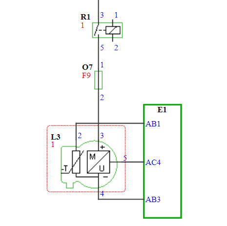

Hello
Pin out at MAF sensor(4 wire)
Pin 1, not occupied
Pin 2, grey/orange wire IAT signal to ECM pin AB1
Pin 3, violet/grey wire 12V MAF supply from fuse F9
Pin 4, blue wire ground to ECM pin AB3
Pin 5, yellow/violet wire MAF signal to ECM pin AC4
The MAF sensor incorporates the IAT(Intake Air temperature sensor)
With MAF disconnected and ignition on you should see between 4.8-5.2V on pin 2
If voltage is not ok next measure the voltage at pin AB1 at the ECM(Engine Control Module)
If voltage at ECM is in order next check the grey/orange pin to pin.
Expect to see less than 2 ohm resistance
This can be done using a voltmeter
How to use a voltmeter
How to check wire

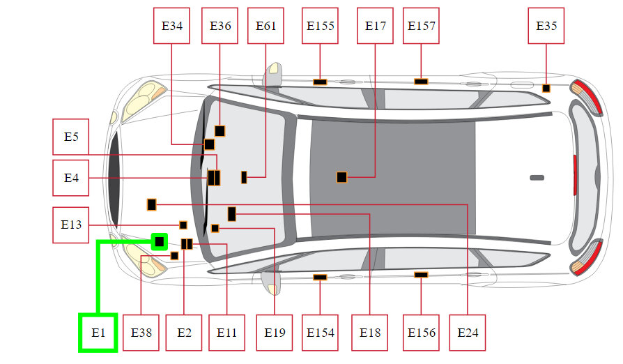

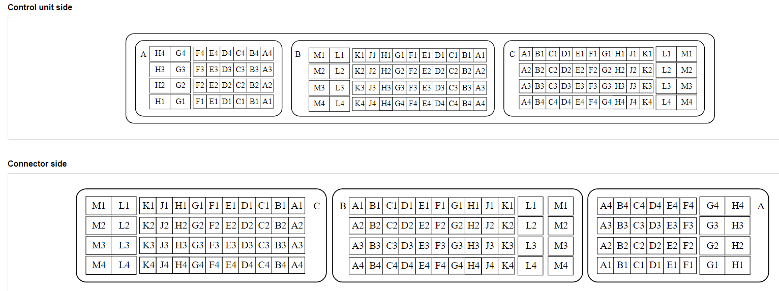

There are 3 connectors on ECM, A-B-C
The pins are on connector A, small
The ECM is located in the engine compartment, left front
See image 3
Cheers, Boris

GéZA KOVáCS
  • 26 POSTS

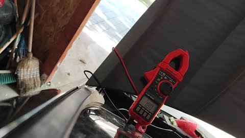

I measured the 3 wires from the MAF to the ECU (resistance), it showed 1-2 ohms. The resistance of pin2 and pin5 was 25k ohm. 21k ohms between pin2 and IAT. Is it possible that these wires are in contact with each other?
Aug 30, 2023 at 3:48 AM
BORIS K
  • 836 POSTS
Did you measure these resistance value when measuring into the MAF?
These values sound plausible as they would have internal connection in the MAF.
Cheers, Boris
Aug 31, 2023 at 2:31 AM

No, I measured it when the wire was disconnected from the MAF and connected to the ECU.
Aug 31, 2023 at 3:57 AM

What I don't understand is that when the wire is disconnected from the MAF, why is there 5V on both pin2 and pin5? If it is connected, then pin2 is 2.57Volt, pin5 1.77Volt. In my first article, I wrote the voltage of the two wires interchangeably.

BORIS K
  • 836 POSTS
First back to basics.
What fault codes do you read using a suitable scan tool?
Next
Pin 2 is the signal wire for the IAT resistor. This will be a 5V supply when not connected.
Pin 5 is the signal wire for the MAF signal, this usually is a 5V reference voltage from the ECM when not connected.
When connected you are then reading a reduced voltage caused by the internal resistance of either sensor.
Suggest to disconnect ECM connector and MAF connector.
Check that neither wire has any voltage with ignition on.
Check each wire pin to pin for any resistance issues, you should get less than 2ohm when measured pin to pin.
Also check that neither wire has any continuity to any other wire.
This can be done using a voltmeter.
A good guide on testing MAF sensor output using live data from a suitable scan tool:
https://www.alldata.com/sites/default/files/file-attachments/maf_sensor_testing_110918.pdf
Cheers, Boris

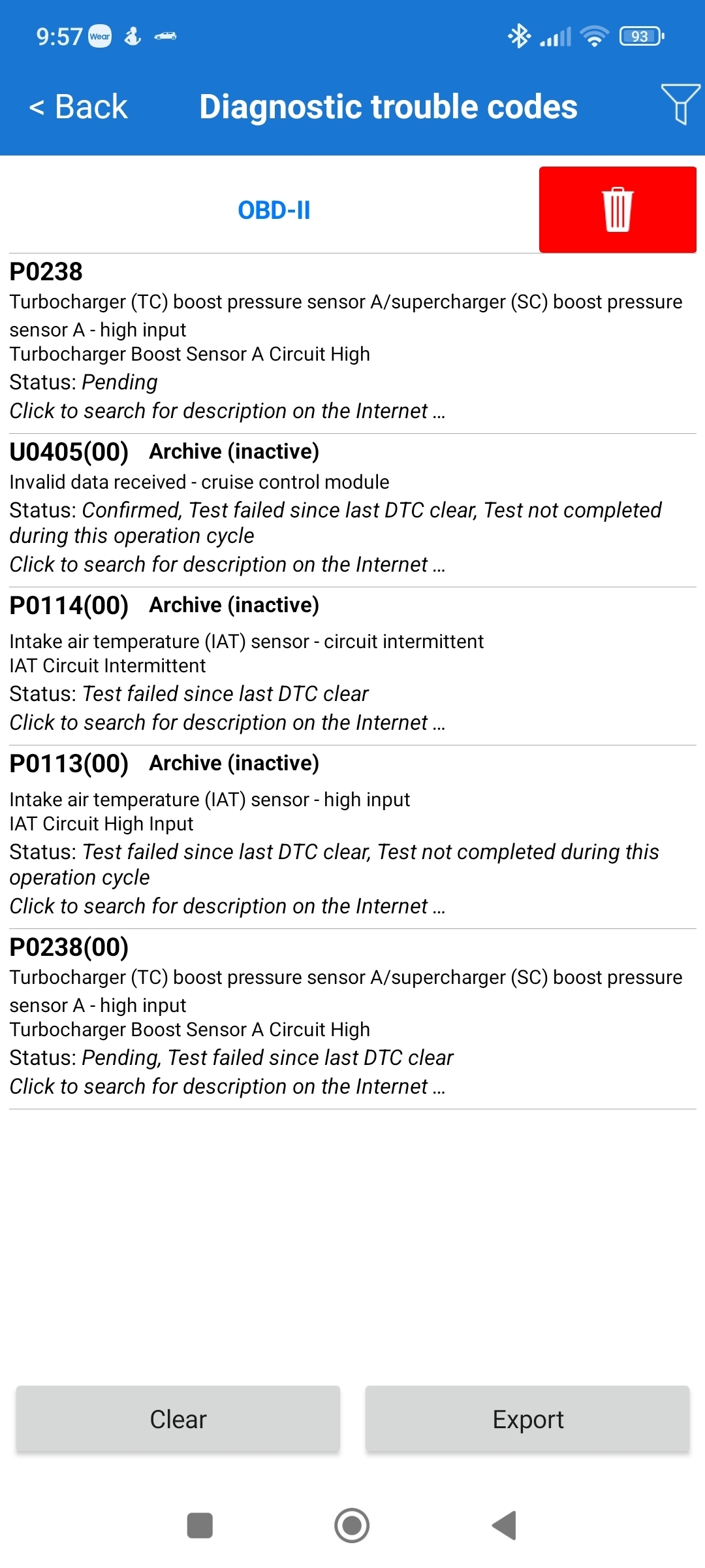

GéZA KOVáCS
  • 26 POSTS

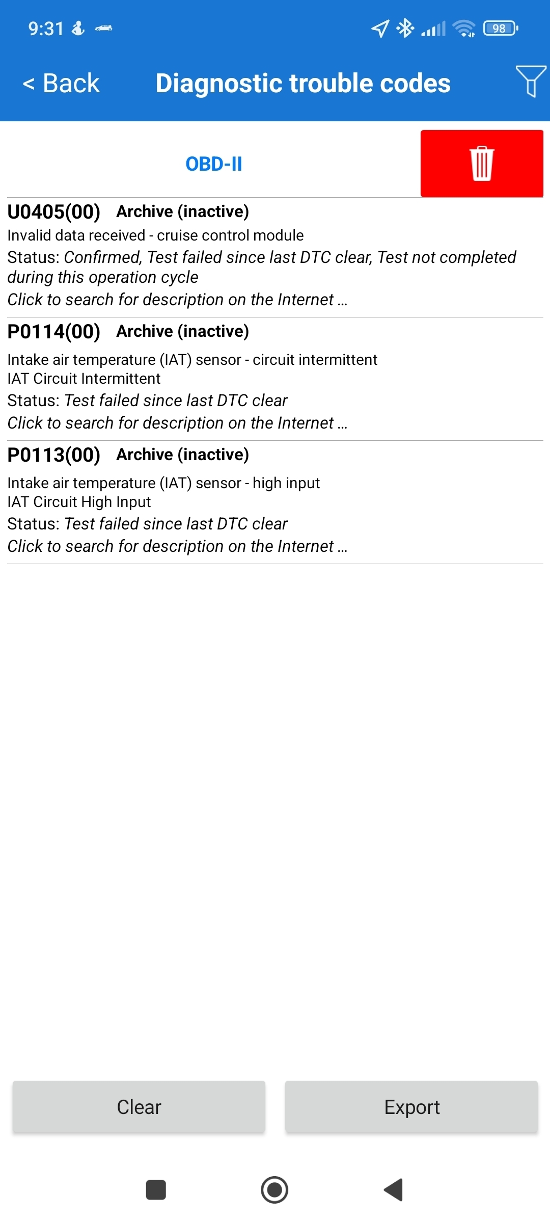

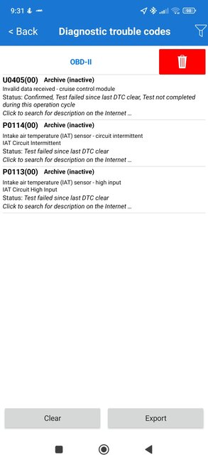

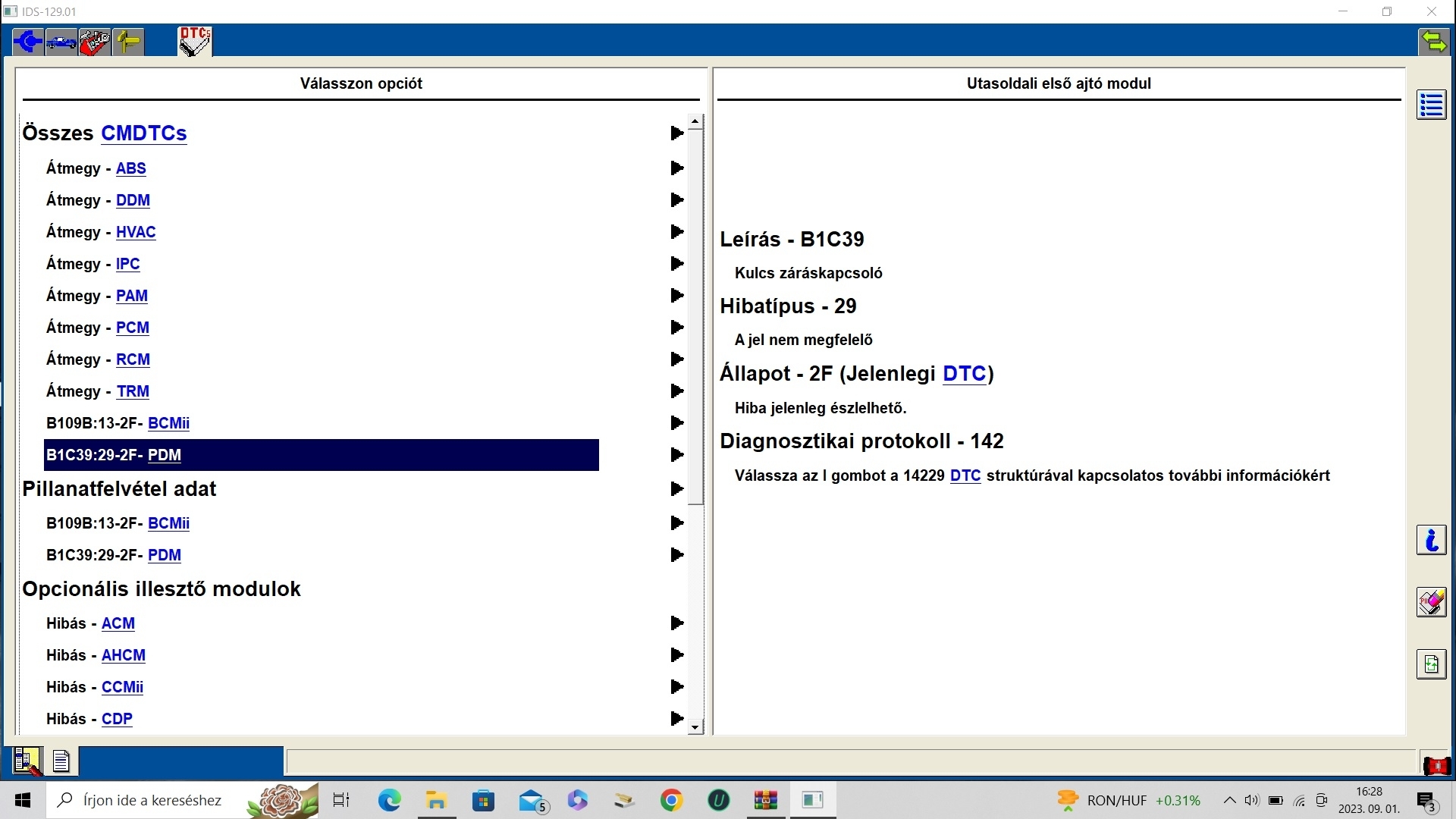

two error codes are written by the diagnostics (with VCX nano,ids software).
Sep 1, 2023 at 12:47 AM
GéZA KOVáCS
  • 26 POSTS
the resistance of the wires was below 2 ohms and there was no continuity in relation to each other.
Sep 1, 2023 at 12:50 AM
BORIS K
  • 836 POSTS
None of these fault codes are engine related.
BCM - Body Control Module
PDM - Passenger Door Module
What makes you think that there is a problem with the engine management system?
Do you have running issues?

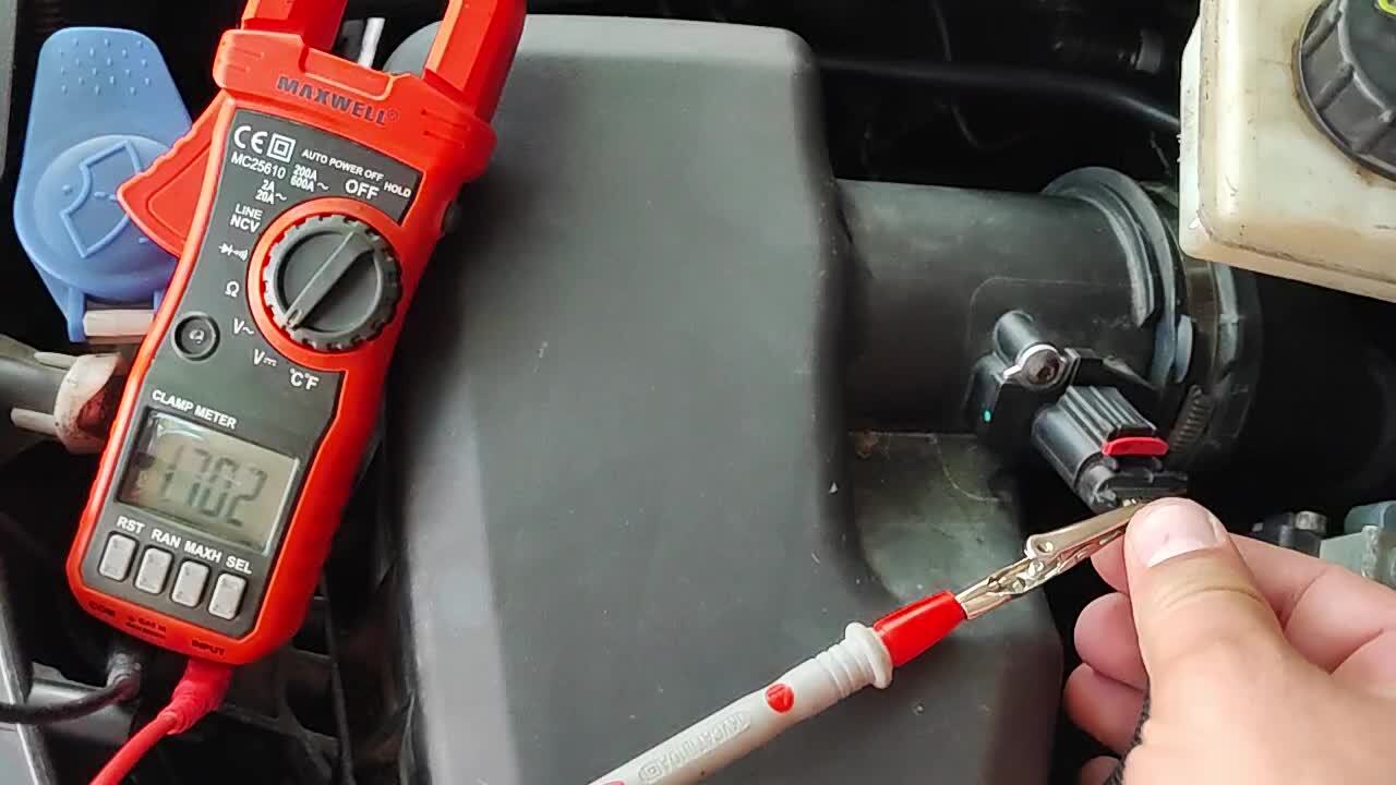

GéZA KOVáCS
  • 26 POSTS

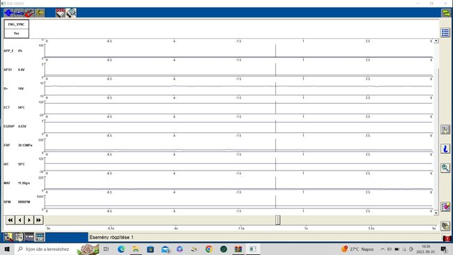

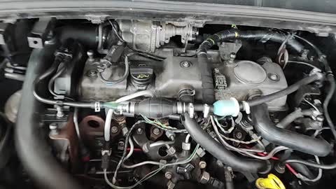

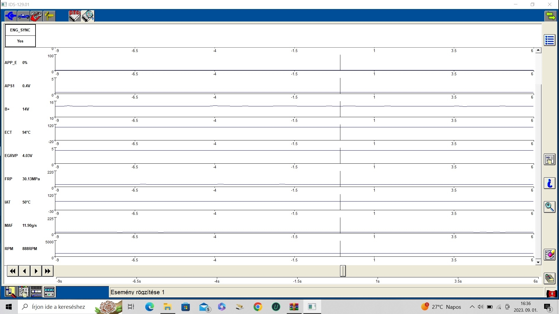

Having startup problems after several hours of idle time. It is hard to start, when it starts, it stops immediately. After 4-6 starts, it does not stop. One day the power went out, it wouldn't accelerate even though I stepped on the pedal, after a while the power came back. The turbocharger already emits a "whooshing" sound above 2000 rpm, there is also a little oil under the blade in the housing.
The ones that were bad were replaced - injector, high pressure pump, glow plugs,leak off pipe, fuel filter, pipes and connectors. + hand pump - many people said that it gets air - but then why does it start once for the first time and sometimes after several attempts. e.g. I cleaned the intake manifold, put it back together - I even took out the fuel filter housing - and it started in first gear. it didn't start anymore, just a few times.....
Sep 1, 2023 at 1:33 AM
BORIS K
  • 836 POSTS
Looking at the video you are back probing pin 5 which is the signal wire for the MAF.
A virtually static voltage of around 2.11V.
On live data, the previous post the air mass was at 11g/sec, which seems a bit low.

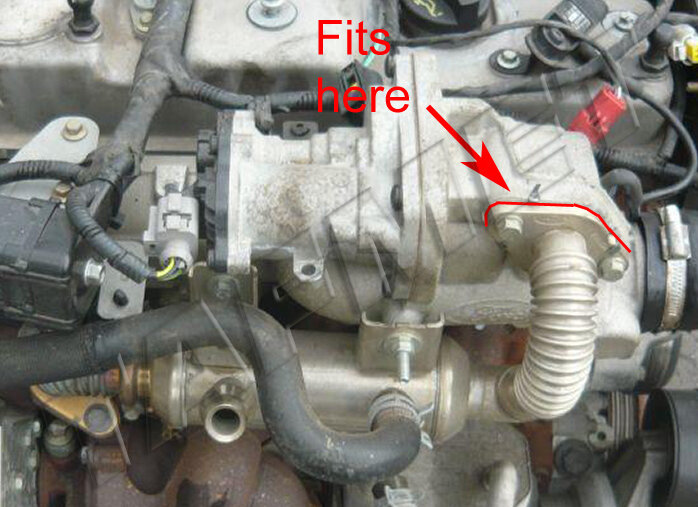

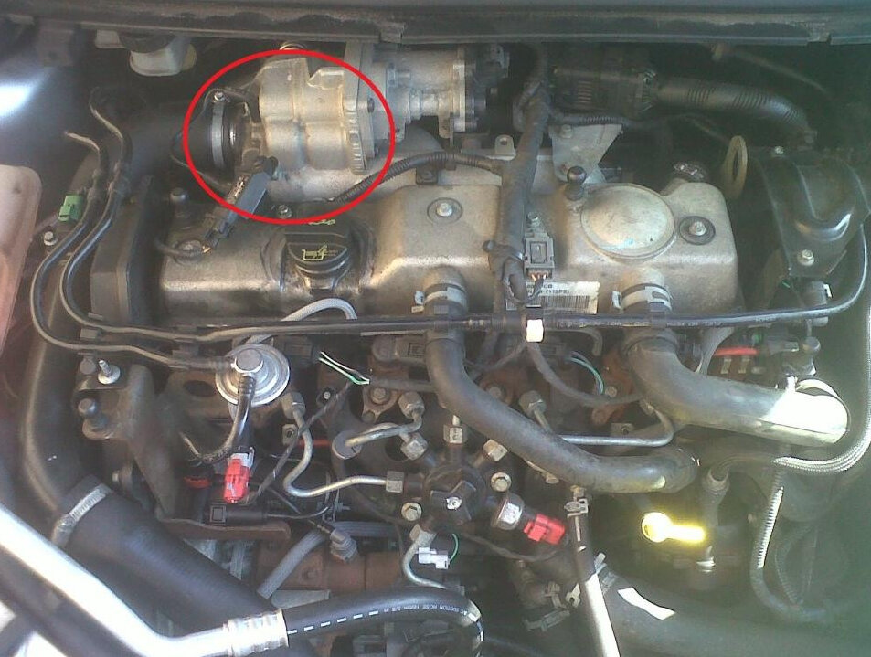

Have you checked the operation of the EGR valve? Not blocked and moving freely.
Another option would be to blank the EGR valve for testing purposes.
See image 1+2 below.
An eBay link:
https://www.ebay.co.uk/itm/121106889703
Cranking and non-starting on a diesel can be caused by a stuck open EGR valve.
Another aspect to check when vehicle is non start is the fuel rail pressure, ensure that while cranking the rail pressure is more than 200bar in live data. The ECM will not trigger the injectors if the rail pressure is below this value.
Cheers, Boris
Sep 2, 2023 at 6:06 PM
GéZA KOVáCS
  • 26 POSTS
yes, the EGR is blanked. The rail pressure is more than 200 bar. "Air mass 11g/s at idle". Still not enough?

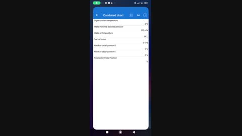

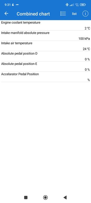

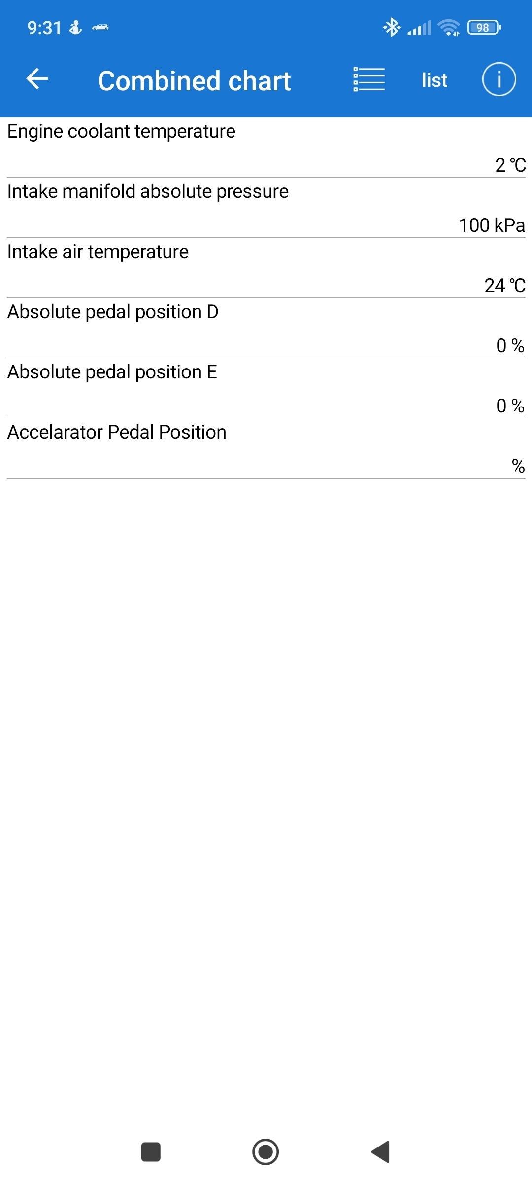

can't a faulty MAP sensor produce such a symptom? Or IAT sensor?
Sep 3, 2023 at 6:19 AM
BORIS K
  • 836 POSTS
A faulty MAP/Boost pressure sensor can cause all sorts of issues.
Check the sensor in live data.
Ignition on/engine off you should see ambient pressure, about 1000 mbar.
Engine idling the reading is usually slightly lower, around 920-950 mbar as there is no turbo boost at idle.
A faulty temperature sensor can cause starting and running issues.
The easiest way to check these sensors, IAT and ECT, is to check live data when the engine is cold.
Ideally stood over night. The live data values should equal ambient temperature.
Cheers, Boris

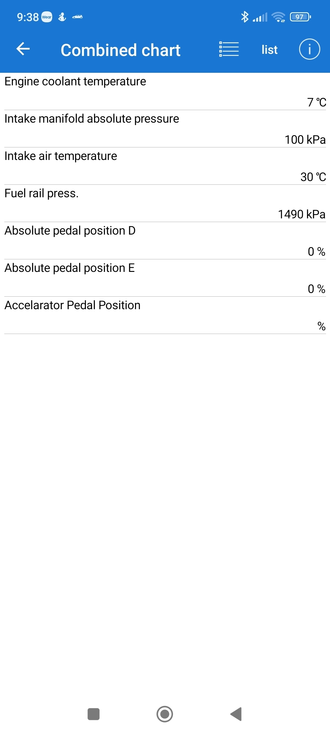

I watched it live data. I'm attaching pictures and video.The ECT is new. At idle pressure is 100kPa. (Is the IAT measured by the MAF or the IAT? because I disconnected the IAT and it didn't change intake air temp., but when I disconnected the MAF it showed 0°C on the intake air temperature)

The IAT sensor is part of the MAF, pins 2+4
Watching the video, the starting behavior is as if the glow plugs are not being activated.
As soon as there is a bit of combustion temperature the engine starts well.

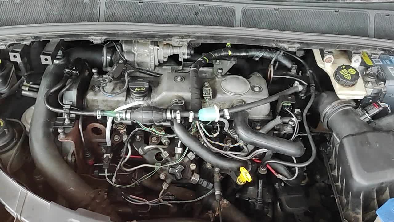

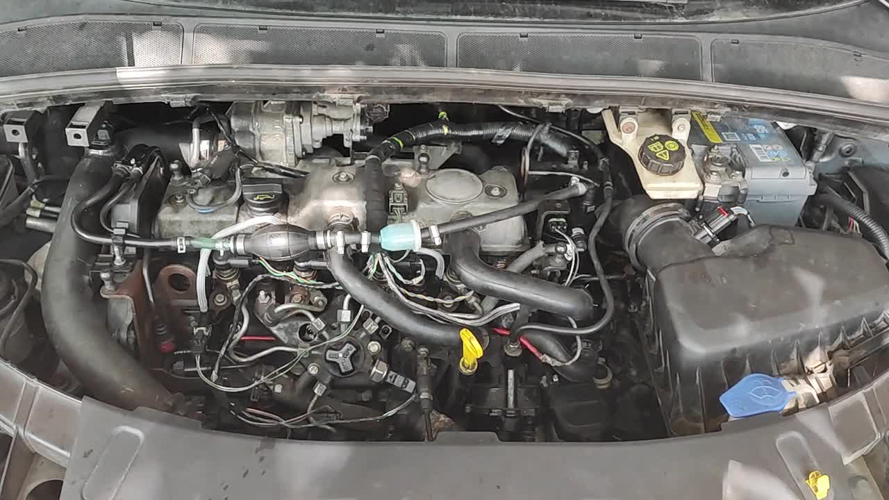

The other thing you could try is to spray some Quick or Easy start into the intake and see if the starting behavior changes.
Also, as the engine fuel supply relies purely on vacuum suction to get the fuel from the tank to the high-pressure pump, you could try and bypass the fuel supply system.
Install a small, 2-5L, container filled with clean diesel at the high-pressure pump and run a clean rubber tube directly to the pump inlet. The pump will then suck directly from this container. If the starting improves then this would prove that we are having a possible vacuum leak from the supply side.
Have you carried out an injector leak off test?
How to:
https://youtu.be/U2ek-FwoT5w?si=QOPQIllW9q1vMcwY
Cheers, Boris

GéZA KOVáCS
  • 26 POSTS
One of the injectors is new, the other 3 have been tested for a few thousand km, with a report, and the high-pressure pump has been refurbished. The fuel pipes in the engine compartment are new, as are the connectors and seals.
Sep 6, 2023 at 2:17 AM
BORIS K
  • 836 POSTS
I am just giving possible causes of hard starting for a diesel engine.
Suggestions to check certain components, if you are certain that these are in good condition then do not follow my suggestions.
A leak off test for the injectors will show if any require replacing, it is something you could do yourself, the equipment is inexpensive.
Cheers, Boris
