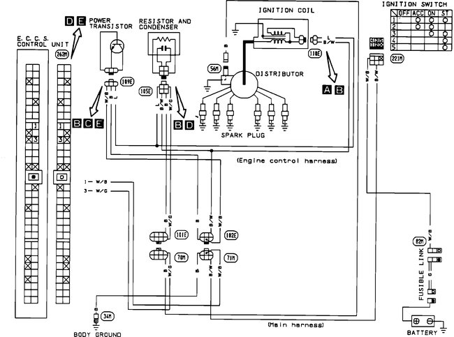

Okay Joe. I don't have a resistor up front by distributor. But I think the one on the side of the intake beside the coil might be the one. But I put the original ECM back on it, but haven't tried to start it. So I left the battery (-) disconnected. I was rushed so I didn't connect it. Will try it tonight. But I have two resistors just in case one do not work. Fingers crossed.
Thursday, February 7th, 2019 AT 6:24 AM
  • 109,936 POSTS
It indicates the transistor to be mounted in front of the distributor. Regardless, try without replacing the resistor first and see what happens.

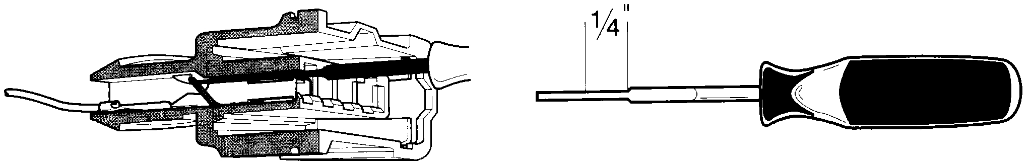

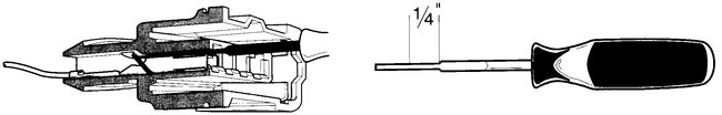

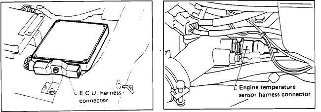

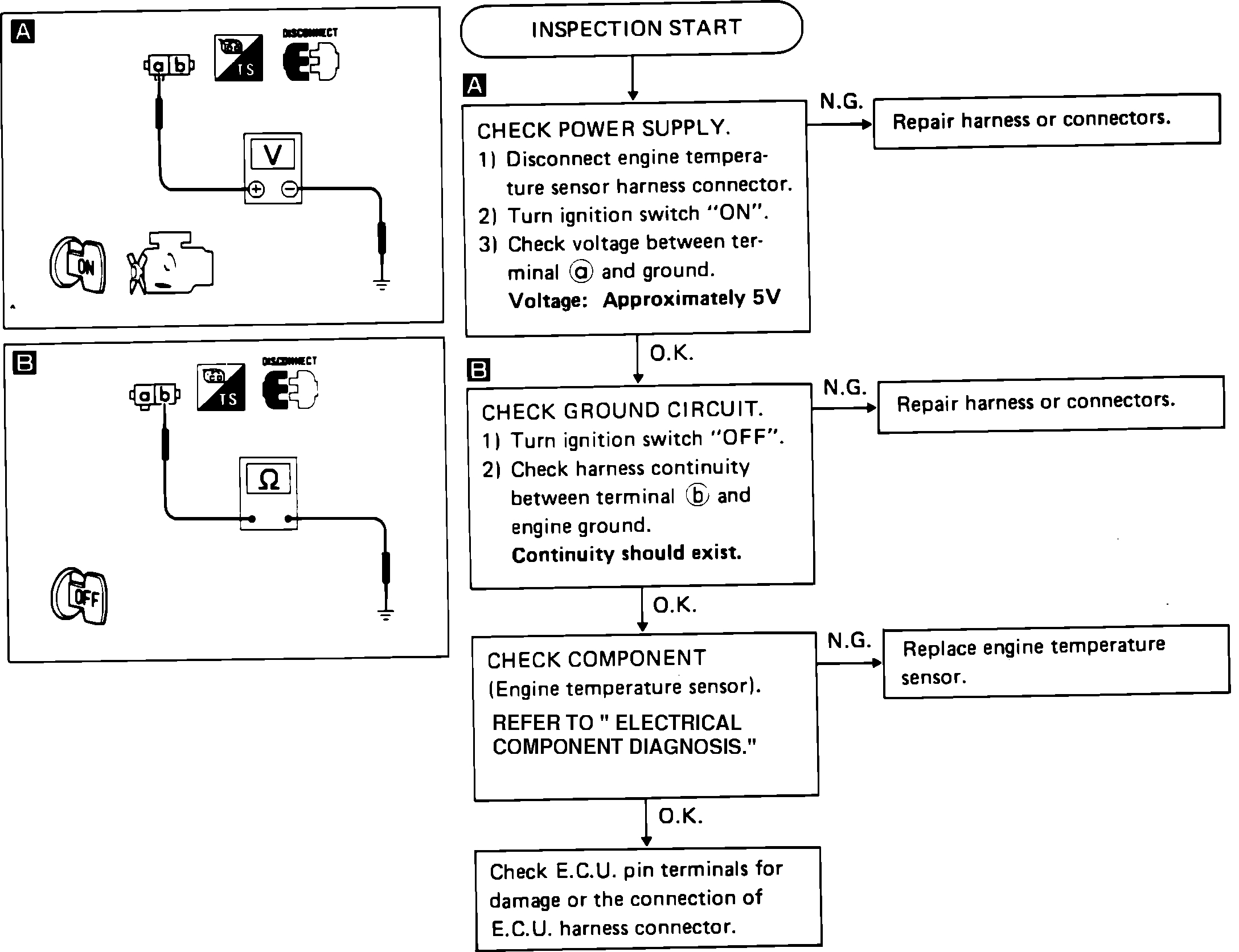

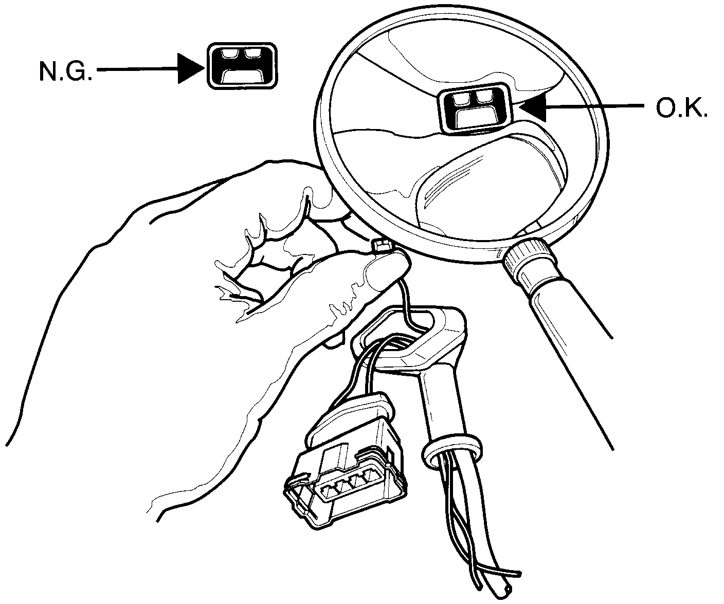

Interesting. It does sound like an issue. I just went through old records and there is a technical service bulletin related to the MAF and wiring. I wonder if you disconnecting and connecting is related to this bulletin. The bulletin indicates an issue with the plug on the MAF. Here are the test directions. The two pics attached correlate with these directions. The test is simple, so give it a try. I realize it deals with a code, 45, but anything is possible.
_______________________________________
MASS AIR FLOW SENSOR TEST
Note:
The best way to resolve a Code 45 or driveability incident is to carefully go through ALL the steps contained within this bulletin.
A POOR CONNECTION FOR EITHER THE MAFS GROUND OR SIGNAL WIRE CAN CAUSE A FALSE HIGH MAFS VOLTAGE READING, THIS WILL CAUSE A RICH MIXTURE.
NOTE:
All tests should be performed with the engine @ 2000 rpm. Engine temperature should be warm.
1. Gently move the MAFS harness and connector in all directions while observing the engine speed. If the engine speed or engine smoothness changes when the harness connector is moved, the incident may be caused by a poor connection at the connector pins.
2. Gently move the MAFS harness and connector in all directions while observing the ALPHA reading on CONSULT This reading should not change while wiggling the MAFS harness or connector.
If moving the MAFS harness causes a change in the ALPHA reading, then the harness/ connector must be repaired:
A. Disconnect the MAFS connector at the MAFS.
B. Inspect the male pins on the MAFS for corrosion or damage (clean and repair as necessary).
Pic 1
C. Remove, inspect, and reinstall ONE AT A TIME, the female pins at the MAFS harness connector. Carefully push the connector and wire out through the back side of the connector. Use a modified Kent-Moore tool J38751-305 (modify by increasing the length of the working end of the tool about 1/4" - this can be done with a grinder or file) Extract the individual pin by releasing the locking tab with the special tool through the recess on the component side of the connector. Inspect the contact surfaces of the pin for any corrosion or damage. The female pins contact force should be checked by sliding the female connector over the appropriate male pin on the MAFS and checking for a snug fit. The contact force can be increased by bending the contact springs toward each other slightly with an appropriate tool.
Pic 2
D. If any of the pins appear to be damaged, or if the wire is not properly crimped onto the female pin the terminal pin must be replaced. The terminal pin connector P/N is J38751-50. The wire seal P/N is J38751-48. Both parts are available in the Kent Moore terminal repair kit. Crimp and solder the new terminal pin on to the harness wire.
E. After all the female pins have been inspected/repaired, reattach the MAFS connector and perform tests 1 and 2 above to verify repair.
__________________________________________

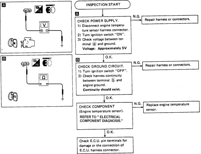

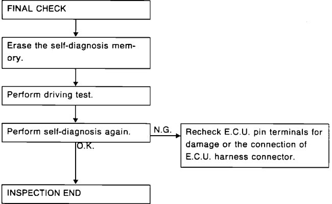

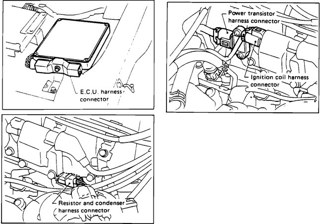

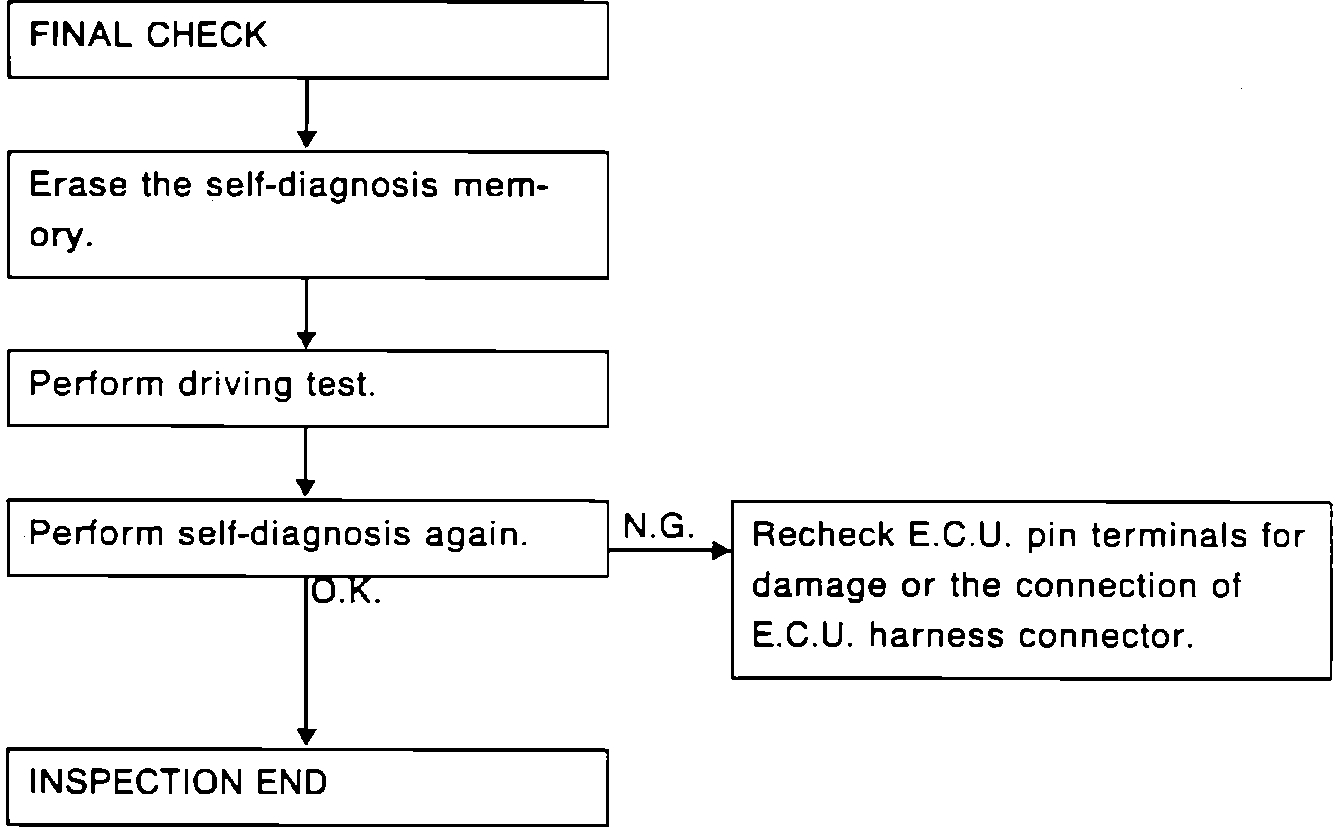

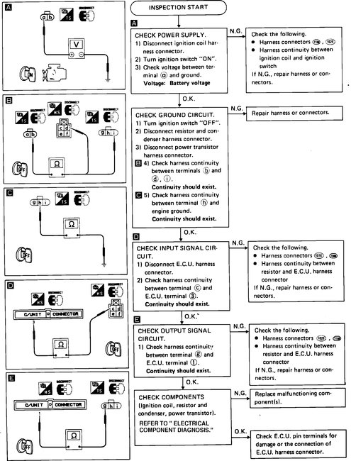

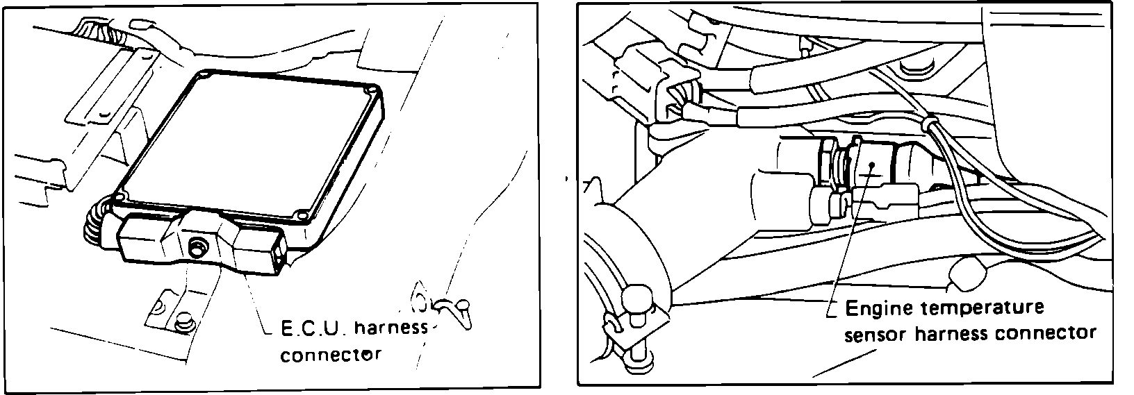

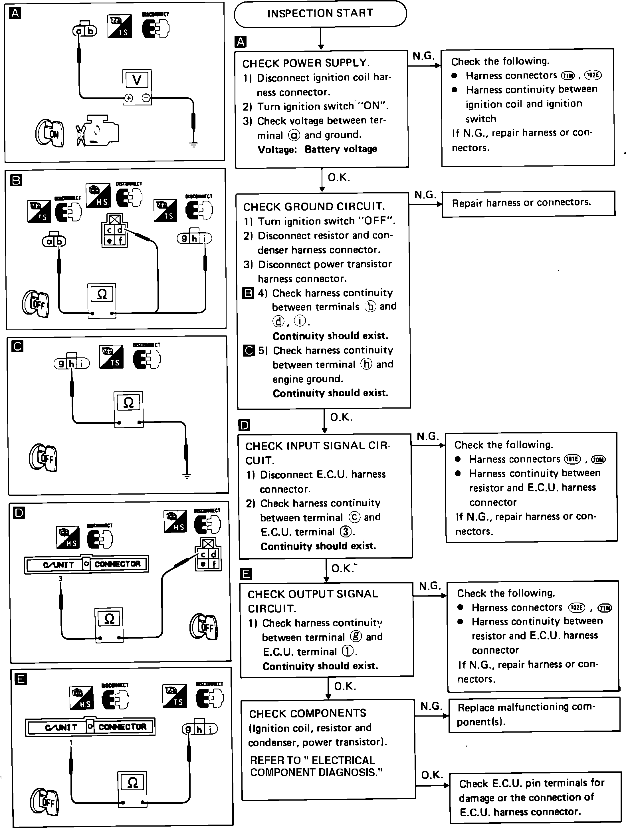

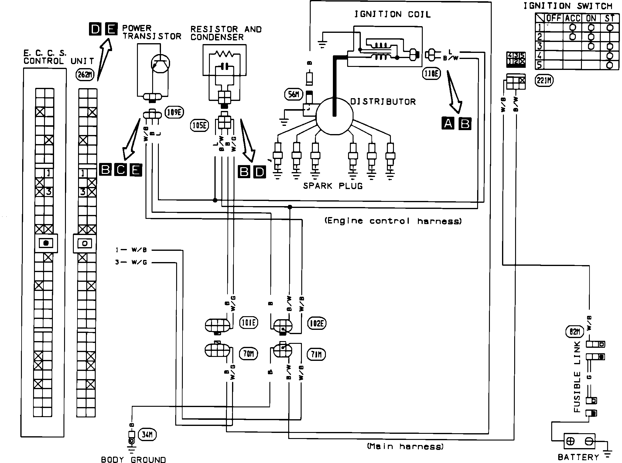

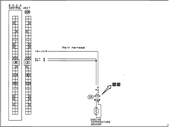

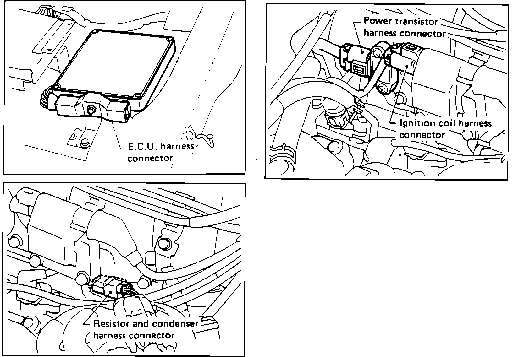

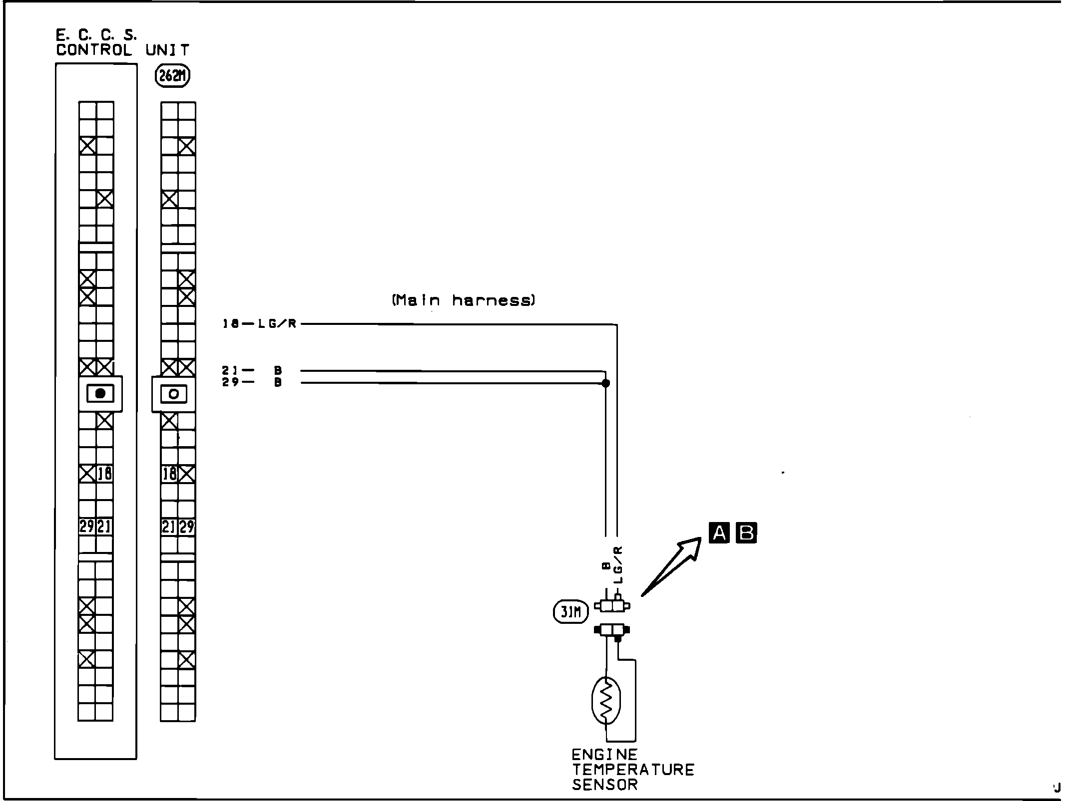

Also, pictures 3--6 are the diagnostic flow charts for code 21
Picture 7--10 are the diagnostic flow charts for code 13
I added them just in case the MAF doesn't fix the issue.
That is an easy test. Try it and let me know the results.
