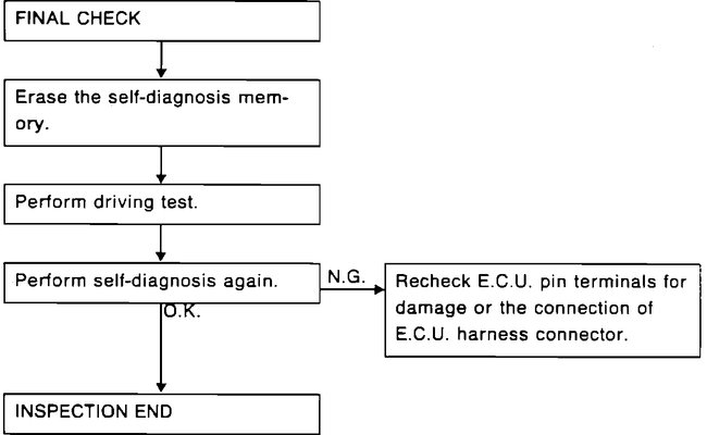

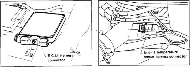

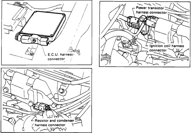

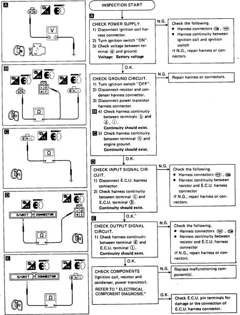

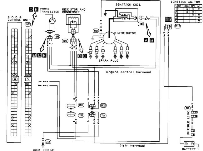

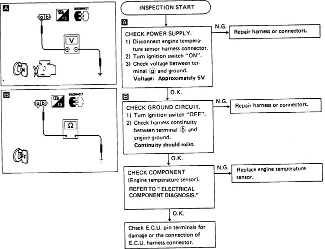

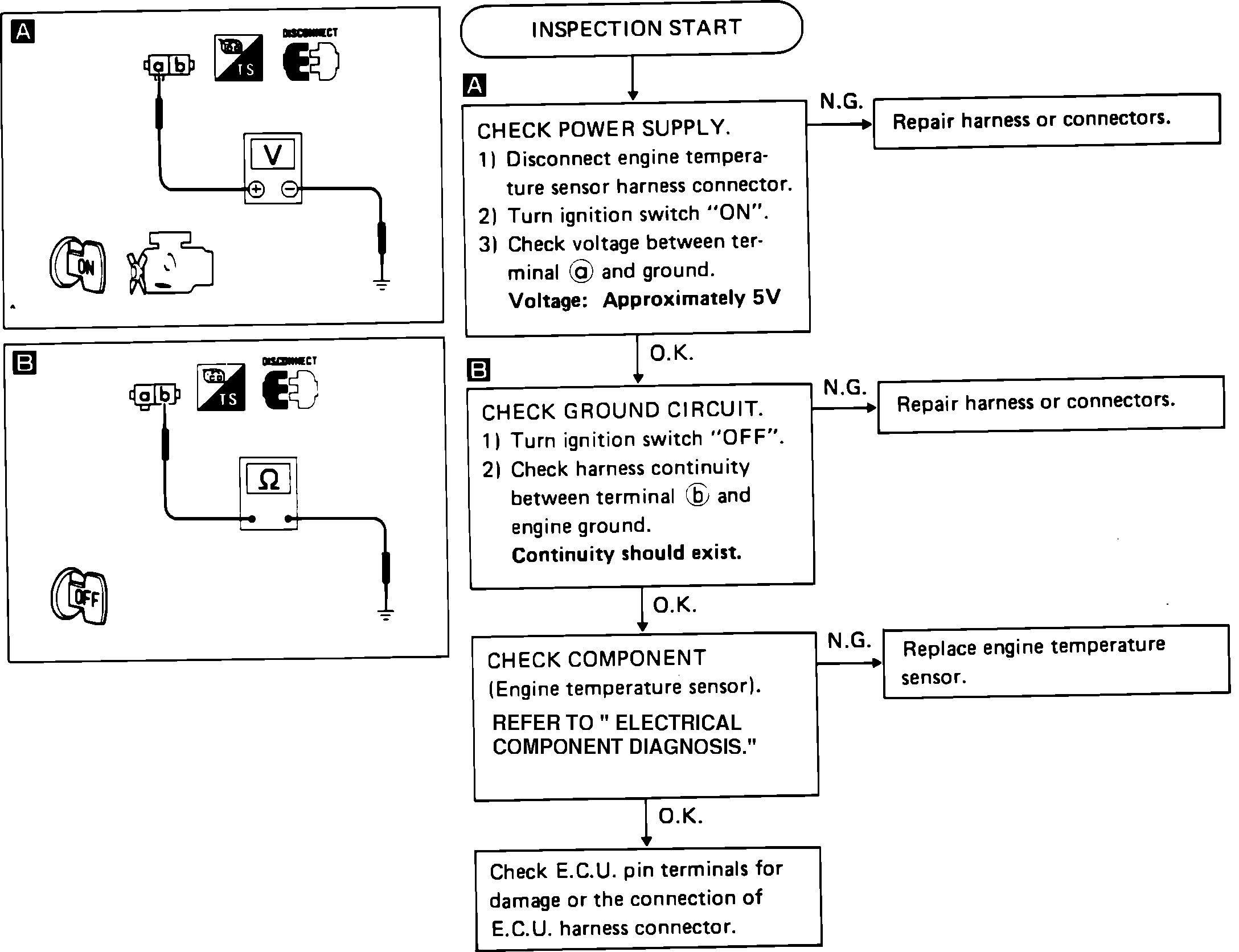

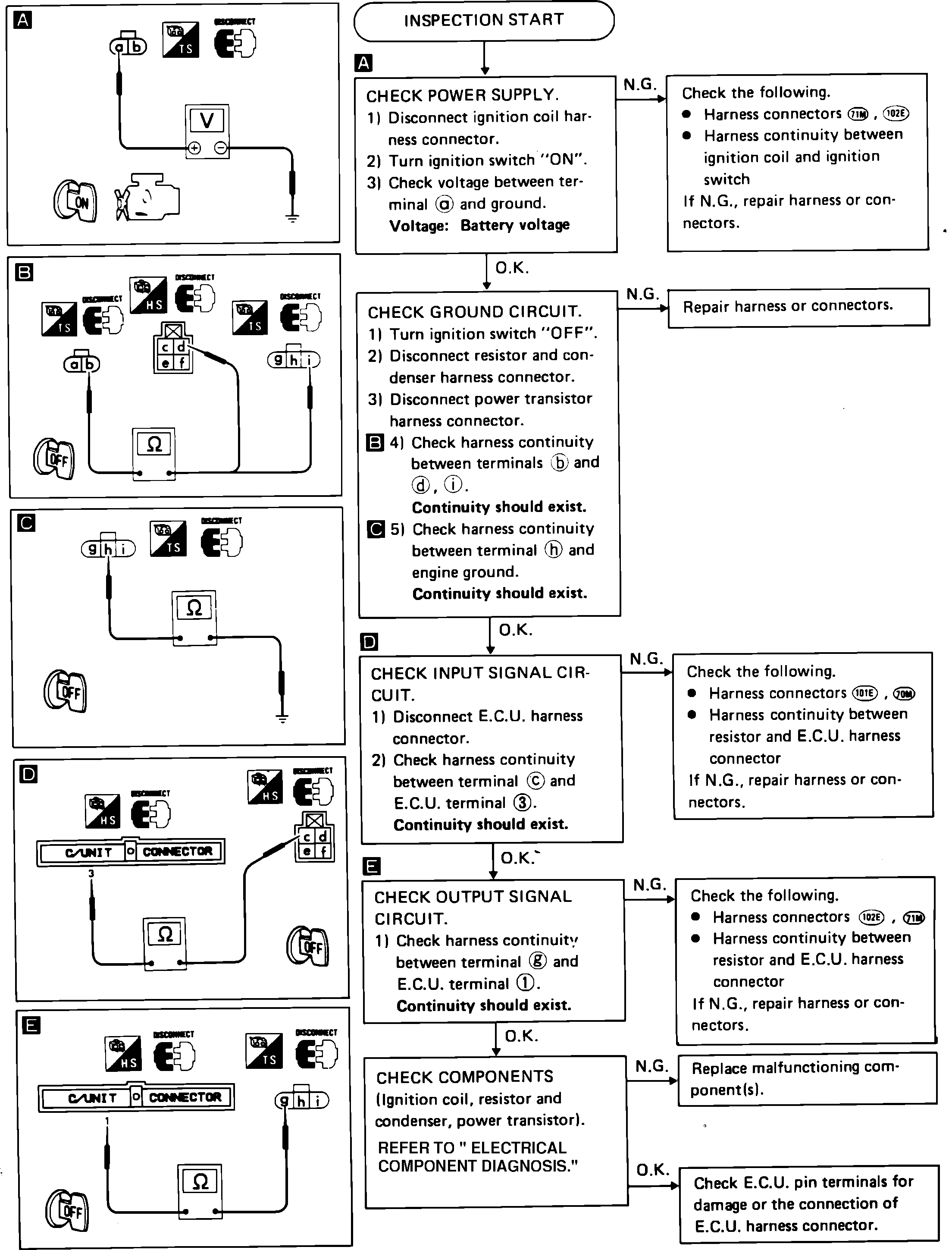

The two codes are really separate from each other. One deals with an ignition issue and the other a coolant temperature sensor, either of which can cause a rough idle.

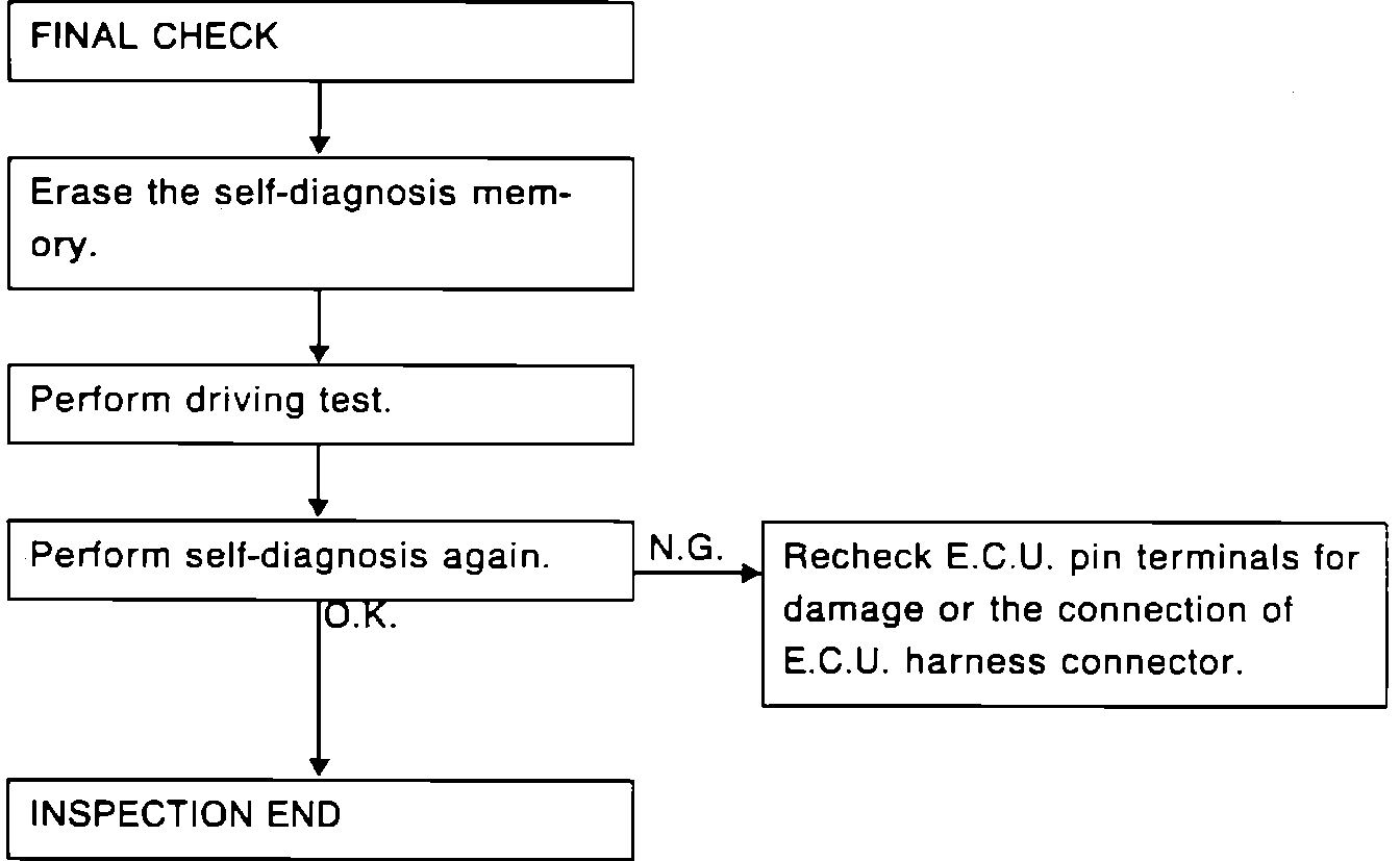

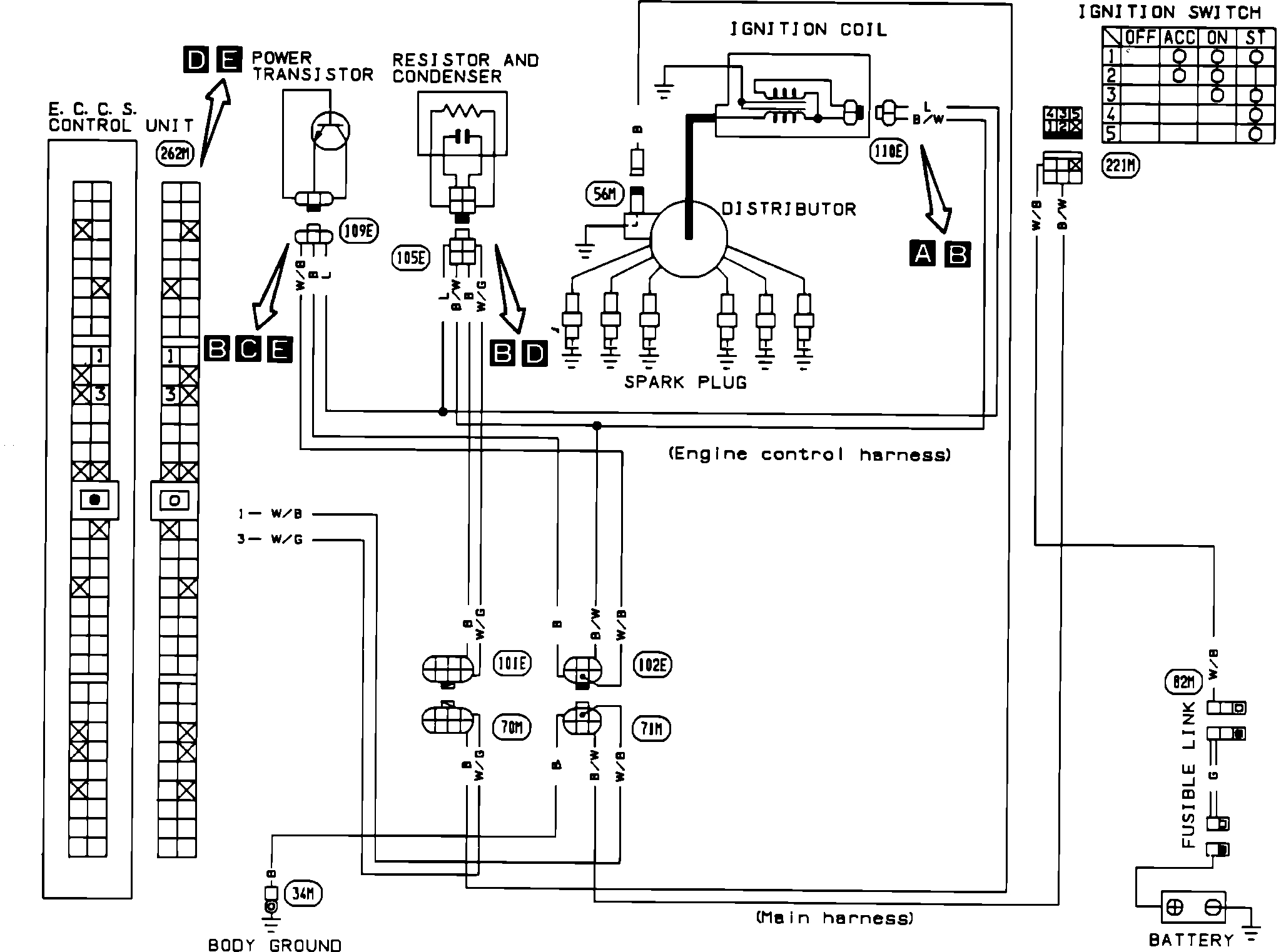

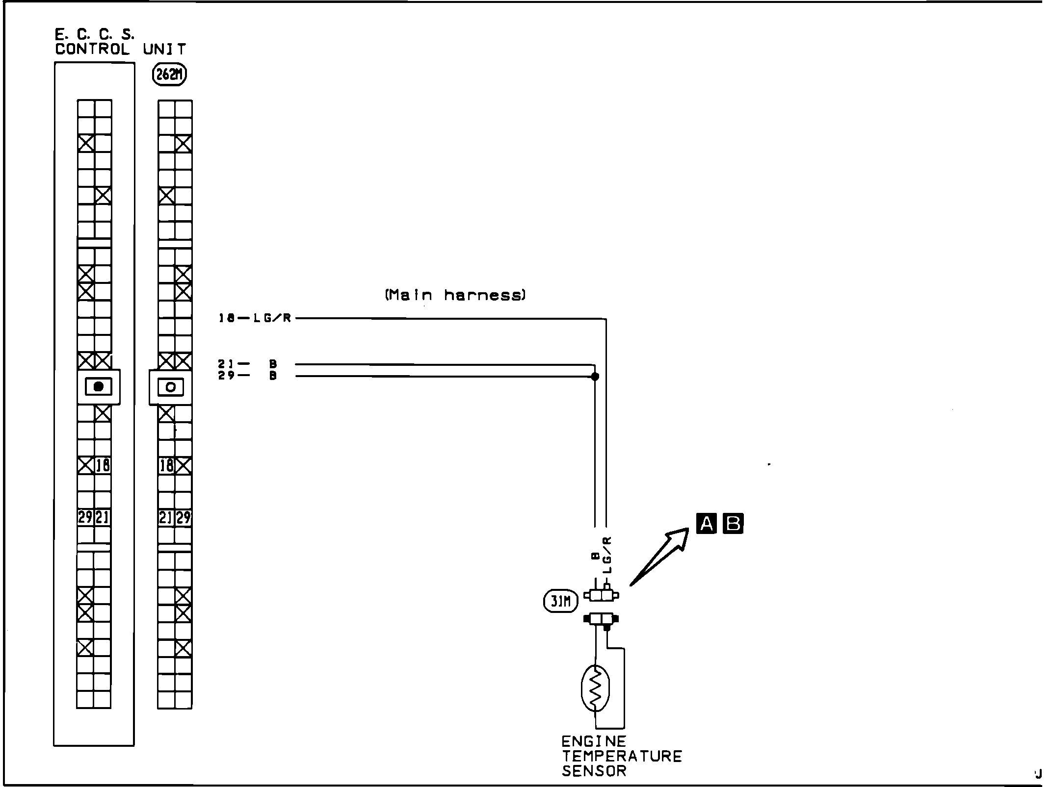

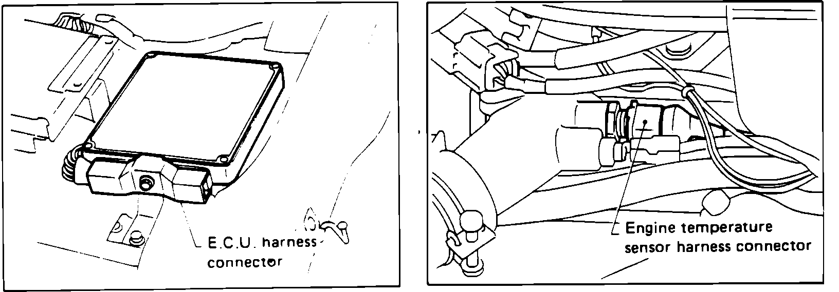

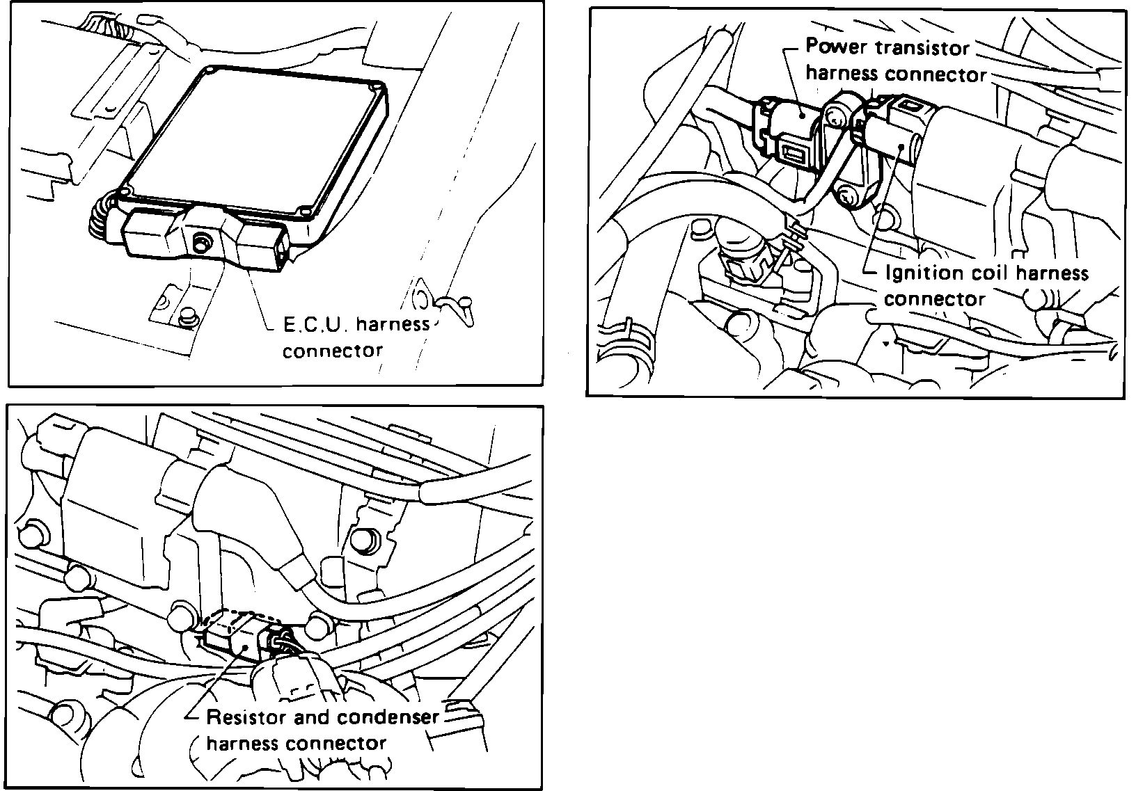

What I have done is attach the diagnostic flow charts for both conditions. However, I had to attach them in picture form. Read through them and see if they help. If there is something you can't read on them, let me know.
________________________________________
DTC 21
The ECU did not detect the ignition primary signal during starting or running.
Code 21 Ignition Signal Diagnostic Chart / See Pictures 1-4

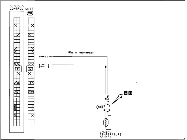

DTC 13
The ECU detected an open or shorted circuit. (An abnormally high or low output voltage is entered.)
Code 13 Engine Temperature Sensor Diagnostic Chart / See Pictures 5 - 8

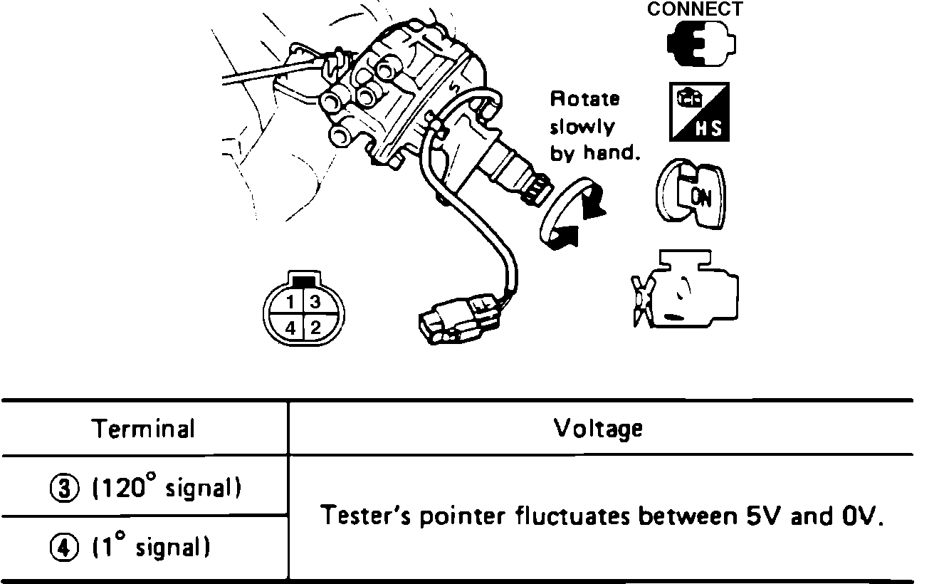

It almost sounds like a crank angle sensor. This one is in the distributor. Here are the tests for the sensor. Figured I would add them if you needed. That could tie into the DTC 21. Picture 1 correlates with these directions.
1. Leaving terminal connected, remove crank angle sensor.
2. Disconnect power transistor connector (to prevent electrical discharge from the ignition coil, avoiding possible electrical shock).
3. Turn ignition switch on.
4. Connect a volt meter between terminal 3 and ground.
5. Rotate shaft slowly and check for ON/OFF 5 volt signal.
6. Connect a volt meter between terminal 4 and ground.
7. Rotate shaft slowly and check for ON/OFF 5 volt signal.
8. Inspect rotor plate for damage or dust.
Replace the sensor if it fails the above tests.
Let me know what you find.

The second test was all good with the crank angle sensor. It was reading and when i turned it it moved up 5 or so on the ohms.and the other test b to d was in fact testing also. I cant get it to fire off though. The MAF has power going to it but cannot start it to check MAF. Why would it run, shut off and just turn over? Could it be the MAF is bad. Would that stop it from starting?
Feb 4, 2019 at 10:00 AM
  • 110,244 POSTS
Based on what you are saying, you checked it correctly and it sounds good. Tell me. Have you checked to see if it is getting spark?

Hi Robert,
Don't stress over a vehicle. Tomorrow will come if you worry or not, so hang in there. I think it may be a good idea to try the original ECM. Make sure to disconnect the battery prior to removal and replacement and don't connect the battery until after the ECM is connected.

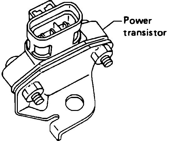

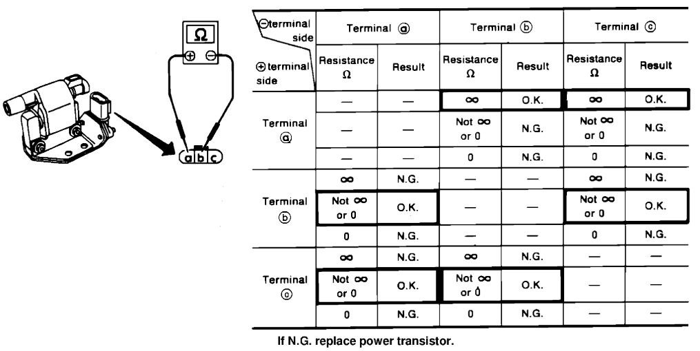

The only other thing I can think of is the power transistor. Here is a description of it and its function:
PURPOSE
Activates the primary circuit in the ignition coil.
LOCATION
On the intake manifold in front of the distributor
OPERATION
The power transistor is a low current switch. It allows the signal sent from the ECU (very low current) to activate the primary circuit in the ignition coil (much higher current). This induces high voltage in the secondary windings of the ignition coil, providing spark to the distributor cap and plugs.
Picture 1 shows what the transistor looks like.
To test the transistor, using an ohm meter, check for continuity between terminals as per the image 2 below.
Let me know if this helps. Wish I was there to help you out. We'll figure it out.

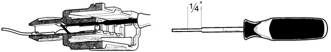

Interesting. It does sound like an issue. I just went through old records and there is a technical service bulletin related to the MAF and wiring. I wonder if you disconnecting and connecting is related to this bulletin. The bulletin indicates an issue with the plug on the MAF. Here are the test directions. The two pics attached correlate with these directions. The test is simple, so give it a try. I realize it deals with a code, 45, but anything is possible.
MASS AIR FLOW SENSOR TEST
Note:
The best way to resolve a Code 45 or driveability incident is to carefully go through ALL the steps contained within this bulletin.
A POOR CONNECTION FOR EITHER THE MAFS GROUND OR SIGNAL WIRE CAN CAUSE A FALSE HIGH MAFS VOLTAGE READING, THIS WILL CAUSE A RICH MIXTURE.
NOTE:
All tests should be performed with the engine @ 2000 rpm. Engine temperature should be warm.
1.Gently move the MAFS harness and connector in all directions while observing the engine speed. If the engine speed or engine smoothness changes when the harness connector is moved, the incident may be caused by a poor connection at the connector pins.
2.Gently move the MAFS harness and connector in all directions while observing the ALPHA reading on CONSULT This reading should not change while wiggling the MAFS harness or connector.
If moving the MAFS harness causes a change in the ALPHA reading, then the harness/ connector must be repaired:

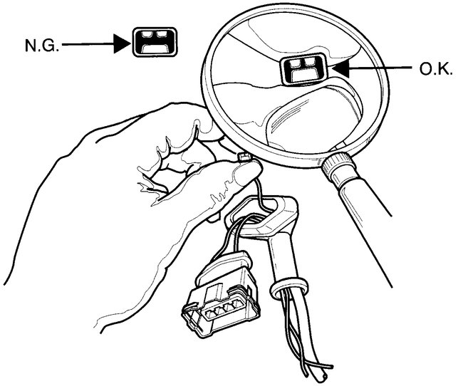

A. Disconnect the MAFS connector at the MAFS.
B. Inspect the male pins on the MAFS for corrosion or damage (clean and repair as necessary).
Pic 1
C. Remove, inspect, and reinstall ONE AT A TIME, the female pins at the MAFS harness connector. Carefully push the connector and wire out through the back side of the connector. Use a modified Kent-Moore tool J38751-305 (modify by increasing the length of the working end of the tool about 1/4" - this can be done with a grinder or file) Extract the individual pin by releasing the locking tab with the special tool through the recess on the component side of the connector. Inspect the contact surfaces of the pin for any corrosion or damage. The female pins contact force should be checked by sliding the female connector over the appropriate male pin on the MAFS and checking for a snug fit. The contact force can be increased by bending the contact springs toward each other slightly with an appropriate tool.
Pic 2
D. If any of the pins appear to be damaged, or if the wire is not properly crimped onto the female pin the terminal pin must be replaced. The terminal pin connector P/N is J38751-50. The wire seal P/N is J38751-48. Both parts are available in the Kent Moore terminal repair kit. Crimp and solder the new terminal pin on to the harness wire.
E. After all the female pins have been inspected/repaired, reattach the MAFS connector and perform tests 1 and 2 above to verify repair.
__________________________________________
Also, pictures 3--6 are the diagnostic flow charts for code 21
Picture 7--10 are the diagnostic flow charts for code 13
I added them just in case the MAF doesn't fix the issue.
That is an easy test. Try it and let me know the results.
