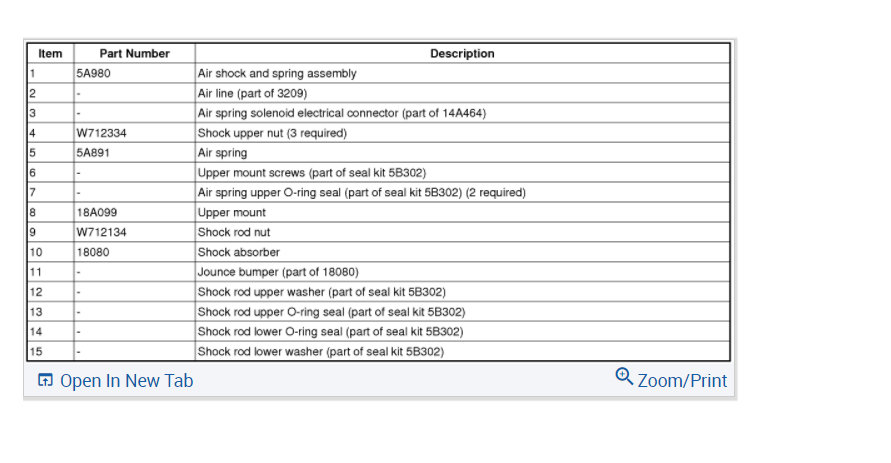

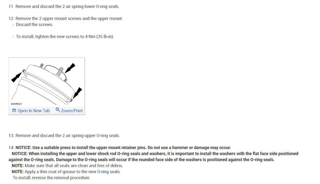

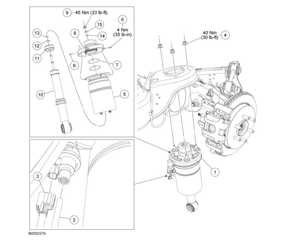

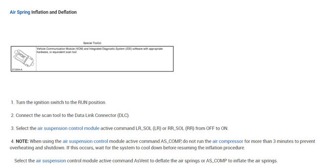

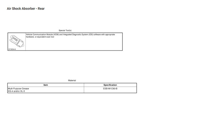

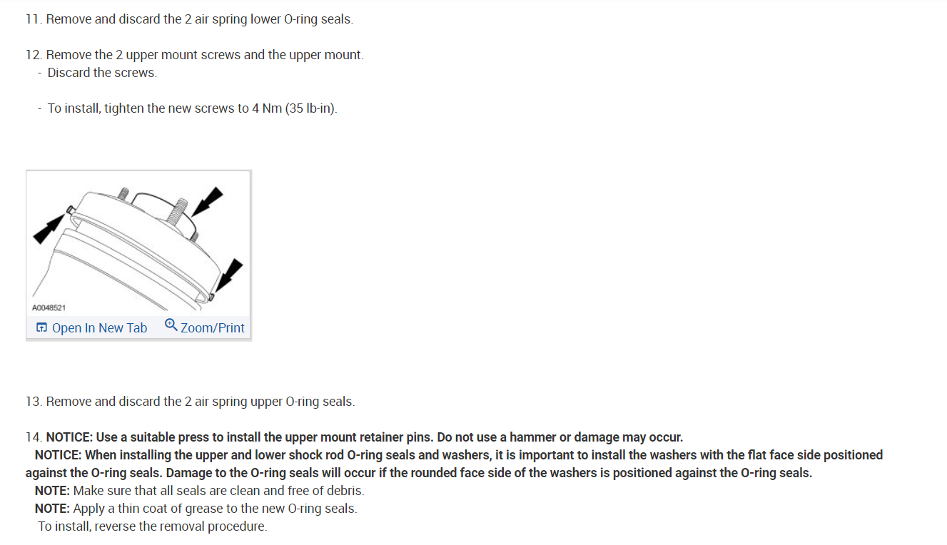

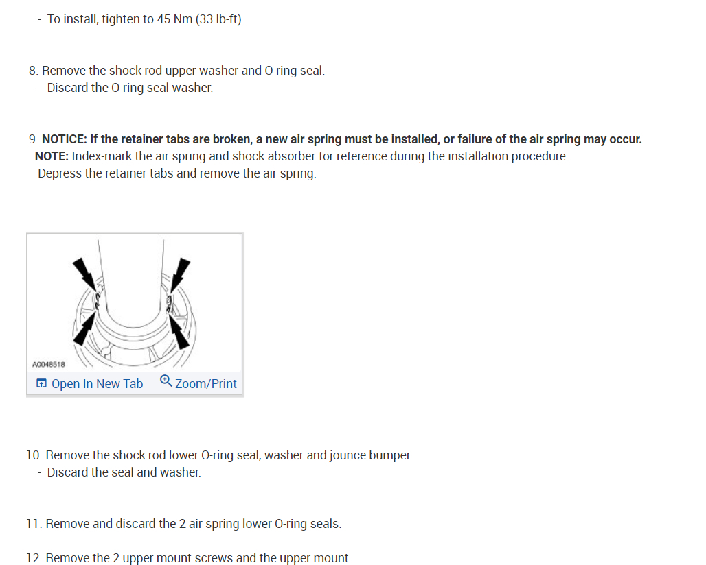

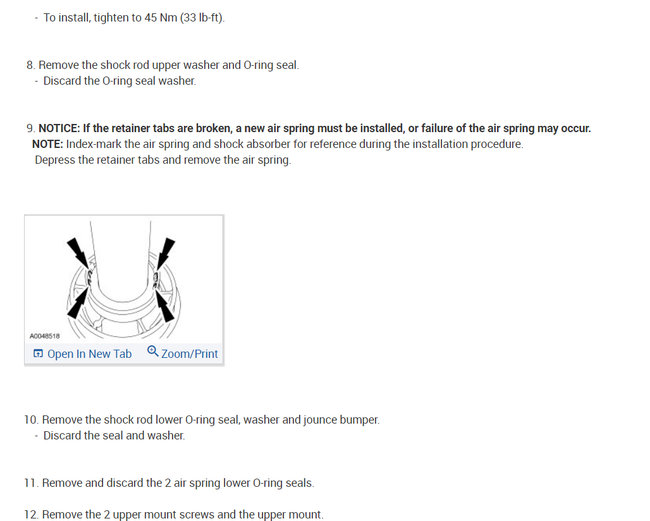

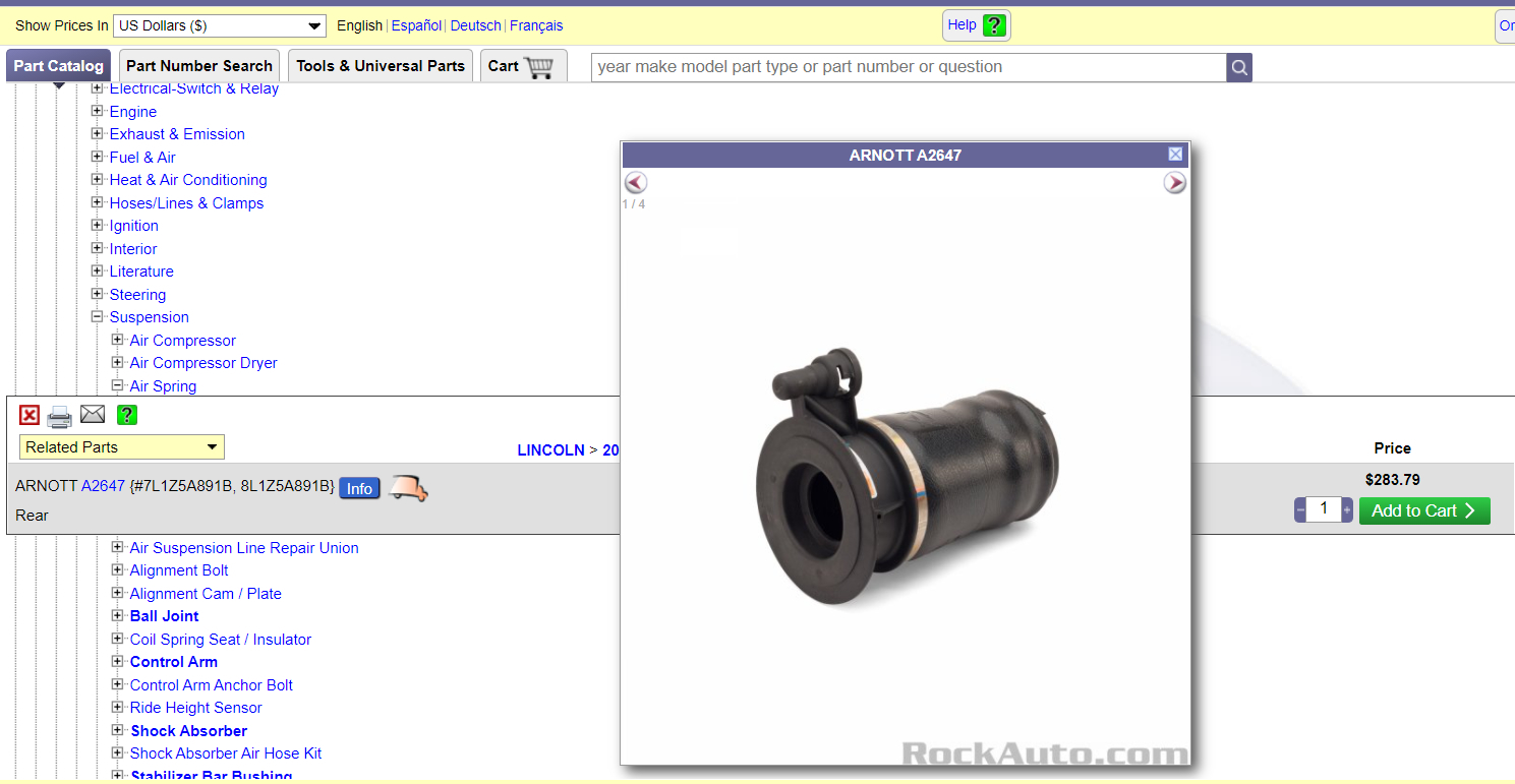

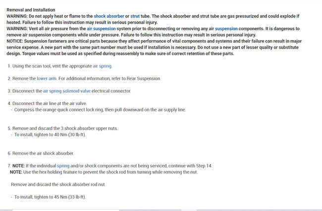

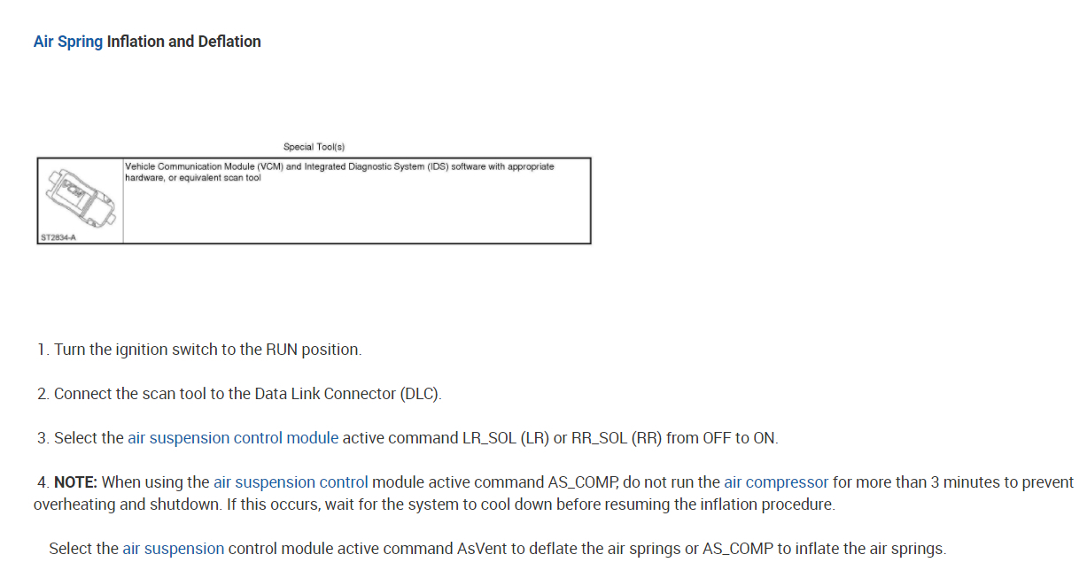

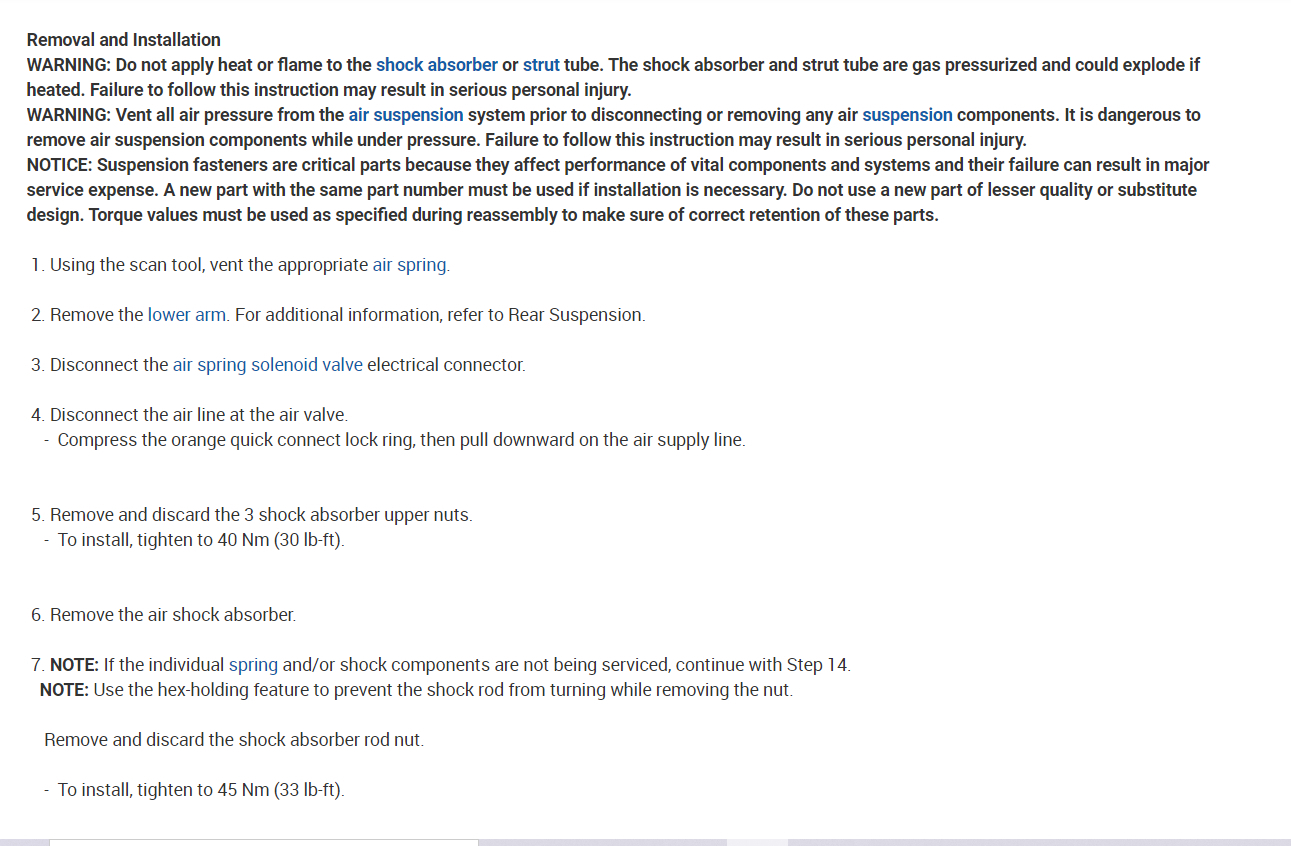

Good afternoon,
It does sound like one of the air springs is leaking under load.
I would replace both of them as when one starts to leak the other is close behind.
I attached the procedure for the replacement as well as the part available from Rock auto.
