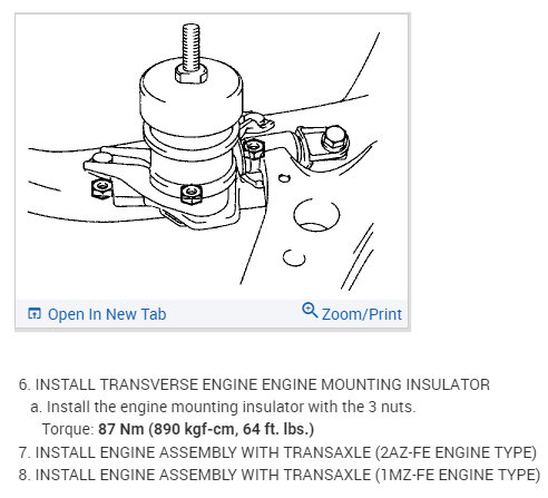

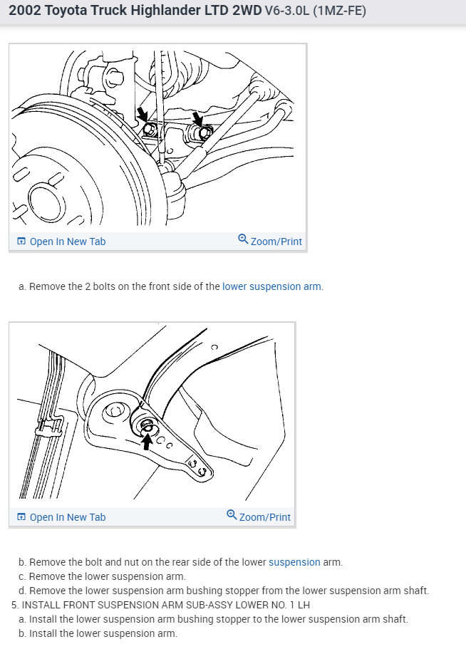

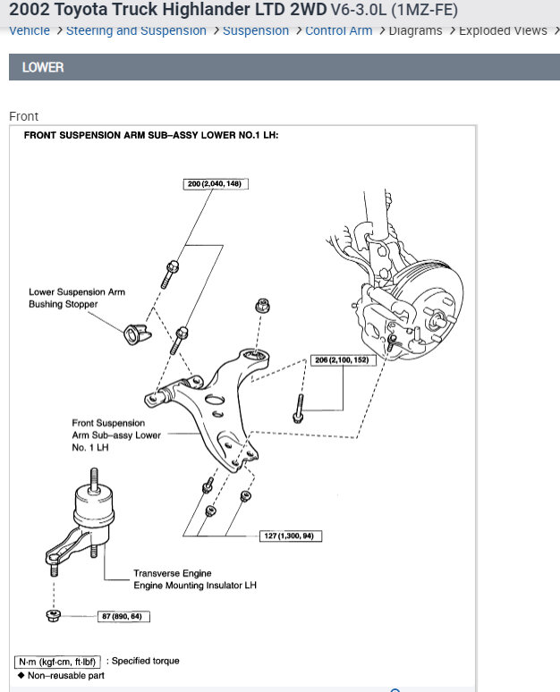

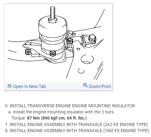

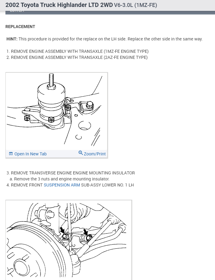

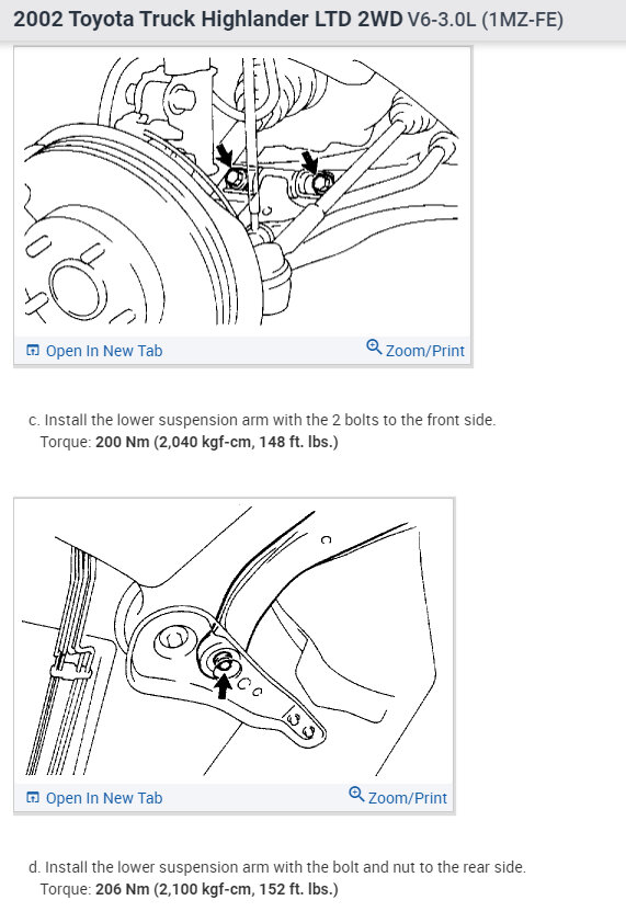

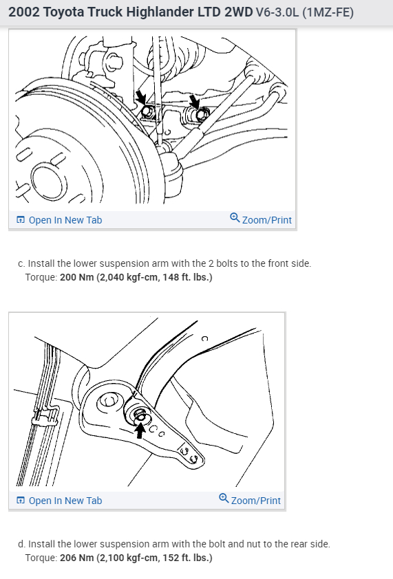

I'm refurbishing the vehicle listed above and now I'm replacing the lower control arms. I'm putting on new motor mounts while everything is apart too. I really like y'alls videos, very detailed and easy to follow. Wish y'all could do a video on control arm replacement. What would be the steps to do this job? Any advice or tips? I'm doing this in my driveway. Where would I place wood blocks to raise the engine to remove the mounts?
Thanks,
Ron
Oct 4, 2022 at 11:56 AM
SQM
  • 6,383 POSTS
See below for the lower control arm replacement procedure. It has all the torque specifications as well.
https://www.2carpros.com/articles/lower-control-arm-bushing-replacement
You should be able to lift the vehicle using the factory recommended lifting spot under the vehicle, below the front door on the frame.
Here is a helpful guide on best practices on lifting up the vehicle:
Let me know if you have any questions.
