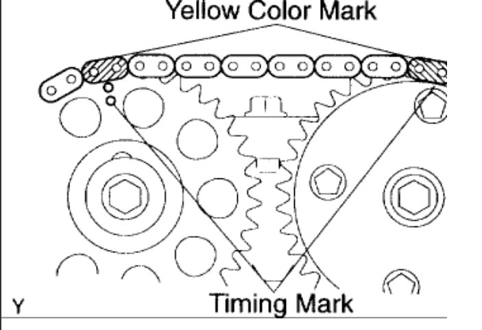

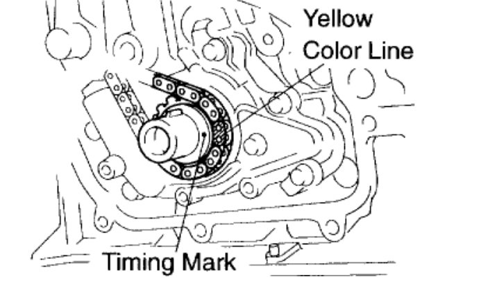

I work with a man that worked as a mechanic in the past, and he wondered if the timing chain has jumped a tooth because of the backfiring it does. Is this a possibility?
Thanks
Feb 13, 2018 at 3:49 AM
  • 55,433 POSTS

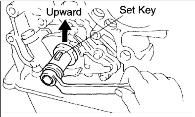

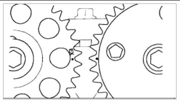

That is completely possible here is a diagram that shows the timing marks so you can double check them.
Please let us know
