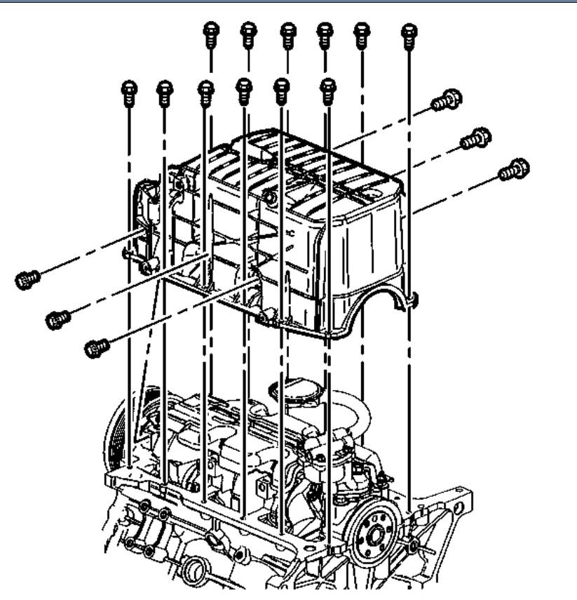

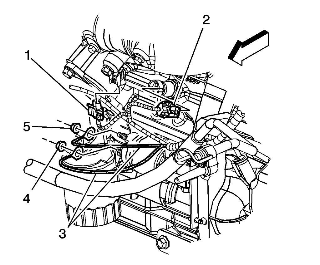

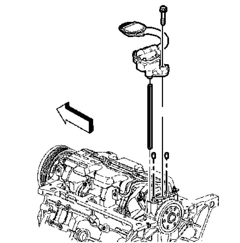

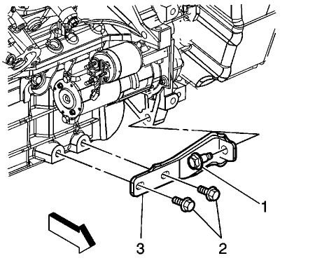

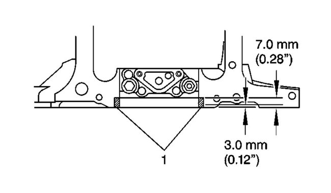

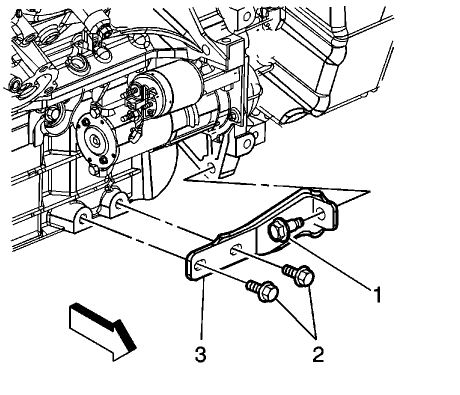

You disconnect the battery, then install an upper engine support bar. Now you go under the vehicle and remove the A/C compressor and move it out of the way, then the engine to transmission brace image 2 and then the starter. On the front drive version you remove the intermediate shaft and then drain the oil and filter. Then remove the bolts that secure the oil pan. With the pan off you can unbolt the pump, be sure to catch the pump drive shaft. Now you will want to pack the new pump with something like a light grease, Vaseline works good. That way the pump won't be started with dry gears and plates. Now you put the new pump in place and rotate the drive shaft until it seats in the drive inside the engine and in the pump socket. Torque the bolt to 30 ft lb. Now you can clean up the seal surface of the pan and reverse the process you used to remove it. Clean the block sealing surface and apply the new sealant and then reinstall the pan. For the bolts you install the flange bolts first, they get torqued to 18 ft lbs. Then you install the side bolts and torque those to 37 ft lb. Install a new oil filter. Now before you put everything back it is a good idea to just install the starter. and crank the engine over to be sure you get oil pressure. Once you are sure you can remove the starter and reinstall the brace, starter and AC compressor as well as the intermediate shaft.
