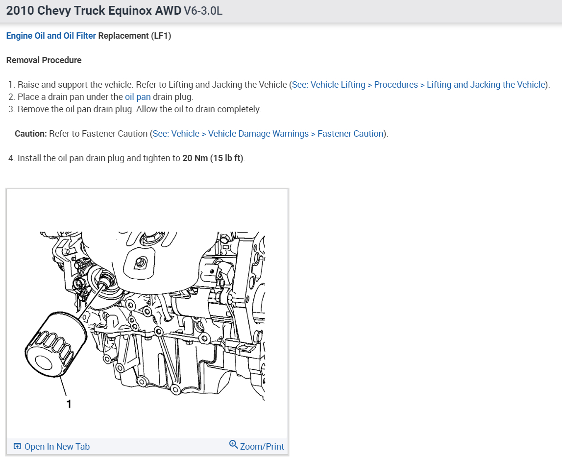

Bought my 2010 Equinox in late December. Just drove from VA to FL. Mileage is just over 3K now. In the past, I changed oil every 3K regardless of city or highway miles. 12K is the recommend mileage for he oil change. I was going to have the oil changed. At what mileage intervals do you suggest oil chnages for my 2010 Equinox. Thanks!
Jan 28, 2010 at 2:17 AM
LBCEPE

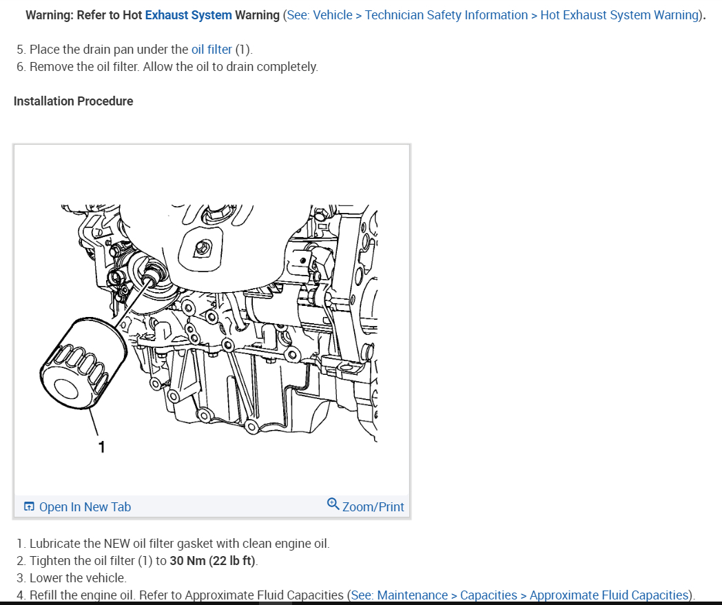

Stick wit the 3k you started with. But if you use full synth, you could up to 5-6k (castrol). Here are the steps to change the oil with diagrams below to show you on your car.
https://www.2carpros.com/articles/how-to-change-engine-oil-and-filter
