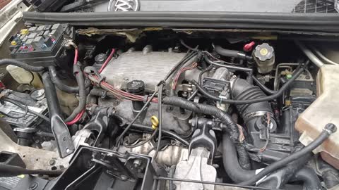

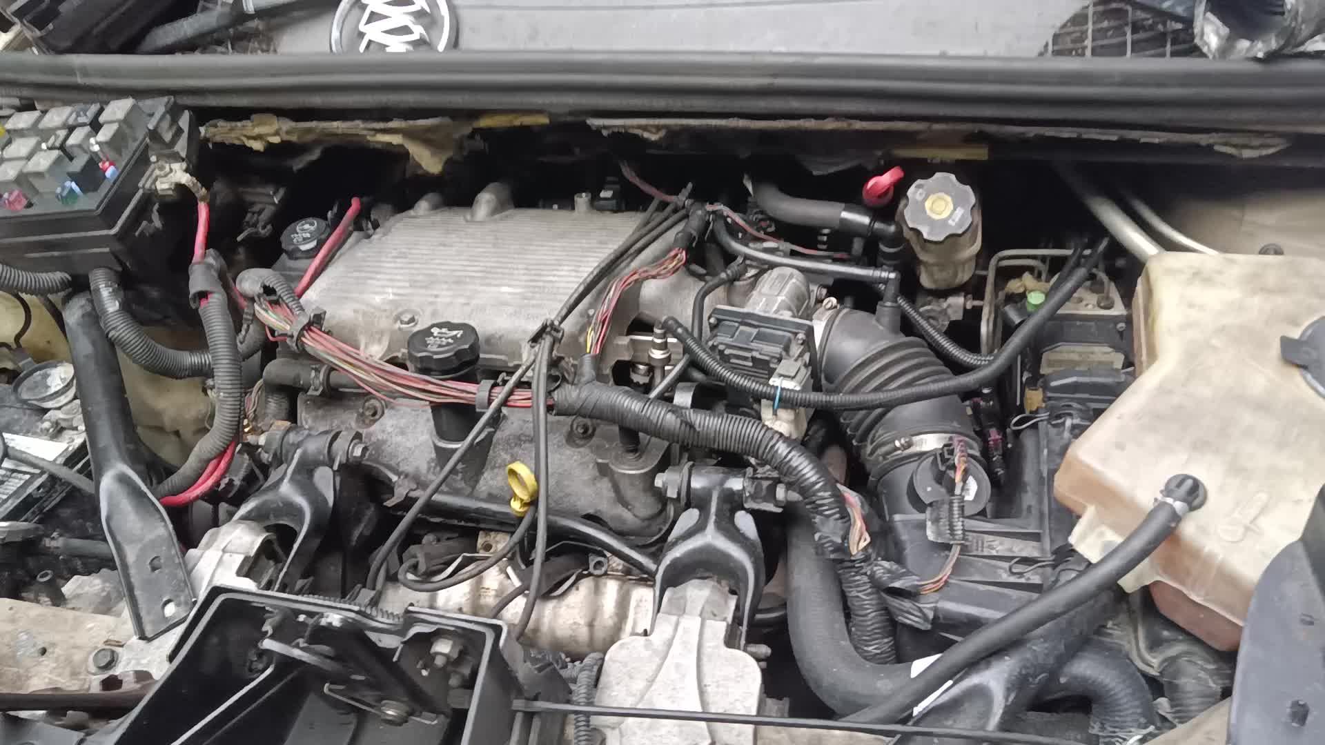

I had to replace the exhaust flange, so I had put in a flex line with a U-bolt to do a simple fix. I will look into it further to find out where the leak is coming from. What will make it not run on all cylinders? I will try to see if I can correct the timing. If you have the diagram for the timing marks, I am highly appreciative. Is the internal bearings something that's a difficult task?

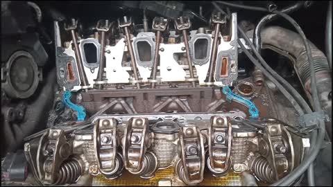

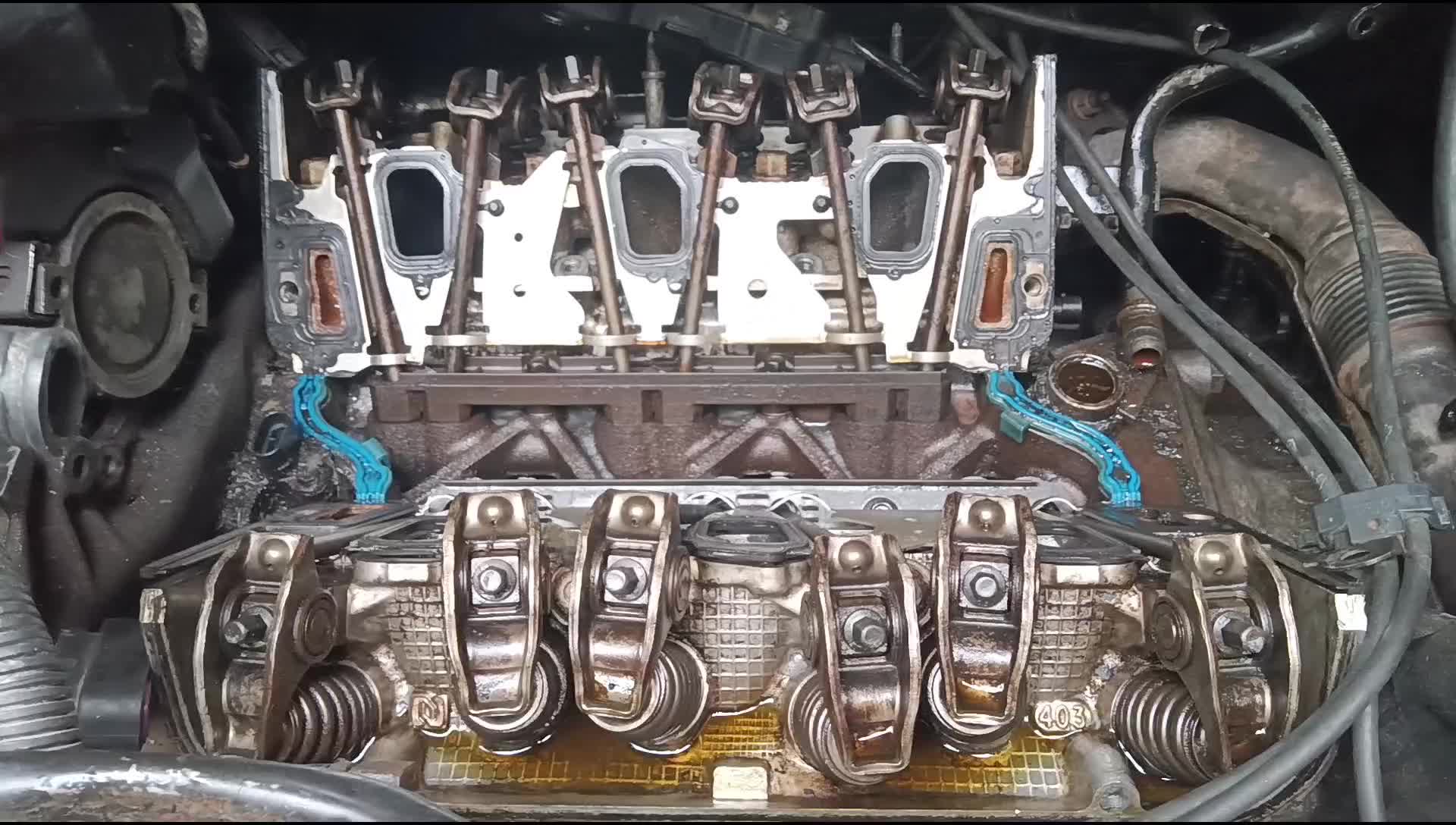

I have taken the intake, intake plenum and valve covers to confirm if the pushrods and rocker arms are moving some are moving and others aren't if you have an idea on if it could be the camshaft or a failed lifter, please let me know. Thank you in advance for your help.

If there is internal bearing damage, you are better off finding a replacement engine. As far as the valves are concerned, could you video what is happening and upload it for me to see? If the valves aren't moving,
As far as the lifters are not moving, the engine has hydraulic lifters. If you lost all oil pressure, that could be why you don't see movement.
I have a feeling either the oil pump has failed, or the pickup tube is clogged.

I did notice that. Are they stuck open? I ask because it sounds like we have no compression on one or more of the cylinders.
Also, if you look down into the engine valley, you should be able to see the lifters and the cam. Not too easily, but you can see them. Have your helper crank the engine and see if there is any movement on the lifters and if you can tell if the lobe was damaged on the camshaft.
