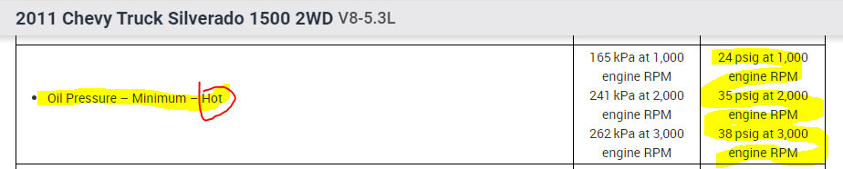

That is below the manufacturer's specifications. See pic below. Is this reading from the instrument cluster? Have you tried using a mechanical gauge to see if it is the same?
See pic below.
