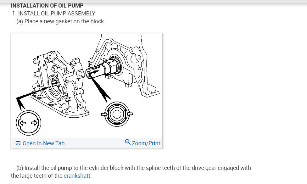

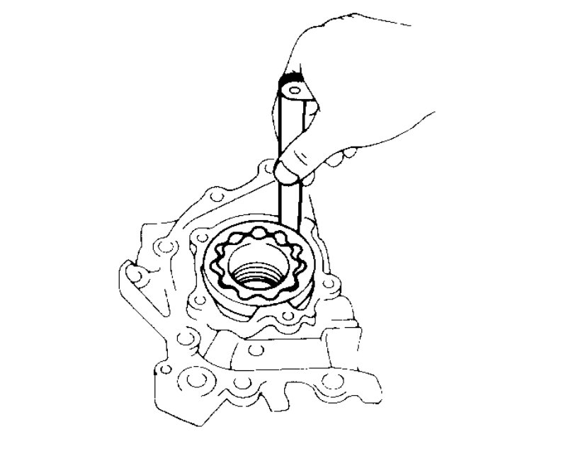

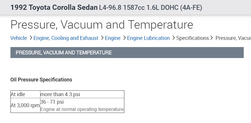

My problem is low oil light when vehicle is in normal operating temperature on idle.Then it goes away as I put foot on the gas pedal.What would cause problem? I've recently change crankshaft,main bearings and rod bearings,new oil pump.

Hi guys, once again what if I could bought other oil pump and big ends maybe it could solve the low oil pressure problem?

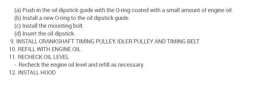

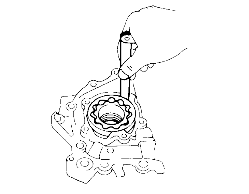

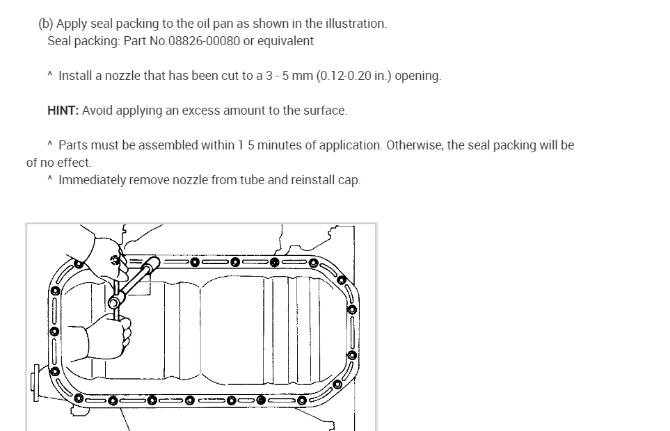

SCGRANTURISMO
  • 4,897 POSTS

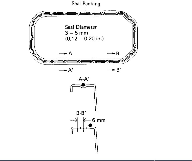

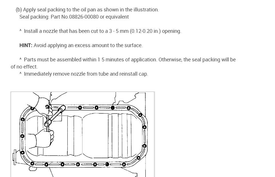

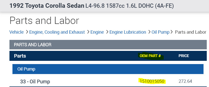

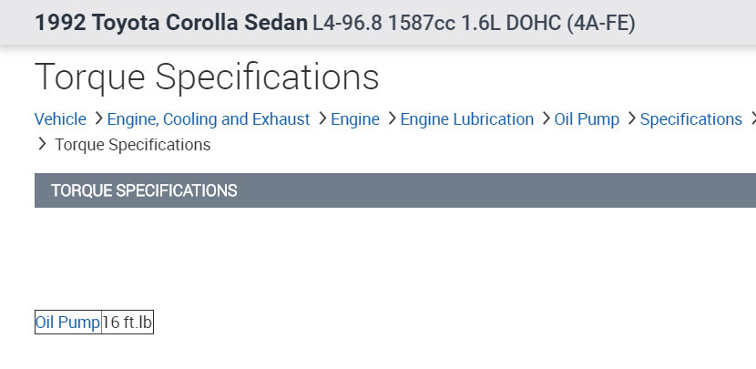

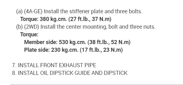

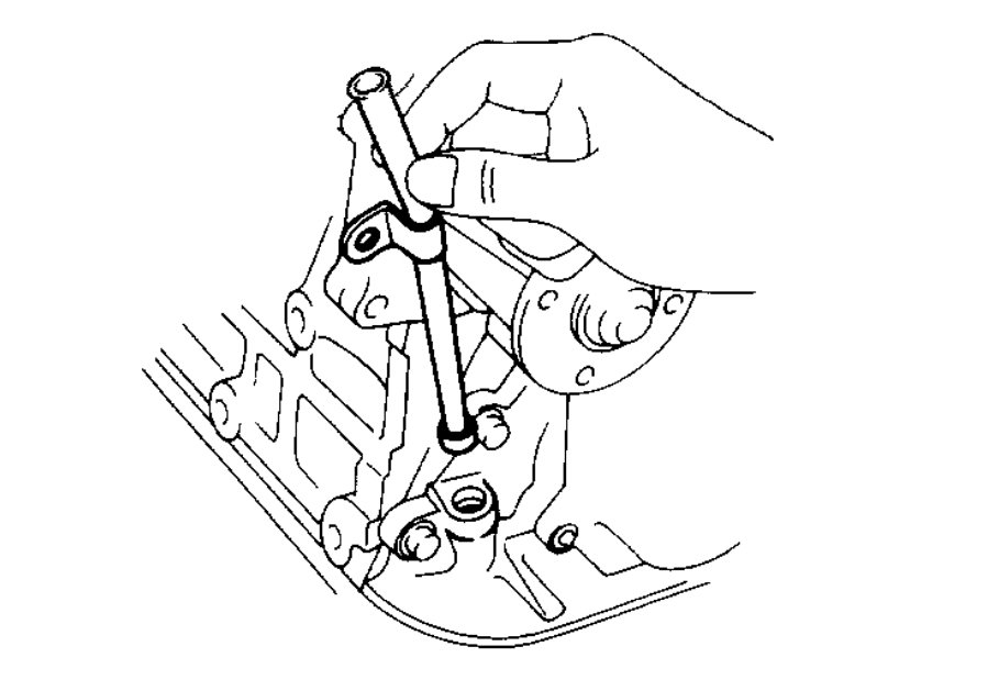

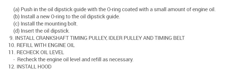

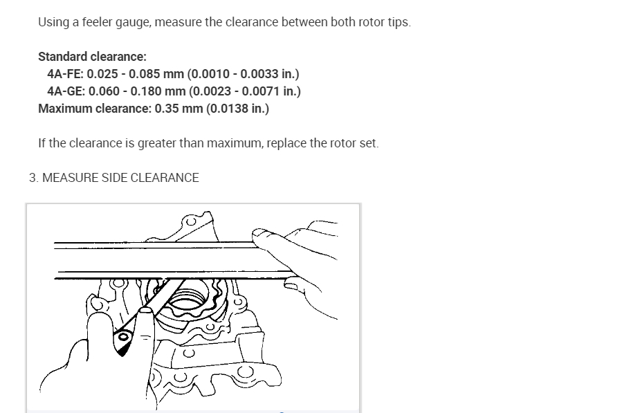

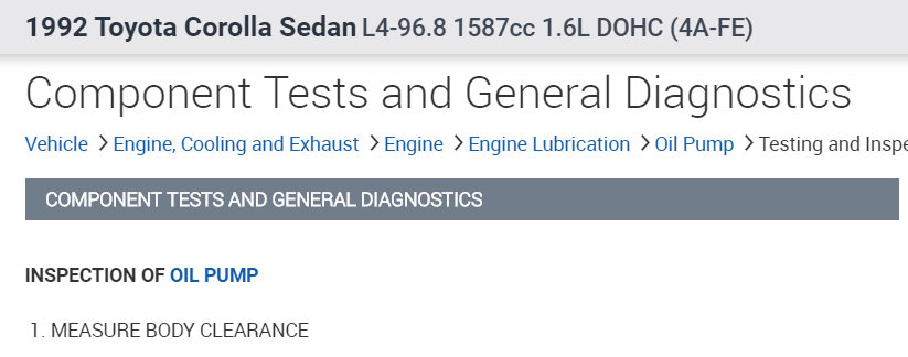

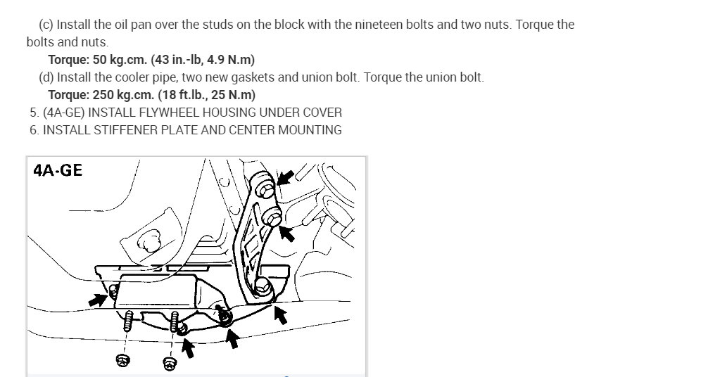

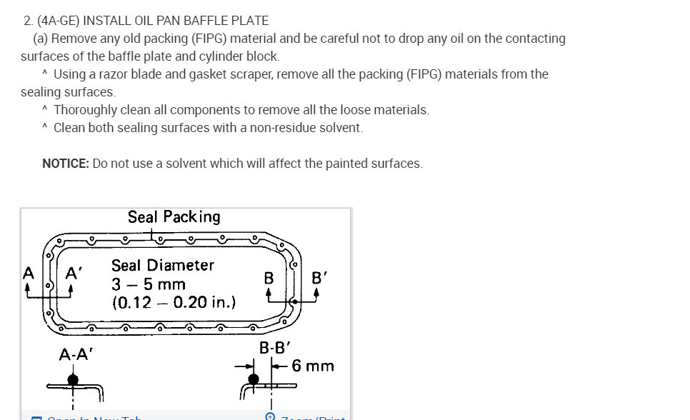

Hello again,

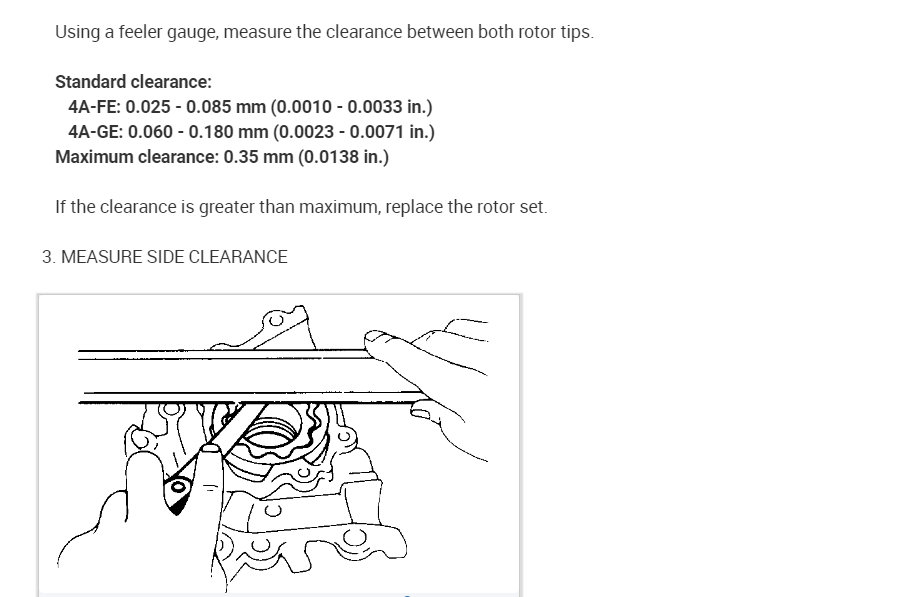

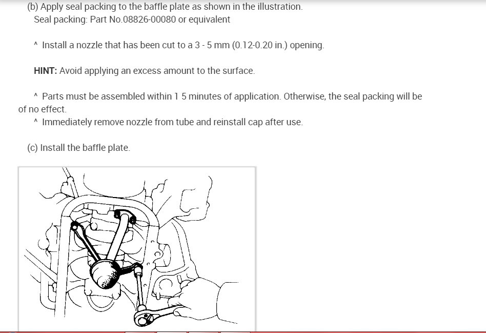

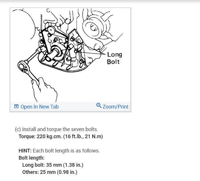

Okay, that's good. In the diagrams down below I have included the Original Equipment Manufacturer [OEM] part number, as well a specs, and a guide on the proper way to install your vehicle's oil pump. Please double check that the correct part was purchased and that the installation went according to the guide and get back to us with what you find out, please.
Thanks,
Alex
2CarPros
