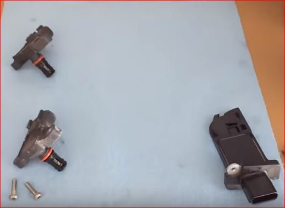

Next, remove each MAP sensor, location attached. Then clean each of the sensors with Electronic Safe spray cleaner. Do not use brake clean or shop cleaner. This has a chlorine in it that will damage your sensor. Electronic safe cleaner can be purchased at any parts store.
Once these sensors are cleaned, reinstall them in the engine and reconnect the battery and see if the idle has smoothed out.

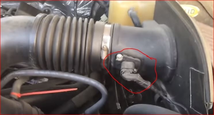

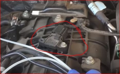

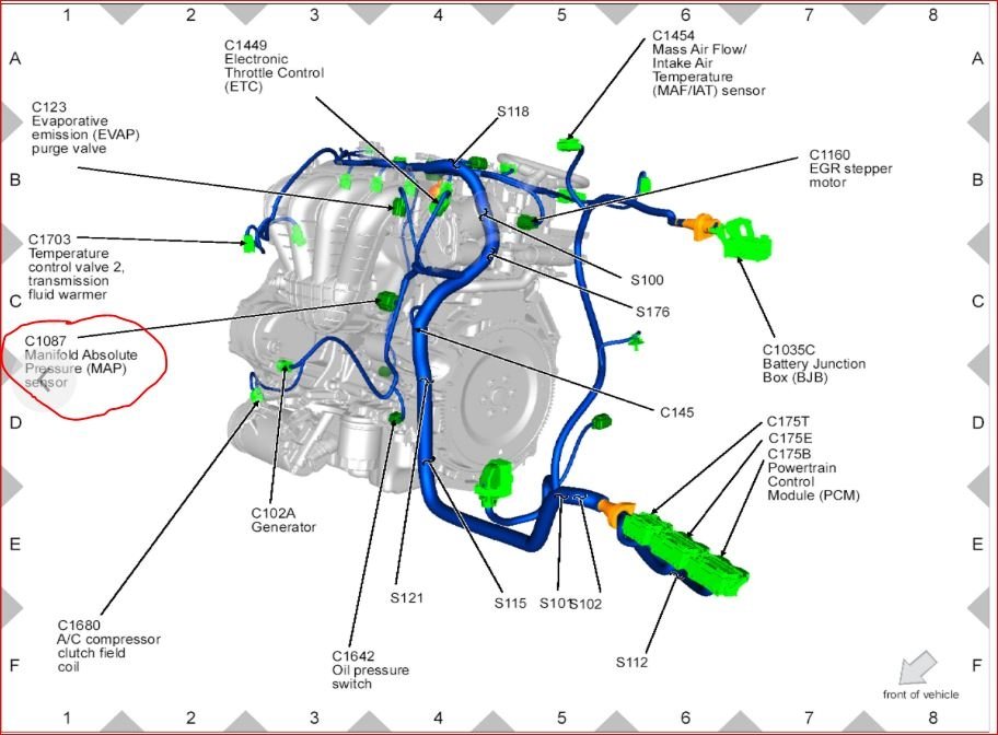

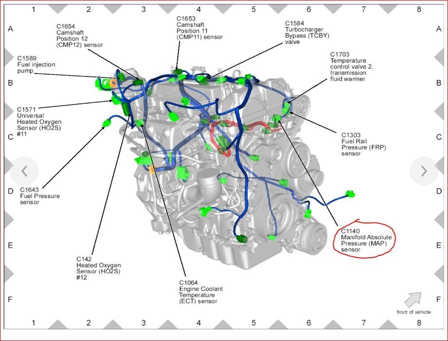

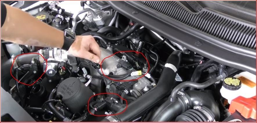

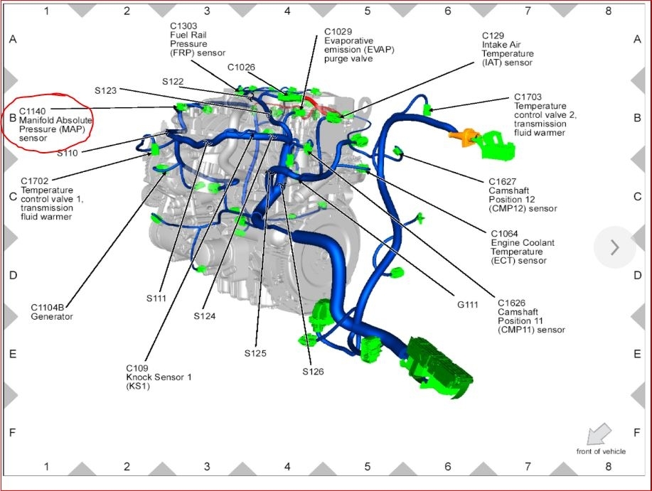

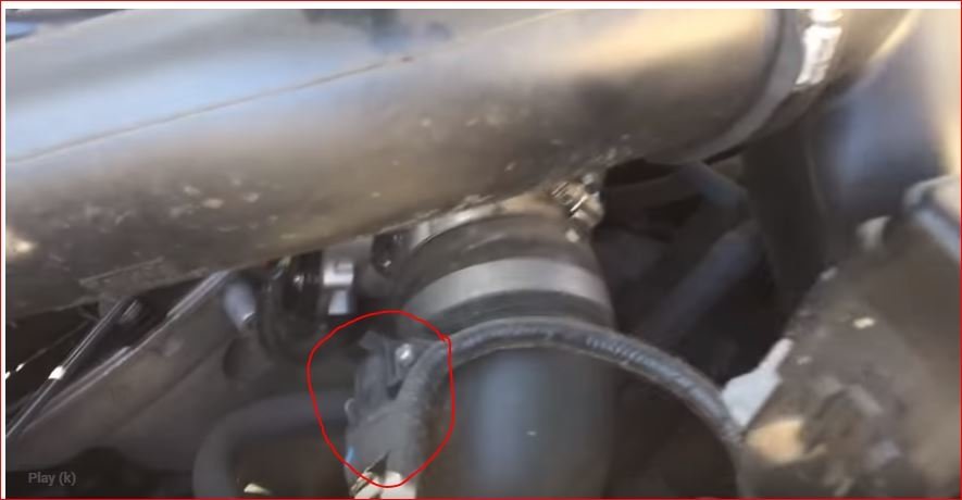

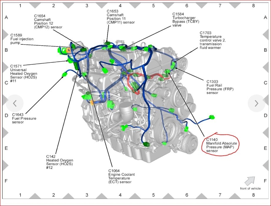

Okay thank you! I assumed it could be a problem with the air fuel mixture. Could you give me a few more details on finding the sensors? I see the images you provided and want to make sure I find the correct sensors and i will follow your steps
May 25, 2019 at 1:49 AM
These are the best pictures I could find. These are not all out of your 2.0L but they are out of similar engines so it may look a little different but they are in these general areas.
Please tell me if you can't find them and I will see if I can get more detail for your specific engine.
May 25, 2019 at 6:46 AM
