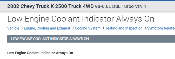

Replaced the coolant reservoir, and the light still won't turn off. I recently replaced the block heater as well. Also had the fuel injectors were replaced due to 3 of them cracking and forcing all the oil out of the engine and replacing it with diesel. Truck runs fine, and there are no leaks other than a small power steering leak.
Mar 5, 2023 at 3:03 AM
  • 110,244 POSTS

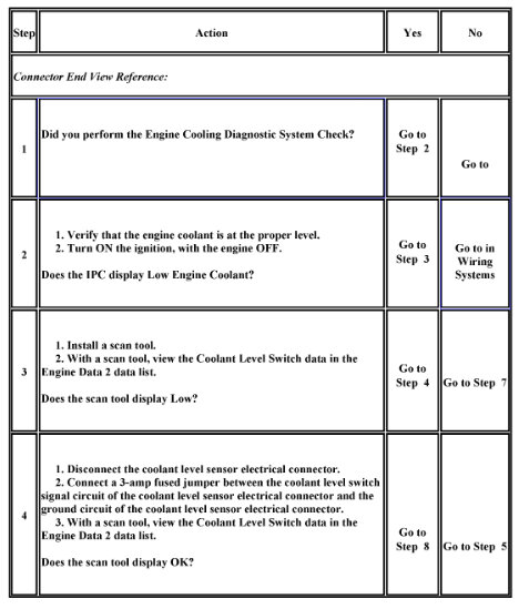

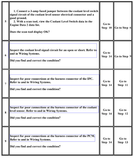

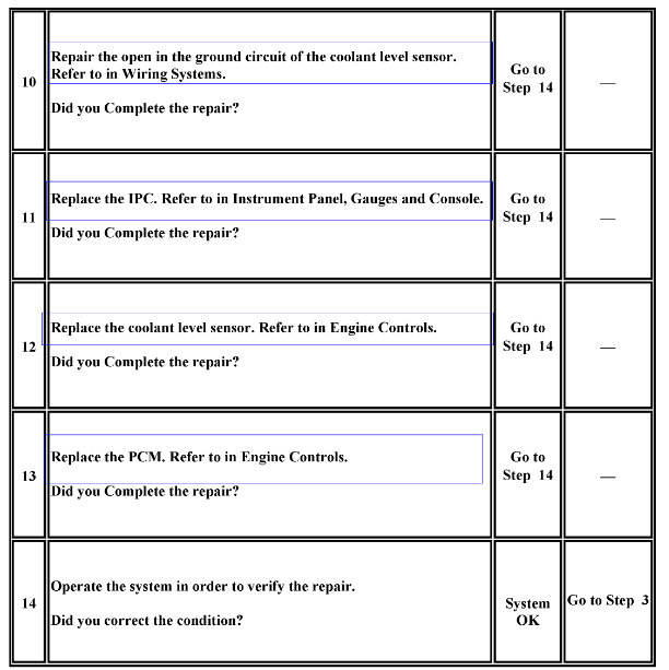

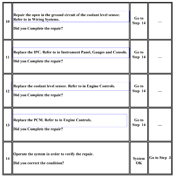

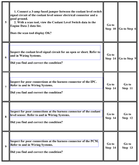

There is a chance we lost ground or sensor is faulty. Did you also replace the sensor?
Interestingly, I found a technical service bulletin (TSB) related to this issue, so it must be a common problem.
If you look below, I attached the diagnostics from the TSB. Take a look through them and let me know if you are comfortable performing them.
