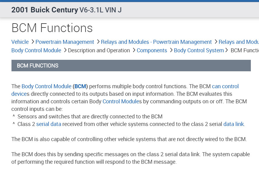

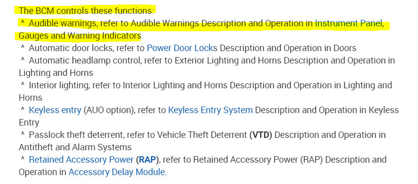

Got one more question. Did whatever the mechanic unplug to make the low coolant light not go off effect the other lights ( brake, engine, oil etc)? And, do you think it will be safe for now? Looked up the BCM and it seems to be electrical and rather costly to replace. Just fretting I guess. Thank you,
Jul 29, 2019 at 1:12 PM
SCGRANTURISMO
  • 4,897 POSTS
Hello again,
The mechanic probably unplugged the Coolant Level Sensor, which is just an electrical plug that plugs into the reservoir tank to send the signal to the gauge. In the diagrams down below I have included a description of what the Body Control Module (BCM) does, as well as an estimate of the costs of repairs.(keep in mind that the part is Original Equipment Manufacturer (OEM) which is a little more expensive, and the labor rate you need to times that by whatever shop rate is per hour where you live). Please look over the guides and keep us informed as to how things progress.
