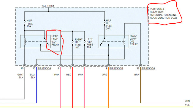

I've had this issue since owning the car. It's the hatchback or Rio5 Canadian model. I checked and changed the bulbs, H1 bulbs, still nothing. All the headlamp fuses are fine too.
What else is there I can check?
Feb 13, 2020 at 7:44 AM
  • 110,251 POSTS
Is there power at the fuses? Next, there is a low beam relay in the under hood distribution box. If I recall, the relay for the low beam is integral and I don't believe it is replaceable itself.
Take a look below. I cut a portion of the schematic for you to see what I am referring to.
If possible, check that as well. Also, confirm there is power to the fuses related to the low beam.
If these things check good, we will need to check the switch as well.
Let me know,
