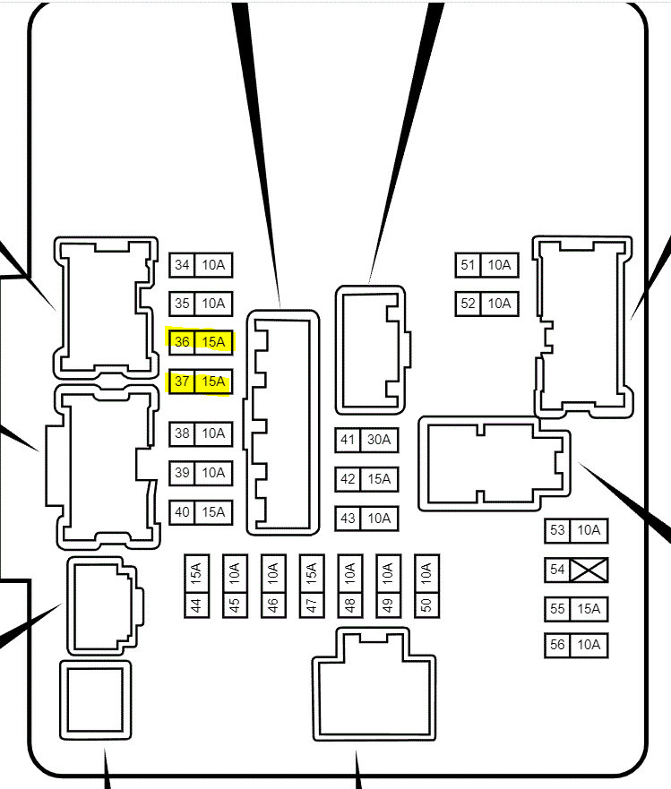

All of my lights are working except for my low beam headlights. I need to locate the fuse to see if that is the problem. The owner's manual is worthless.

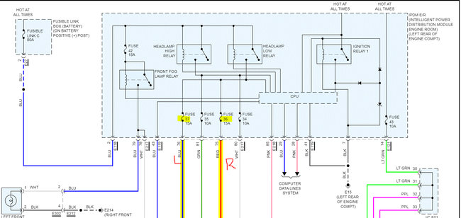

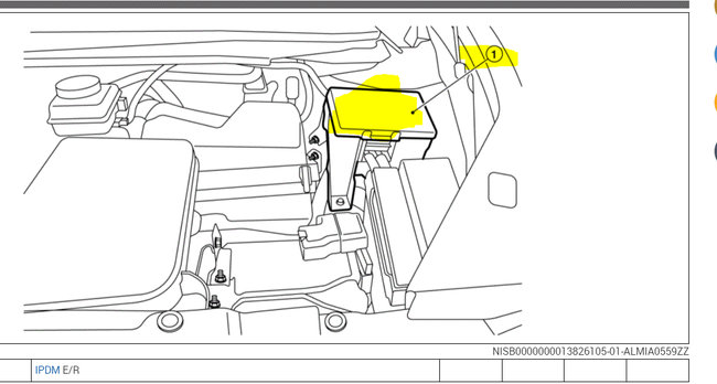

I understand why you are having trouble. LOL, it took me 20 minutes to figure it out in the manuals.
Regardless, unless you have LED headlamps, it is a totally different setup and doesn't have fuses as shown.
Pic 1 is what got me started, the wiring schematic. Pic 2 shows the location of the IPDM under the hood, and pic 3 shows the fuses. Note: Fuses 34 and 35 are high beams left and right.
When you check the fuses, even if they appear good, confirm there is power to them. Here is a link you may find helpful:
I hope this helps. Let me know if you have other questions. Also, let me know if this takes care of the problem.
