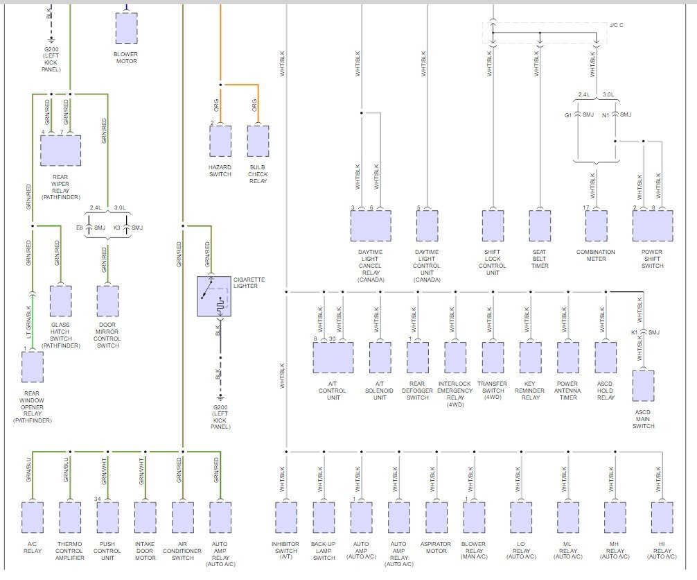

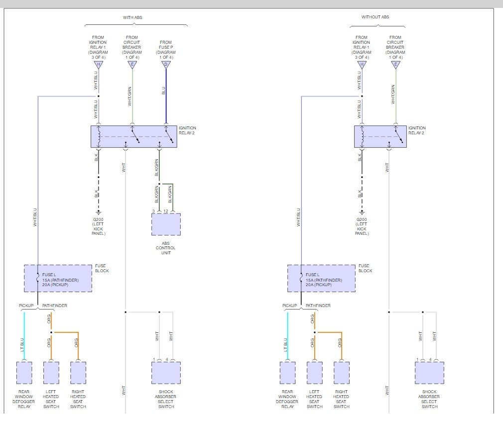

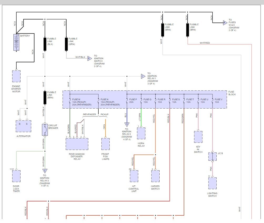

Every since I replaced the main relay it has caused my car to cut out, lose power, the heater does not blow and the windows will not open. I still have the problem of it clicking. if I keep trying it will finally turnover and starts. what could be the cause of this?

Do not think so. The main relay usually has a bunch of extra parts in it to control multiple items while the inhibit relay is nothing but a simple relay.

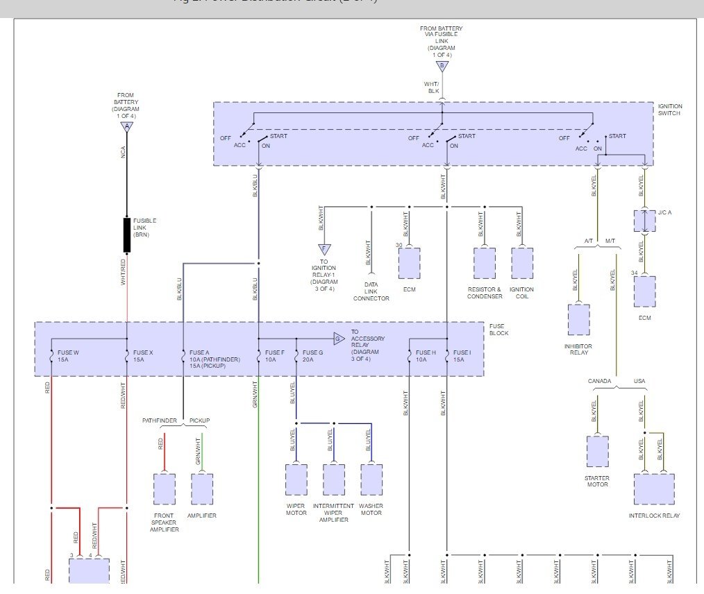

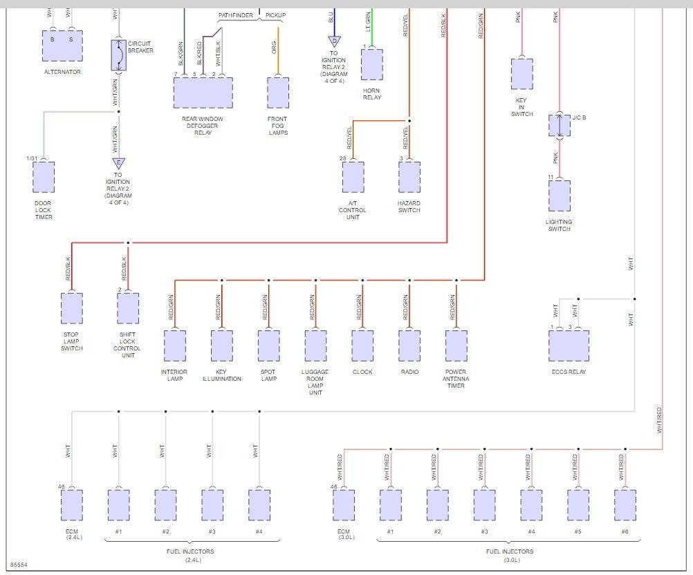

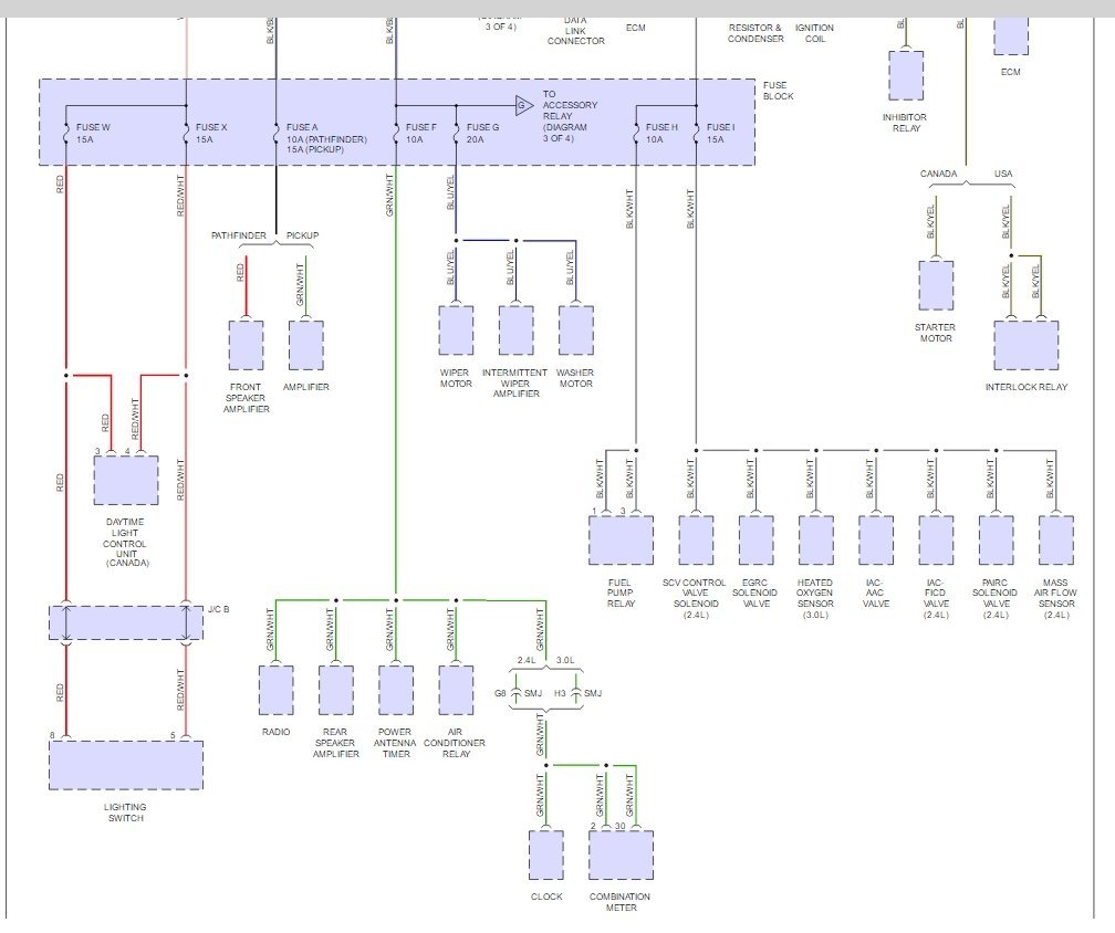

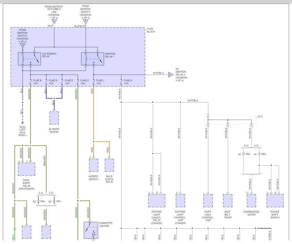

It sounds like you should do a load test on the battery to start. Then follow this wiring diagram and run some tests to see were you are losing the power at.
and
Please run some tests and get back to us so we can continue helping you.
