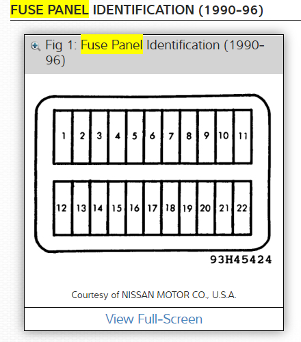

I can't figure out which fuse covers them.
1996 NISSAN PATHFINDER
153,083 MILES • 6 CYL • 4WD • AUTOMATIC
KJD3

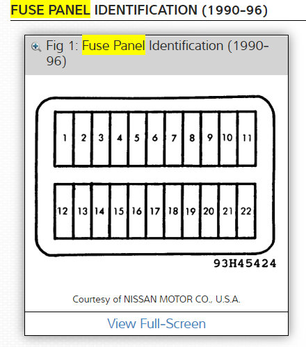

Hey, The dash lights that come on when the head lights are turned on went off. I can't see the speedometer or rpm dials. I can't figure out which fuse covers them.
Feb 25, 2010 at 7:34 AM
BLUELIGHTNIN6
  • 16,542 POSTS

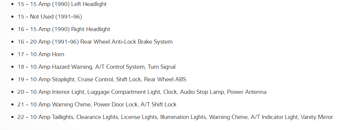

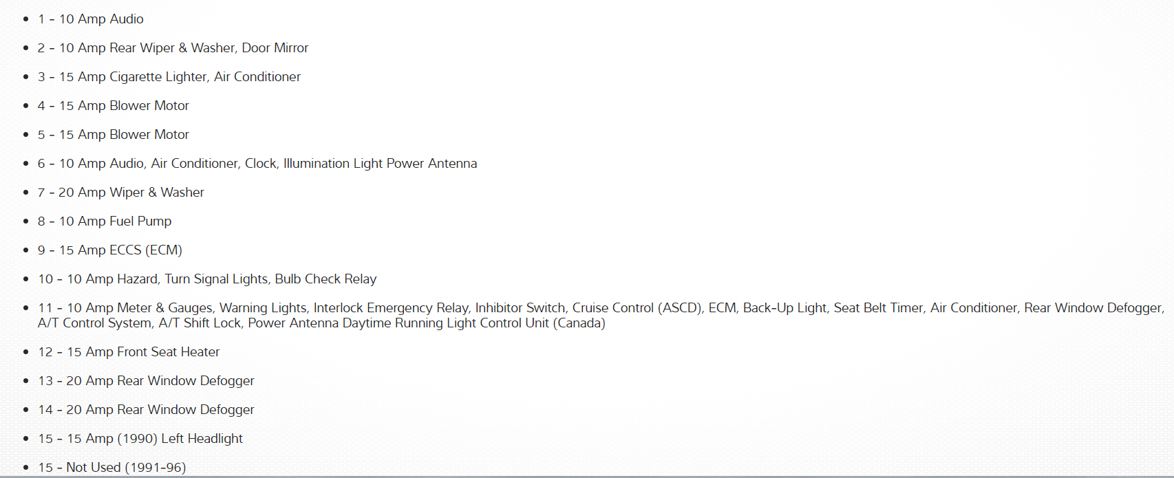

check fuse #6 (10 amp) and #22 (10 amp) in fuse panel. Most likely it is a faulty bulb behind the gauge cluster though.
Here is a guide and the fuse panels below.
Feb 25, 2010 at 9:10 AM
