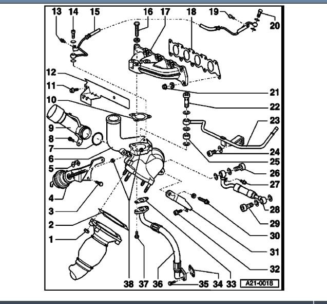

A few months ago I was told that my turbo was leaking (whatever that means) but as long as my car wasn't smoking it was fine for the time being. However, last night I was in first gear and attempting to get up a slightly steep hill, I heard a pop and then a bad smell started. It wasnt until i was all the way up the hill that my car started smoking pretty bad. Once turned off it cooled down a bit but was still smoking a bit. I haven't driven it since.

Good afternoon,
What color was the smoke?
The turbo may have failed. Does the car have less power?

Turbocharger system components, removing & installing
Part I

6. Turbocharger
Checking charge air pressure control, refer to Testing and Inspection - Procedures
Charge air pressure control valve and charge air pressure control valve vacuum unit are components of the turbocharger and cannot be replaced individually.

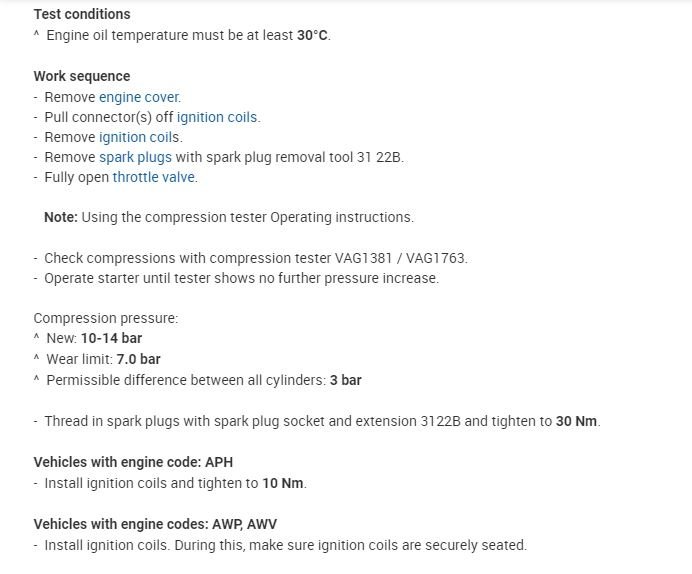

The smoke was white I believe.
Mar 4, 2020 at 7:00 AM
If it was white, that would indicate you are burning coolant which means a possible head gasket.
I would do a compression test to see if the pressure drops indicating a leak from the head.
If it was blue, it would zero in on the turbo.
