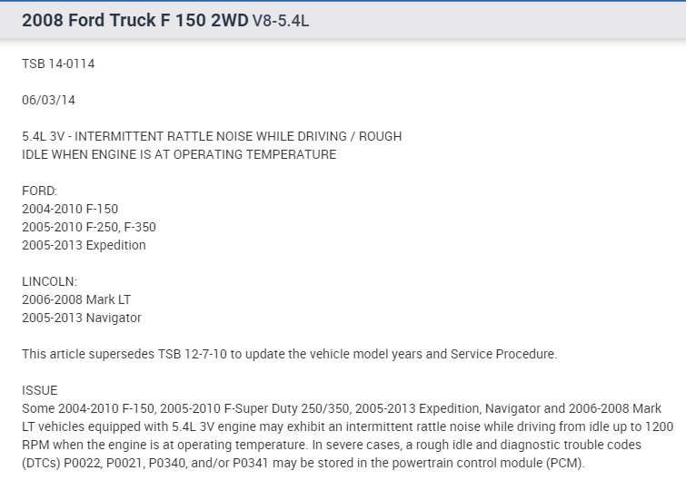

I'm hoping someone can help me out here. I've been reading through all sorts of forums and I'm not sure if this is the same as what everybody is describing. I have the truck listed above Super Crew with a 5.4 liter 3 valve engine. The truck has 68,000 miles on it and it's still under extended warranty from Ford.
So here's the situation. For about the past 10,000 to 15,000 miles or two years. I've had this noise and is getting progressively worse. When the air conditioning is on it is much much worse. It basically sounds like a diesel firing up it's driving me crazy. Along with that I'm getting a smell of oil burning so I cannot run my air conditioning with the fresh air vent, only on recirculate. They have been several instances also where I've had loss of power when I go to push down on the throttle to the point I almost got in an accident before. The engine seems excessively hot but when I hook up the OBD2 reader it is showing the coolant temperature at 196 -205 degrees. I live in Las Vegas.
Here is a video I shot tonight after doing about 35 minutes of driving around my neighborhood. Outside air was 89 degrees that evening.
https://youtu.be/El0qVKXqtKY.
The plugs were changed at 50,000 miles. All fluids, filters, major services were done at 55,000 miles. First 7 years oil changes we're done every 5,000 miles by Ford using full synthetic. After that I did it or had it done every 5,000 still with full synthetic.

The TSB I found were 14-0114 and I believe it's predecessor 12-7-10. I had also asked the service manager if they pull the plug on any of the cylinders to check for any kind of fouling or carbon buildup oh, he indicated now. I also asked if he follows any of the procedures in the mentioned technical service bulletins and he had no response.

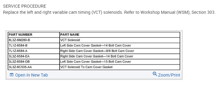

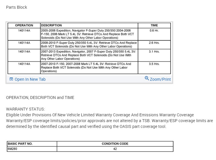

Hello again.
I've found this Ford TSB dated 6/3/2014 I've attached three pictures below describing the condition. Hope this helps and thanks again for using 2CarPros.

Yes, that is the same one that I had found. They seem to be avoiding that TSB for some reason. They will not confirm or deny if they've actually ran the testing for it.

Sounds like they didn't... The majority of auto techs that work at dealerships are paid commission. Recall/warranty work is paid less than half of a normal ticket. Techs given recall/warranty either use short cuts to save time or avoid it altogether.. Your issue is pretty involved (10 hours). so it sounds like they are just passing the buck and shining you on.

Yes, It makes me mad when this crap happens because it gives us legit techs a bad rap. This September marks my 30 years as a certified tech (started really young) and I've always stayed away from a commission job for that reason. Only hourly for me. Also, don't even get me started when idiot techs/service writers see a single women come through the doors. Grrr ! As far as your situation it is most definitely in the VCT (variable cam timing) system.I just think whatever Ford dealer you went to gave you a raw deal.Hope this helps and again thanks for using 2CarPros.
