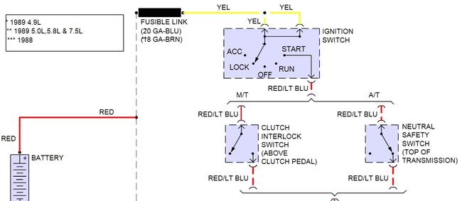

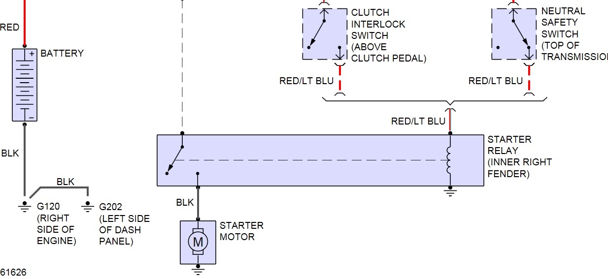

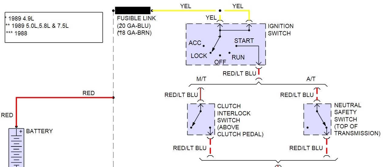

LDUNCAN852
  • 1989 FORD F-150
  • 4.9L
  • 6 CYL
  • RWD
  • MANUAL
  • 175,000 MILES
To start off I was driving the truck around every day for about a month. The starter went out. So I parked it. Decided to roll it off to move it. Ran fine. Let it sit for about 2 weeks and rolled it off again it is making a horrible grinding noise around the starter/flywheel I went and got a new starter and put it on. It will not start with the key for some reason acts like the battery is weak but it's not. It will start by rolling off but still makes the grinding noise? I need help asap. Thanks for any advice.
Monday, July 13th, 2020 AT 1:53 PM (Merged)
JDL
  • 16,098 POSTS
I would want to check starter teeth and flywheel teeth, to see if they engage properly. Do you have a flywheel inspection cover that you can remove? When you had the old starter out, could you check the flywheel teeth?
Give me a second and I'll post starter wiring circuit. You have to be sure the battery has a full charge and the battery connections are good. Do your other electricals work ok?
JDL
  • 16,098 POSTS
Here is starter wiring. Any testing at the starter, make sure tranny is out of gear, and the parking brake is set. Block the wheels.
