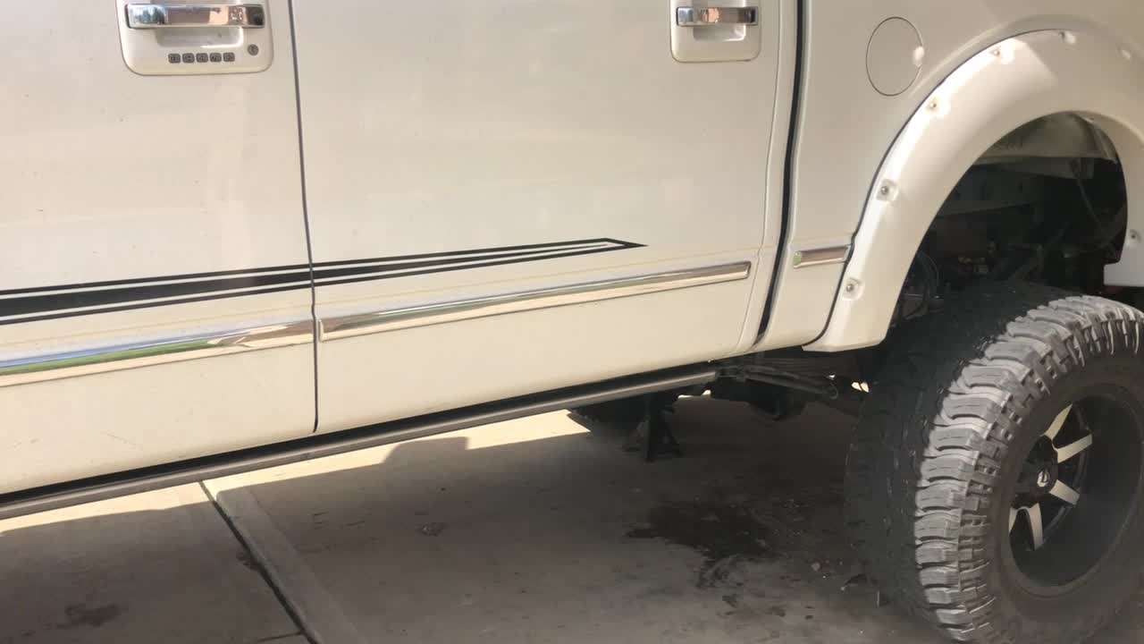

By seeing the transmission mount looks like it is going up and down a lot? I can push up and down on transmission easy.

Yikes! Hard to really tell exactly where the noise is from the video but wow! I wish I could get under my Explorer that easy! So when you are under there, where exactly does that loud banging sound come from? The front, middle, or rear of the transmission? Are the U-joints okay as well? Also, can you give me some history of perhaps what happened before this? Were you out mudding or anything?

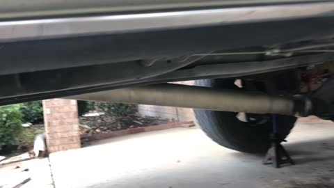

I did everything you just mentioned and it is not as bad, but there is something still going on back there. I am letting the battery reset now to clear codes and start over. It is hard to get anyone to work on this truck due to the lift. Thanks for everything!

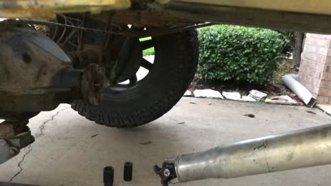

Update : After completing all above steps I decided to air it out to see if it would clear up ? No can do. At 70 mph it was beating underneath so bad I could not hear. Frustration got the best of me I floored it and BOOM is all I heard. Rear u-joints blew out which slung driveshaft out the rear the truck which sounded like an explosion. Perfect example of what not to do! So coasted 300 yards to leave it in a HEB parking lot. I walked back the 300 yards to find the driveshaft on the shoulder of the road split open with water still coming out the center of the driveshaft with white foam!

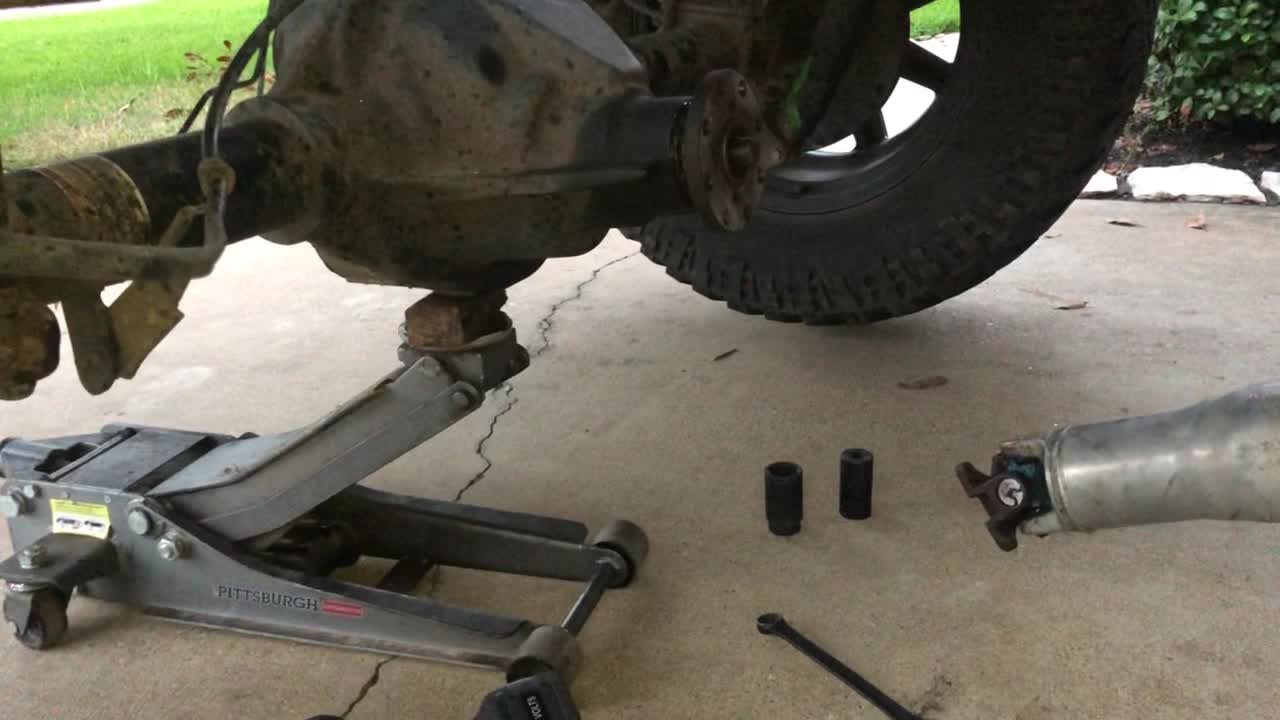

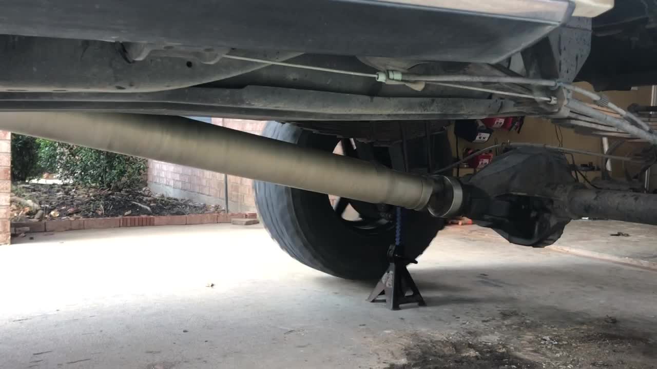

Update: know where the "clunk" is coming from. Changed the driveshaft, u-joints, plugs and coils. Still clunking not as bad though. So took driveshaft off and jacked in the air and here we have it, in the rear axle.
Nov 10, 2018 at 7:55 AM
JONNYB1963
  • 263 POSTS
Oh definitely! Seeing as this vehicle was under water as you said. Most likely water got into the differential housing. I would remove the cover and axle shafts then inspect the whole rear axle assembly from wheel to wheel. Replace all bearings and seals etc. For that matter though it might be cheaper to buy a used unit. Make sure the gear ratio is the same if you do.

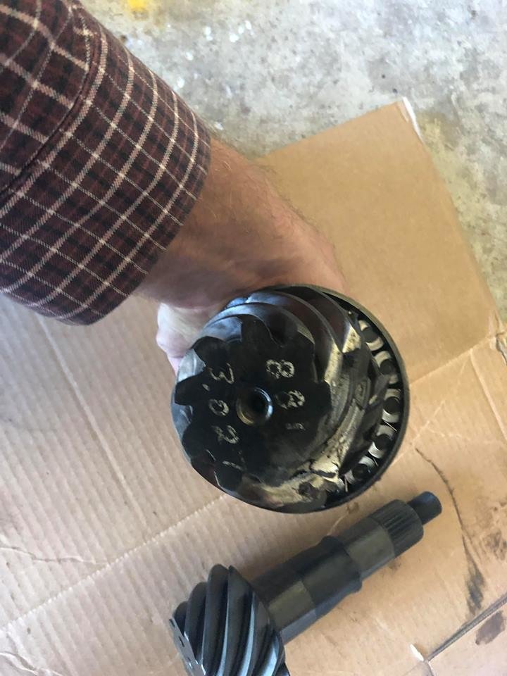

DERAIL HENTRICH
  • 12 POSTS

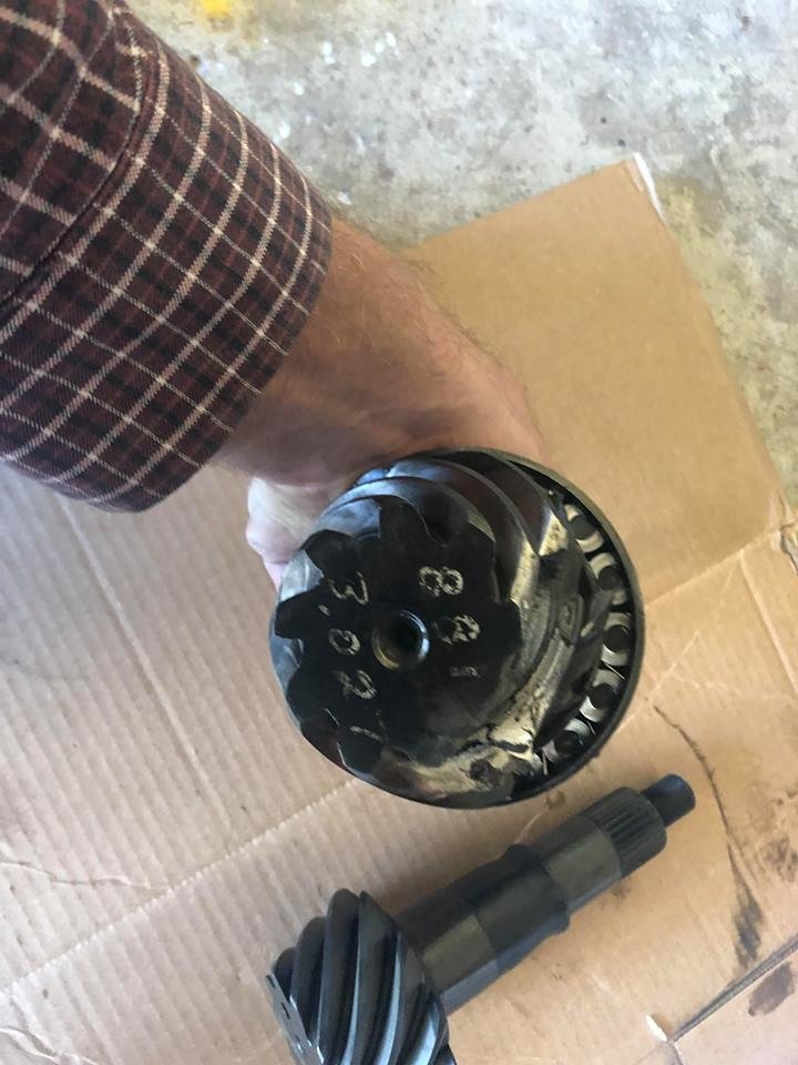

Huge final results: 456 gears ring and pinion was broke. Replaced the 456 with 410 drives like a dream. Did all the work myself. See pictures.
Nov 16, 2018 at 11:53 PM
  • 55,433 POSTS
Nice! Yep that is what it sounded like. Nice work doing the job yourself. Can I ask how much the gears cost?

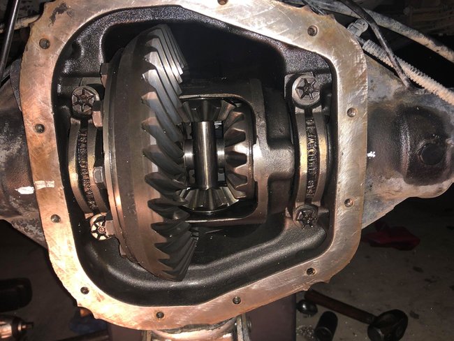

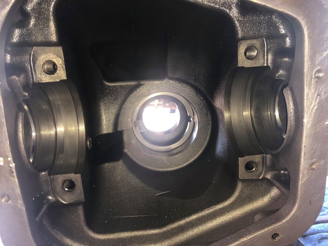

DERAIL HENTRICH
  • 12 POSTS

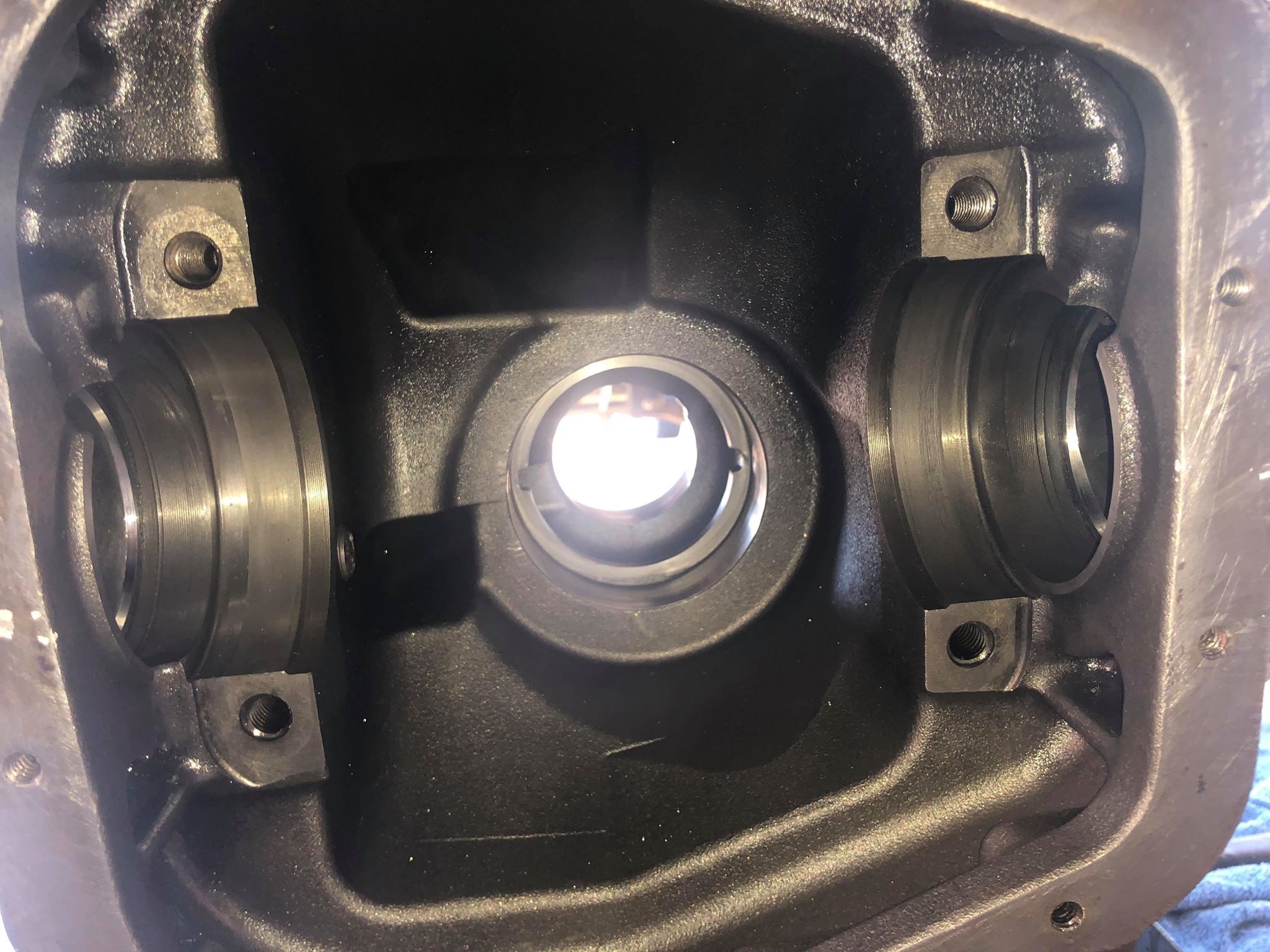

Well I plan on it with this Ford I am sure I will. Here is the last straw where I finally had to crack into the rear differential case! I had a time with the shims and that back lash, but I got it and it is running like new! Like the 4:10 gears a lot too.
